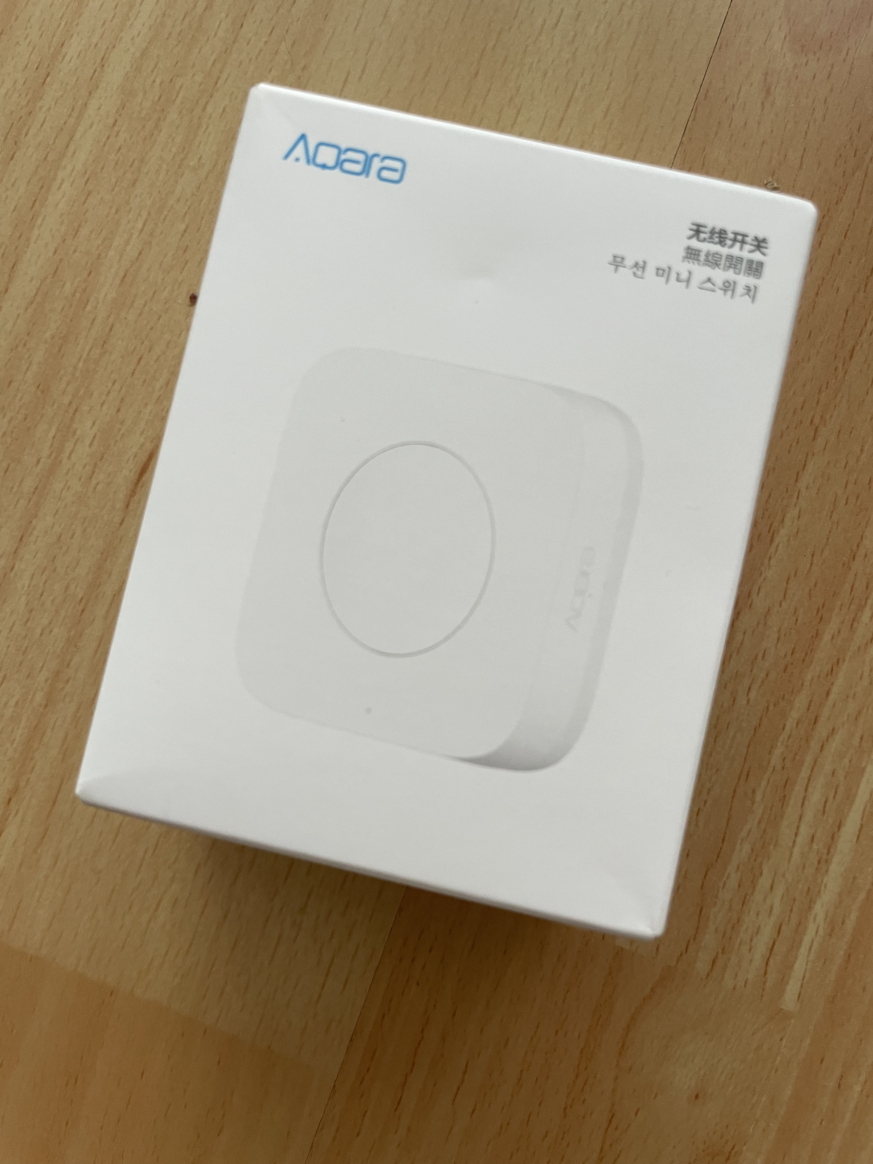

Hi. I got several Mini Switch :

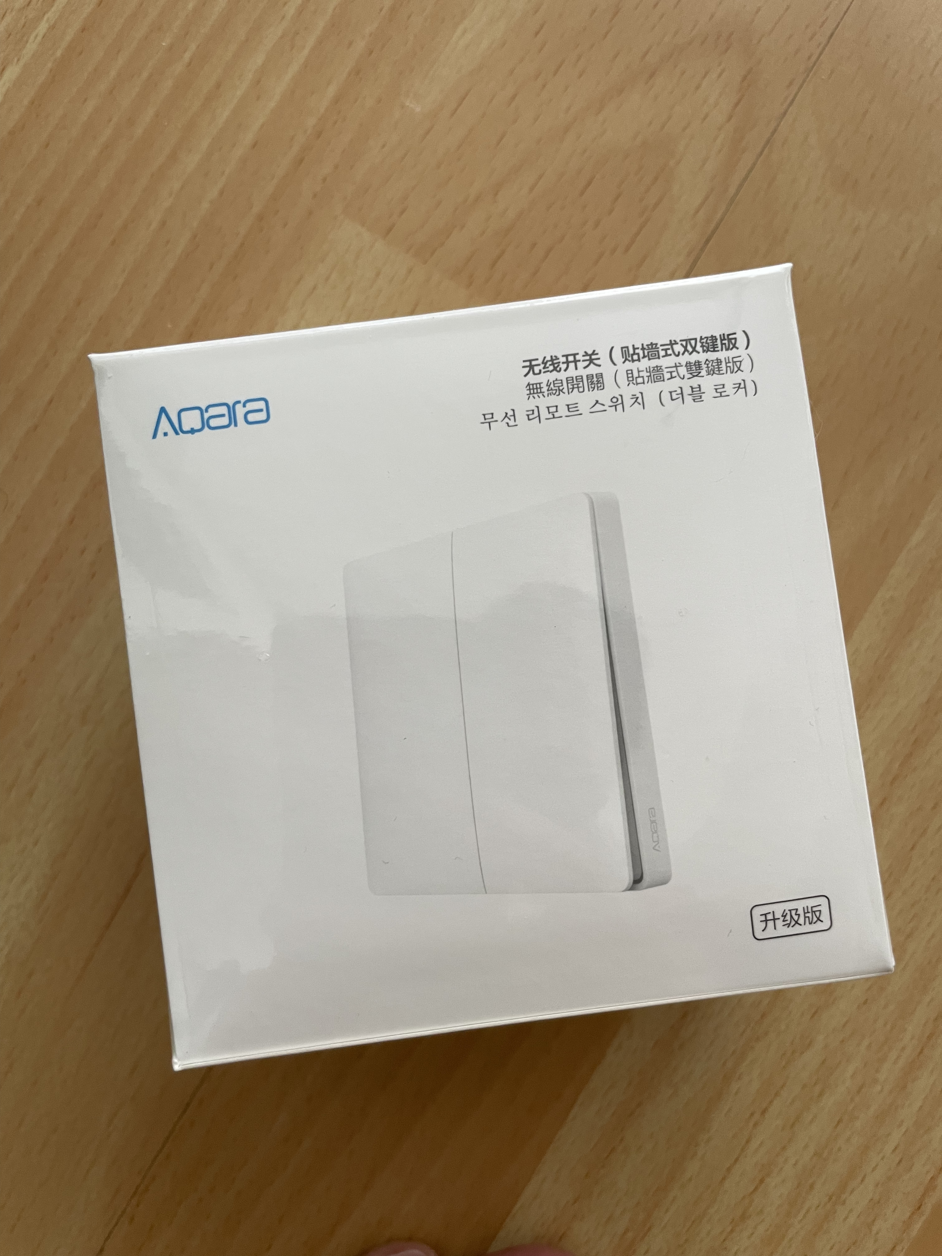

…And this ones (1 gang and 2 gang) :
All my Aqara Devices (including Bulbs, Thermometers, Switches, etc…) except the cameras work directly in Home Assistant without Hub. All in ZigBee, (with a ConbeeII and Deconz previously), now with a SLZB-SM06M and ZHA directly. :+1:
Thanks for the detailed information what is the model number of the mini switch if you dont mind me asking. My Chinese is lacking!
:joy:. It is the standard Aqara Mini Switch (T1, I think (but I’m not sure)). This one : https://www.aqara.com/eu/product/wireless-mini-switch/
