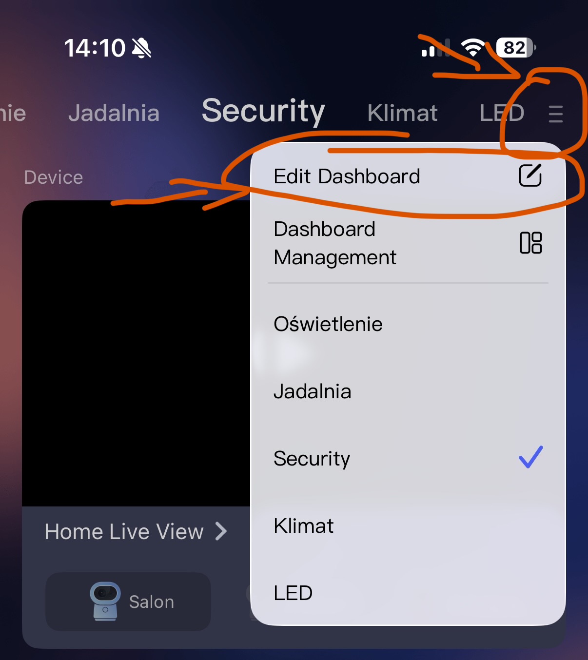

To configure those notifications - open the Aqara app, tap the hamburger icon and “Edit Dashboard”

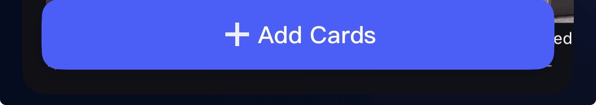

Then tap “Add cards”

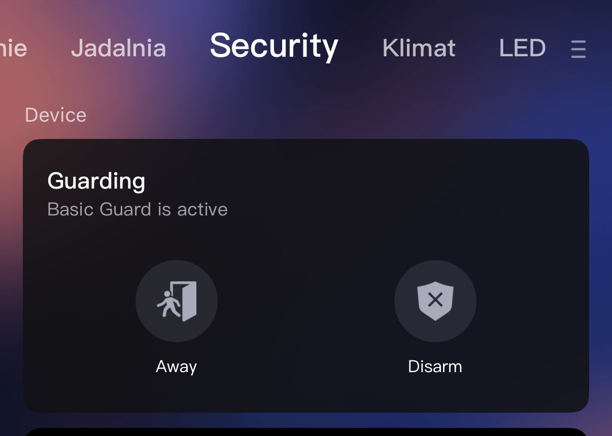

Find the “Alert system” widget and add it to the dashboard.

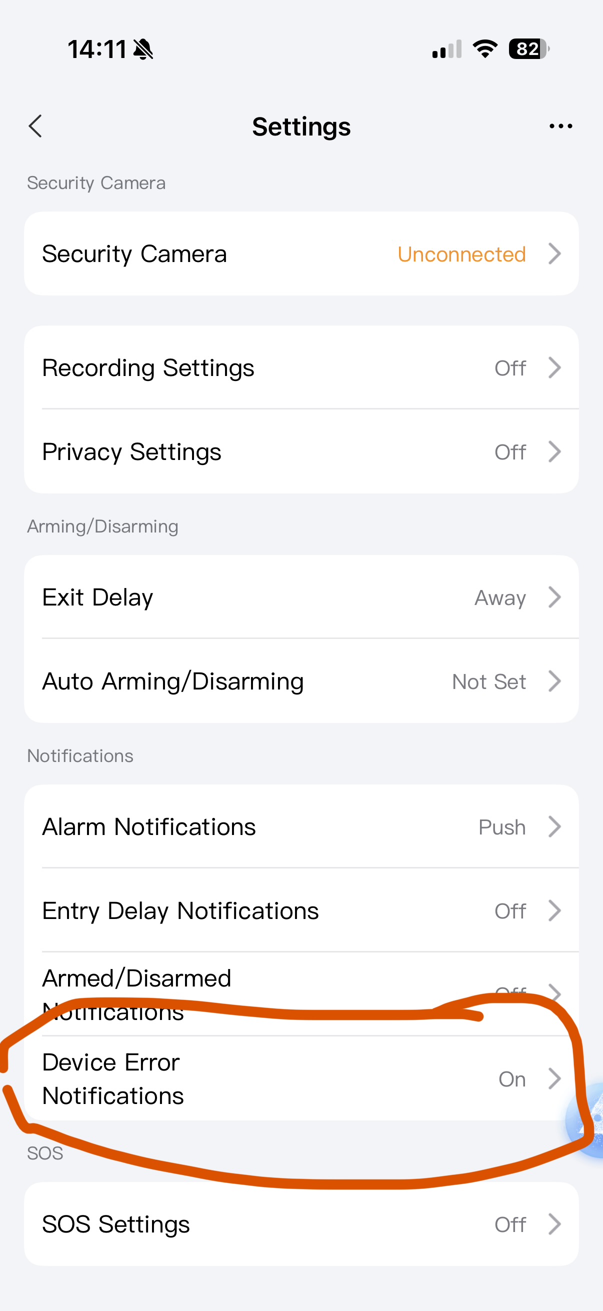

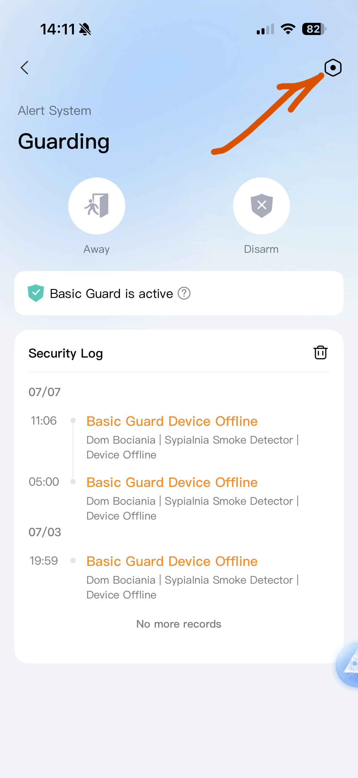

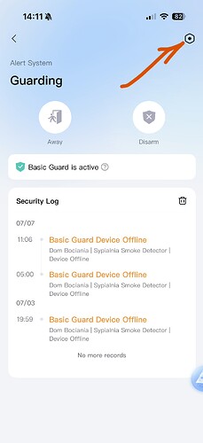

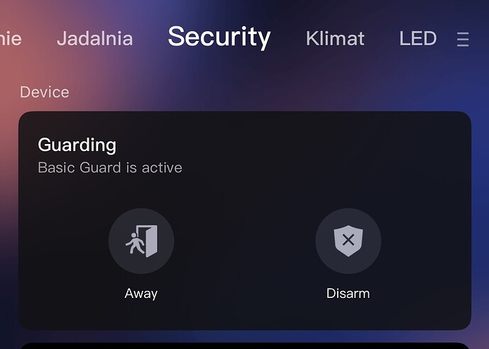

Then tap the text on the widget (in my case it’s “Guarding”). This will open Basic Guard window. Here you can see the alerts and configure notifications.

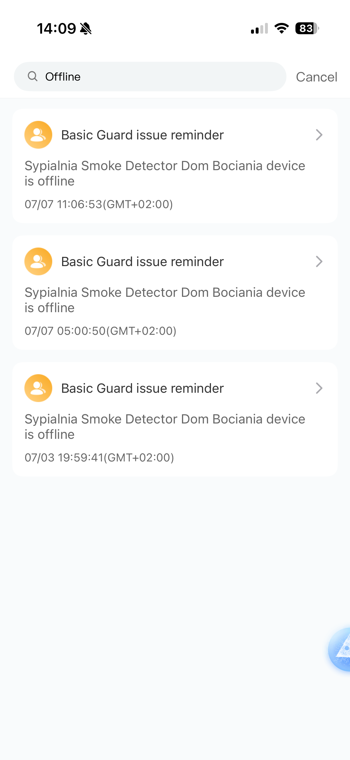

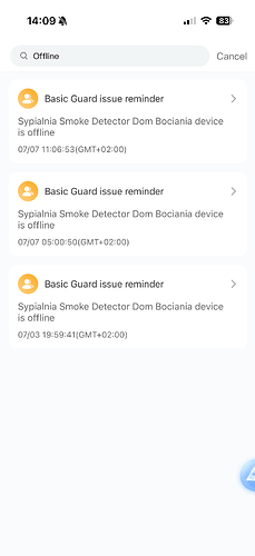

Enabling this means you will get a notification if any of your devices is offline. Example:

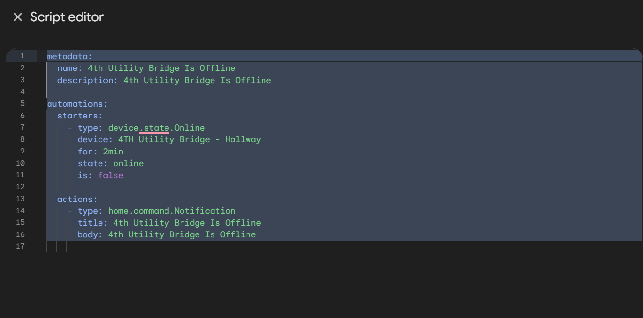

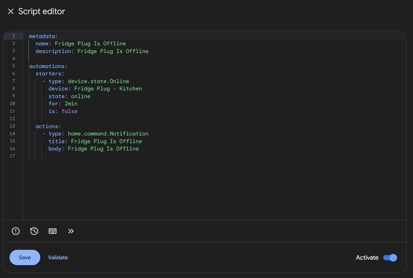

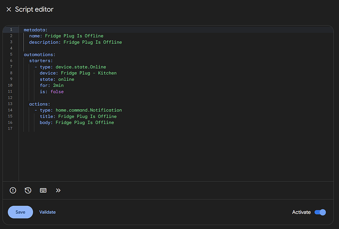

Is it zigbee? if yes then integrate aqara with google and create automation in google
after 2 minutes of being offline it will send you notifcation from google home
I don’t use google home, I’m al the way HomeKit but thanks anyway!
Use it only for offline notifications
