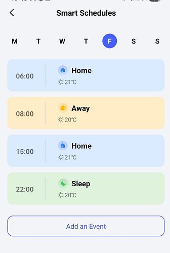

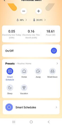

Unfortunately, I can’t get Smart Schedules to work. Here’s what I’ve done so far:

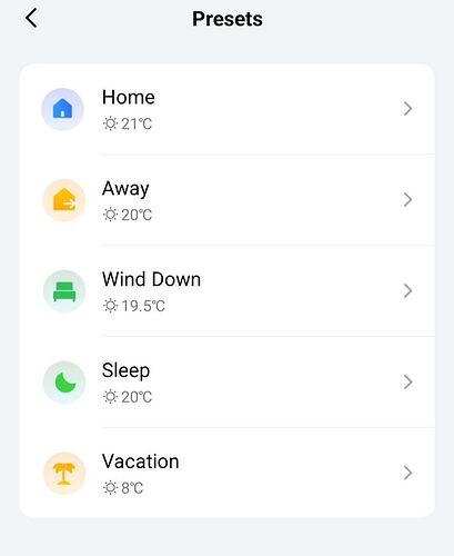

  • I configured all the Presets

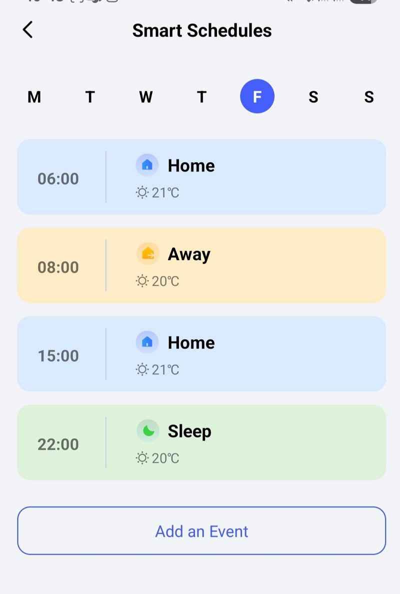

  • I set up my Smart Schedules
  • I enabled Smart Schedule mode in the App.

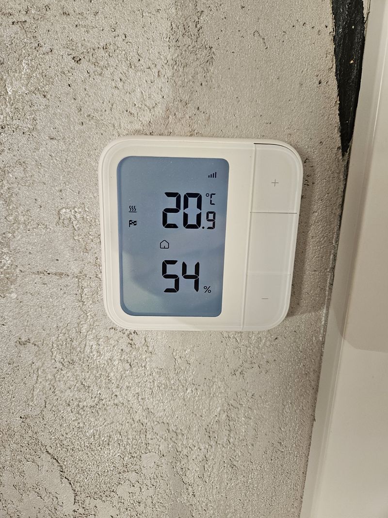

The problem is that the thermostat never switches between the scheduled modes. It always remains in the mode that I last selected manually, just before I turned on Smart Schedule.

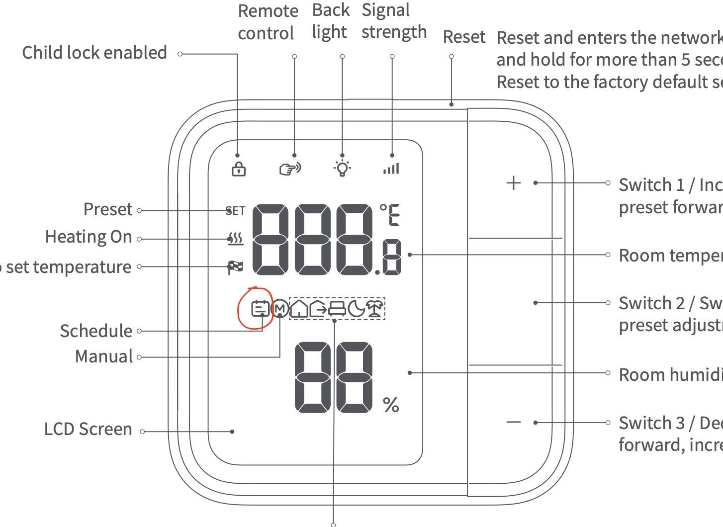

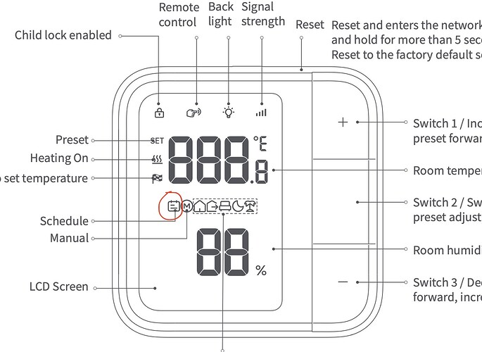

For the schedule to work, the icon on the thermostat should show the little “schedule” picture.
According to the manual, after a manual override, the system should revert back to the schedule after a default 2 hours. (It did not).

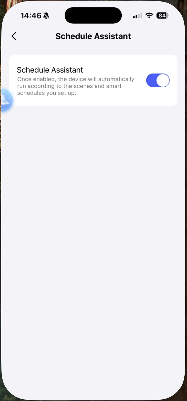

I had to manually turn the Schedule Assistant on and off for the “schedule” icon to reappear on the device.
I’ve not tested whether that works or not yet, but I think the key is that the schedule icon needs to be on. I’ve not found a way to turn the schedule icon on from the buttons on the device itself.

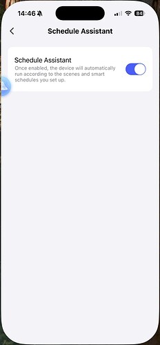

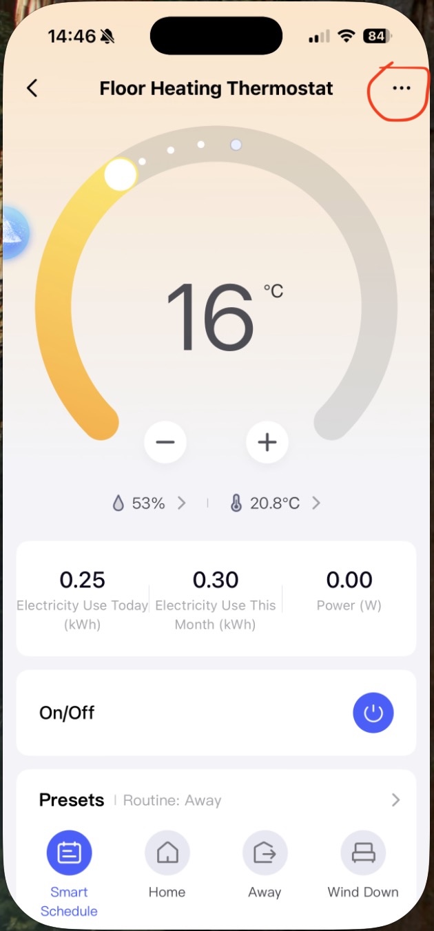

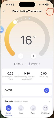

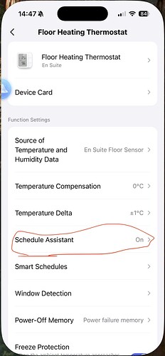

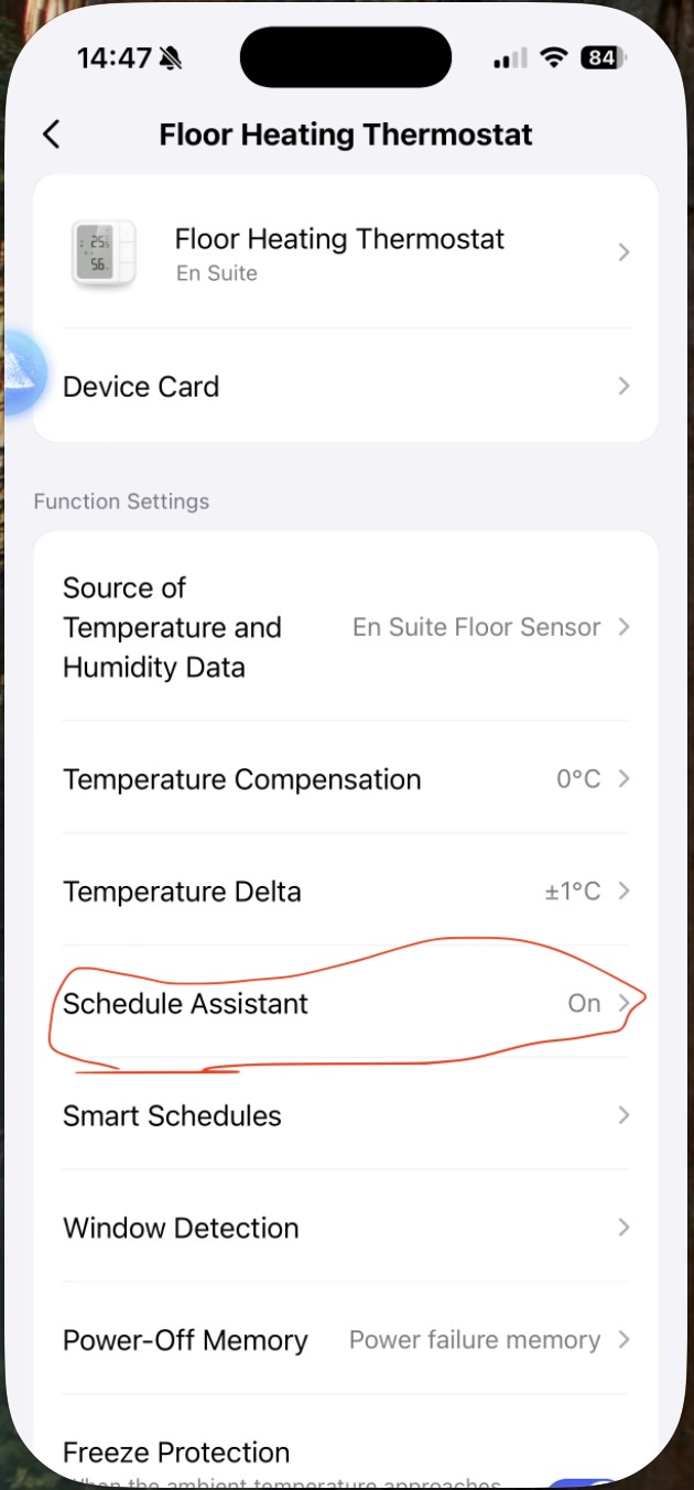

OK. I think I have figured it out.
The key is to ensure that the thermostat smart schedule is actually activated.
To do this, I needed to turn ON Schedule Assistant. (and check to see that the icon was lit up on the thermostat.)
Once that icon is on, the smart scheduling works as described.

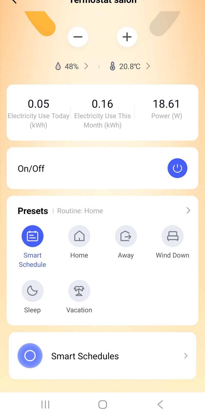

I also noted that if you then manually change a setting on the thermostat itself, it will automatically revert to the schedule after 2 hours, unless you go back into the app and select the “Smart Schedule” preset.
As far as I can tell, there is no way of turning ON the Smart Schedule directly from the thermostat.
