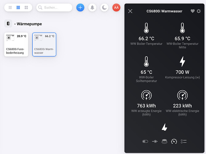

Here’s a glimpse of my setup:
Integration Success
