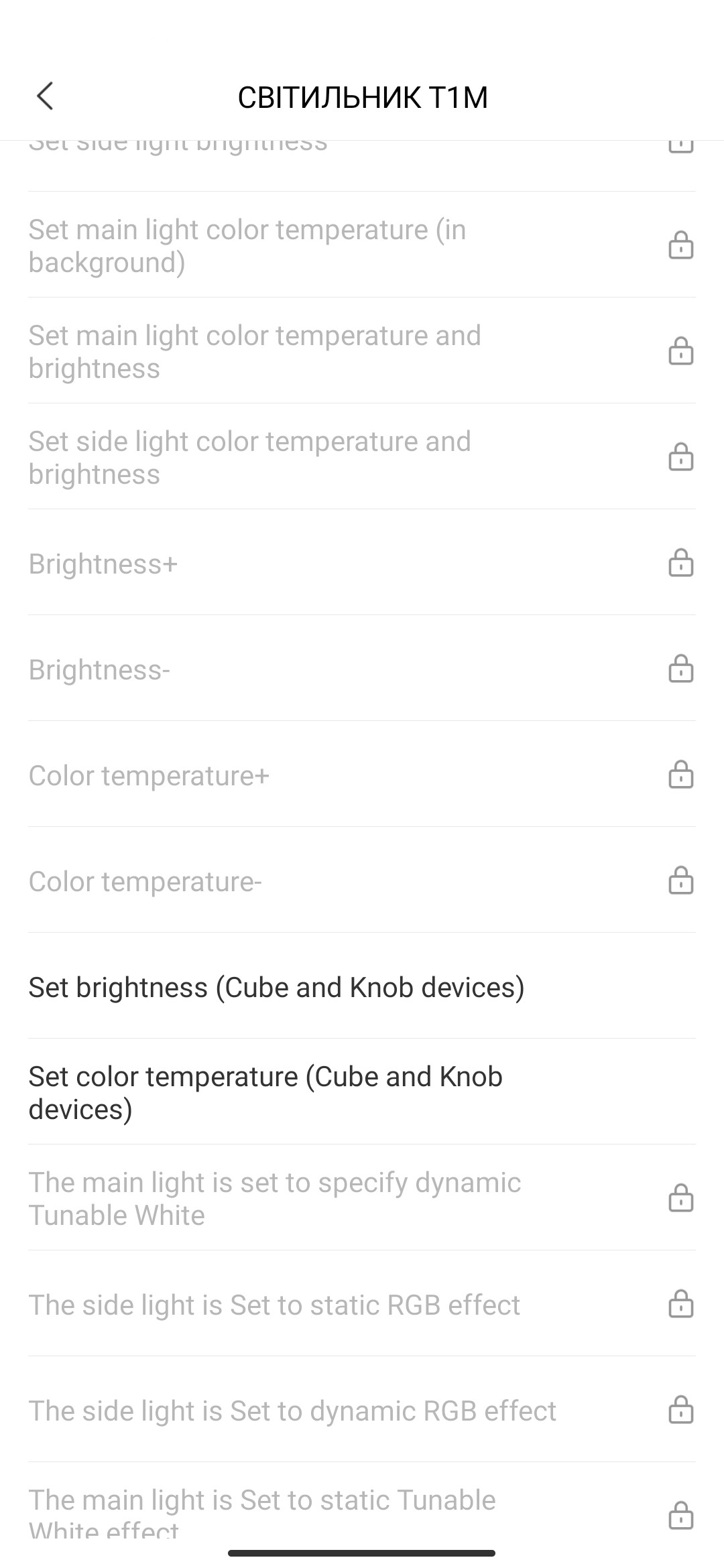

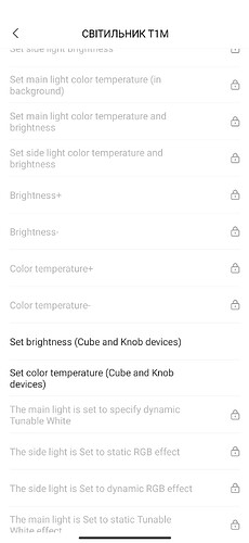

Let me test something tonight.
There’s no direct link option, but when I create an automation on the trigger “Rotate”, I can then select a limited number of actions on another Aqara Light.
It seems to use the value of the current Dimmer to assign it to the other light.
If that works, that would be your solution.
Since the Dimmer has to be powered, you could plug your light on it, switch it to “Decoupled mode” so that the ceiling light is always powered, and then use the automation to control.
Maybe somebody has already tried this and will confirm before I test.

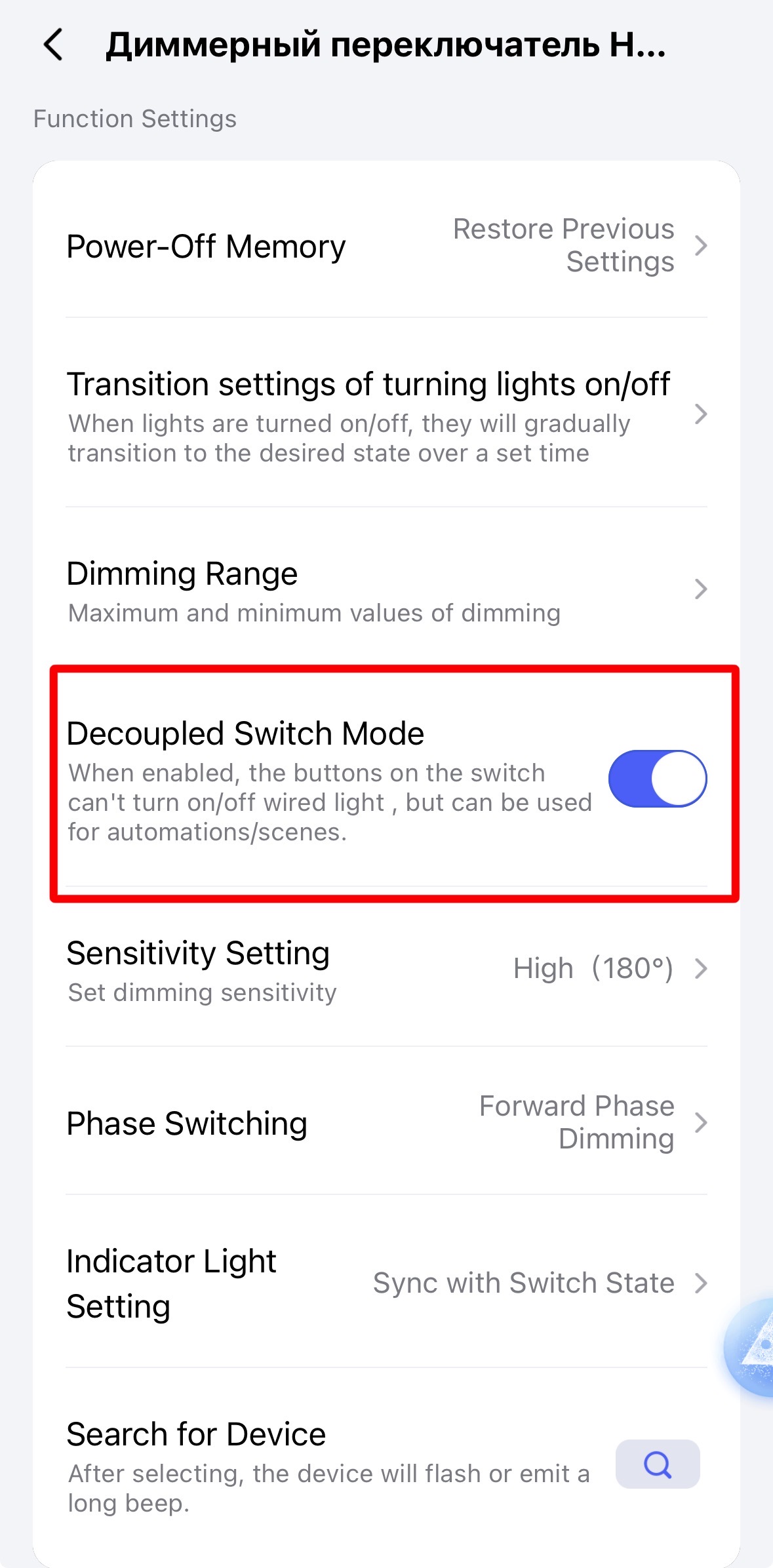

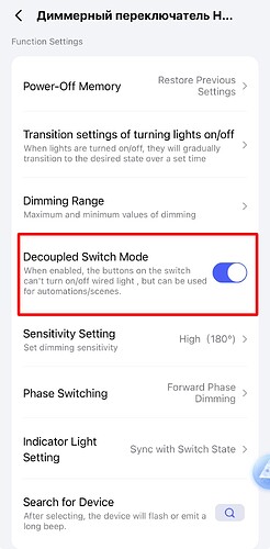

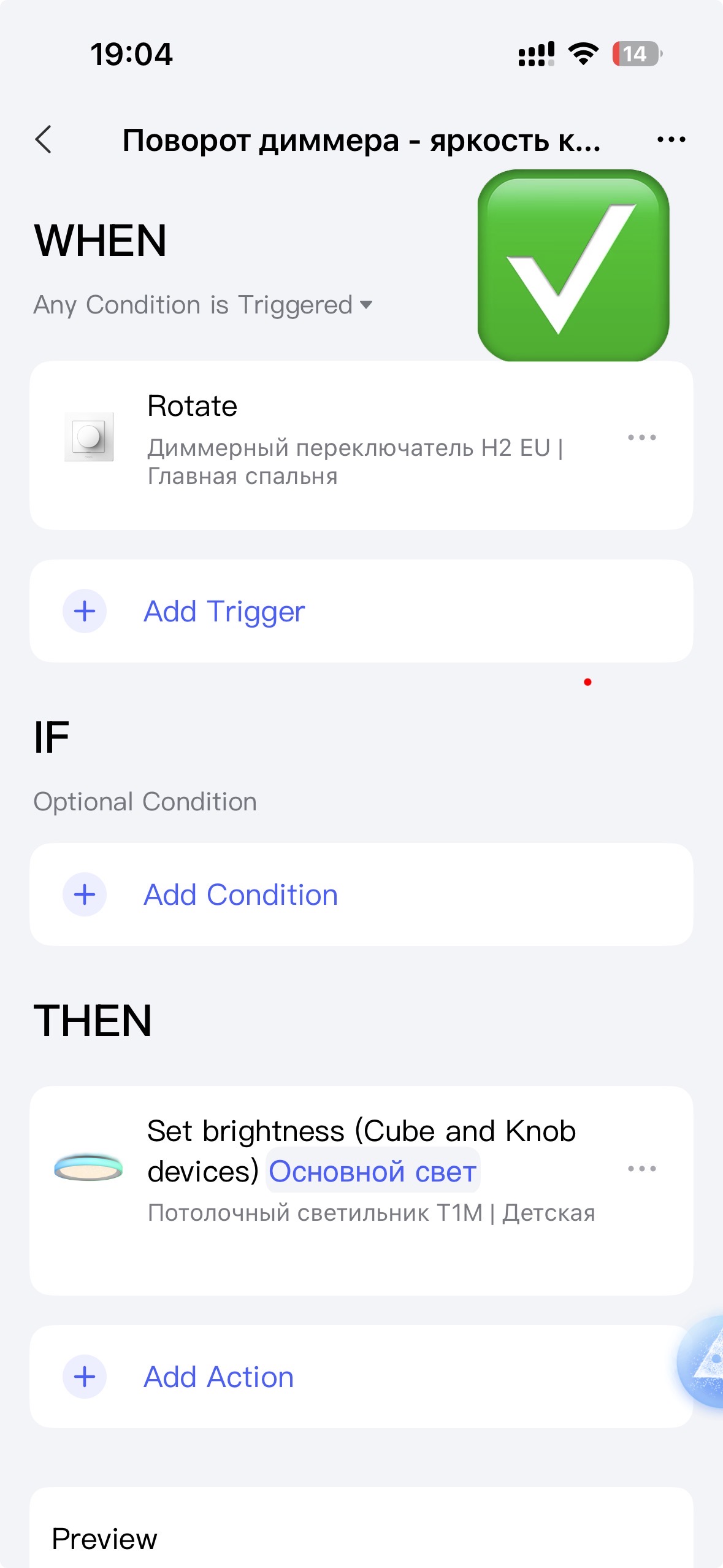

Hello @andrius_b
You need to switch the H2 dimmer to wireless mode
then create the automation you need
I checked, it works, will work and works.

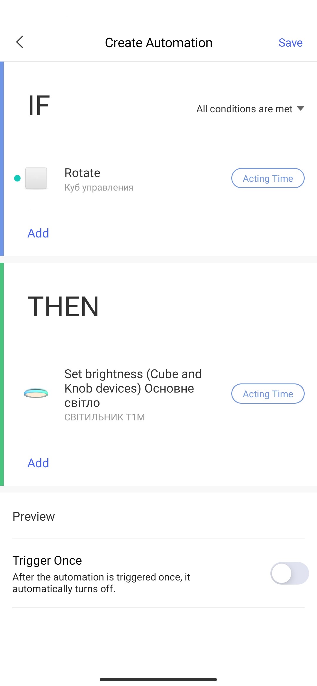

Hello, what Roman showed is the T1 adjustment. In my drawing, the same automation is used, only with the use of a cube (rotation). Also, understand that if you physically disconnect T1 from the power supply (with a switch), the lamp will simply go into offline mode.
in my automation the dimmer logically controls T1M and when the knob is turned it changes the brightness to T1m.
and my T1M is connected to S1 plus via the MARS mode (smart load) with constant power supply
Ah… It works. So cool. But the key here ist to set an Automation AND use the MARS technologie from Aqara?

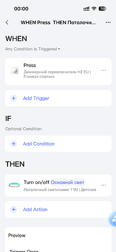

Hello
no, you need to connect t1m directly without a switch so that it is always online, and switch the H2 dimmer to logical mode (wireless) as in my screenshot in the first answer and create automation.

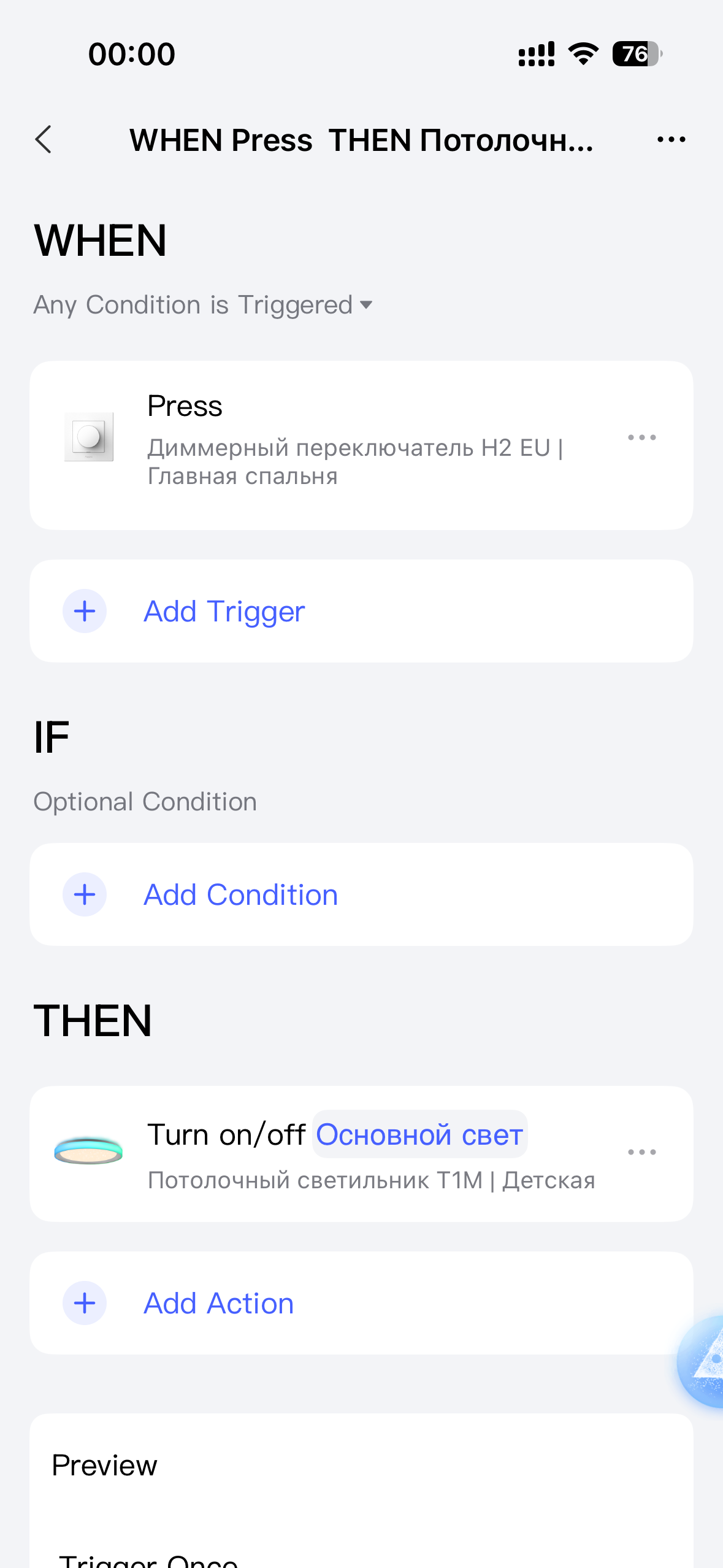

ok, so physical “push” (turning on) won’t work, right? it will be only left/right turning of the knob to control the dimming, so actually you cant switch off the T1M completely?
Wireless. Got it. Same mode i use my H2 EU Switches :v::handshake:
I will be able to turn it off by pressing the handle and creating an automation for this
And by double-clicking I can also turn on or off the additional T1m backlight, also creating automation
