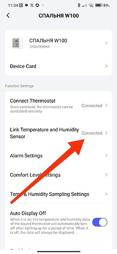

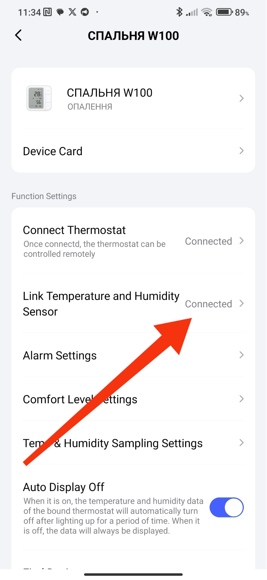

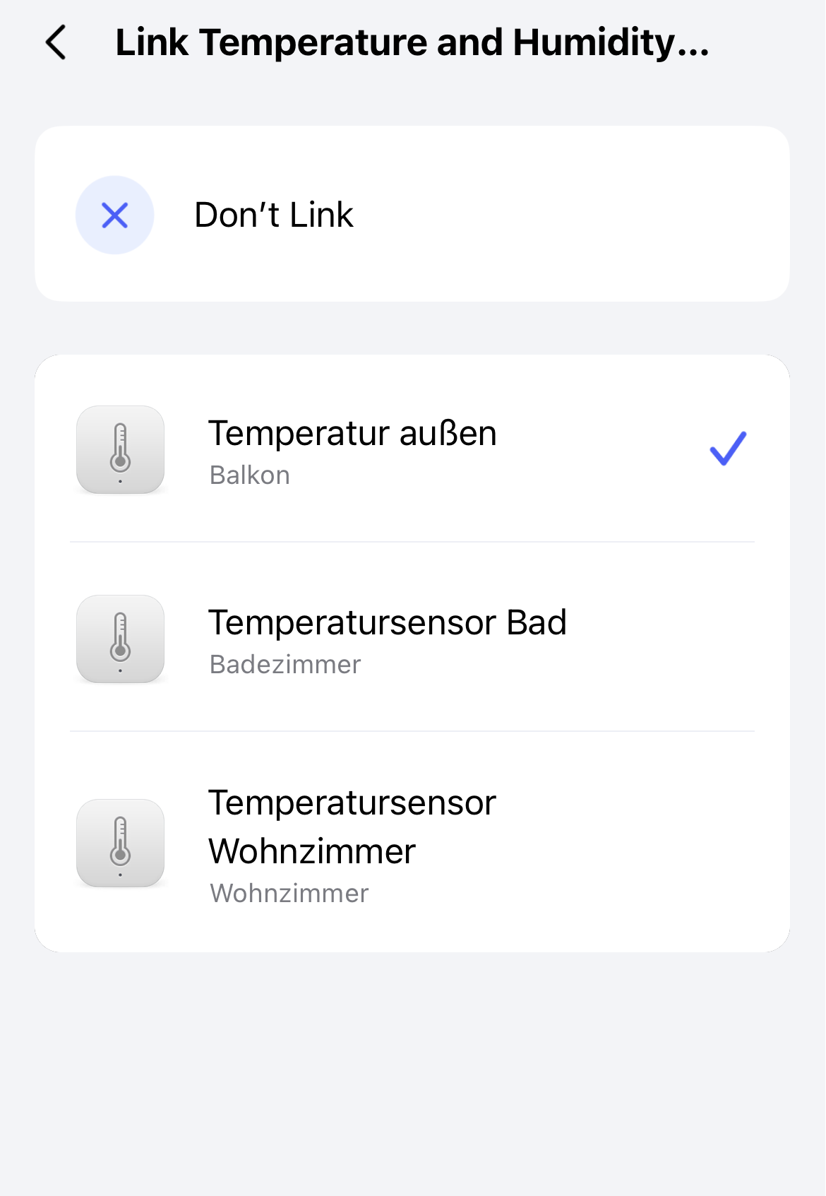

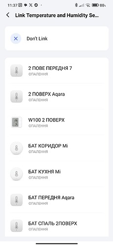

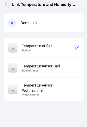

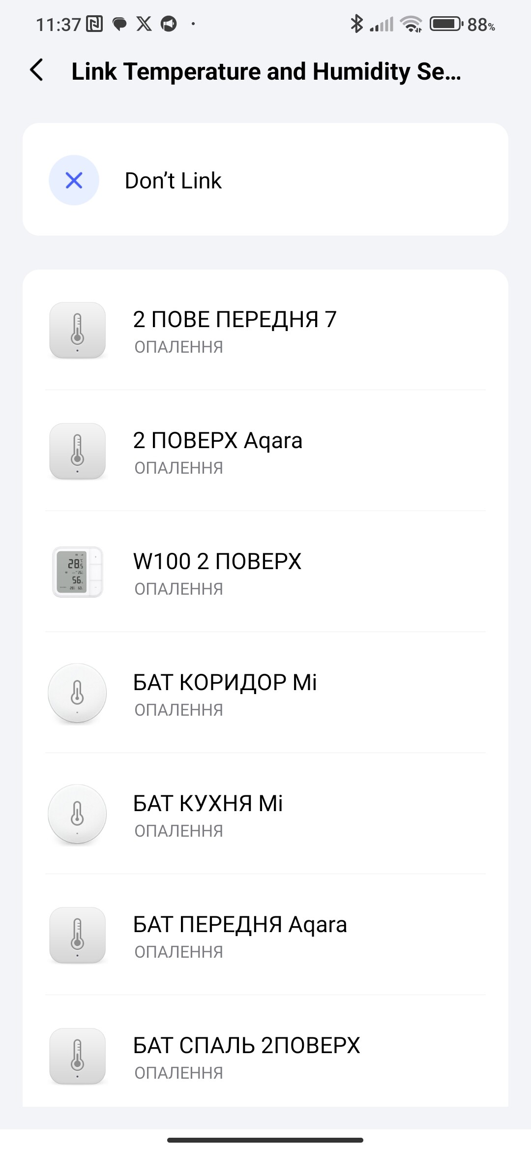

Hello, welcome to the forum. This can be done in Aqara home. Here is the setting.

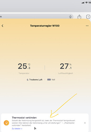

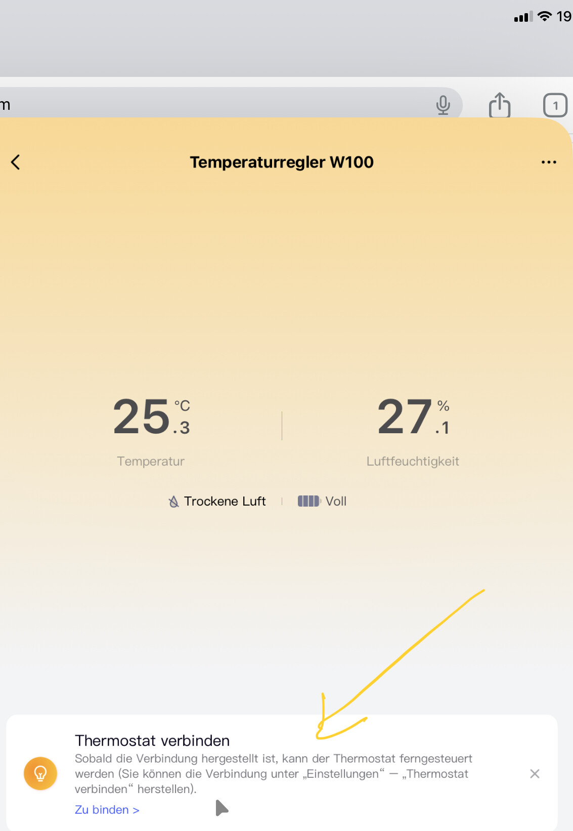

The problem is that I cannot see this T1 sensor in the overview in W100.

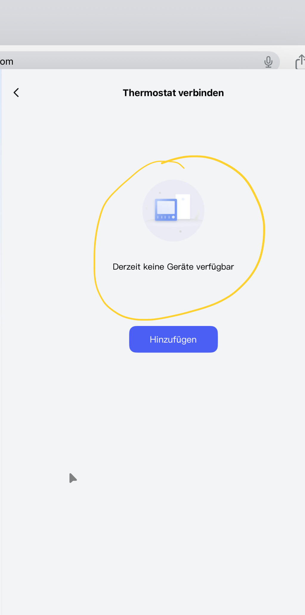

Aber bei der Verbindung kann ich den Sensor T1 immer noch nicht sehen.

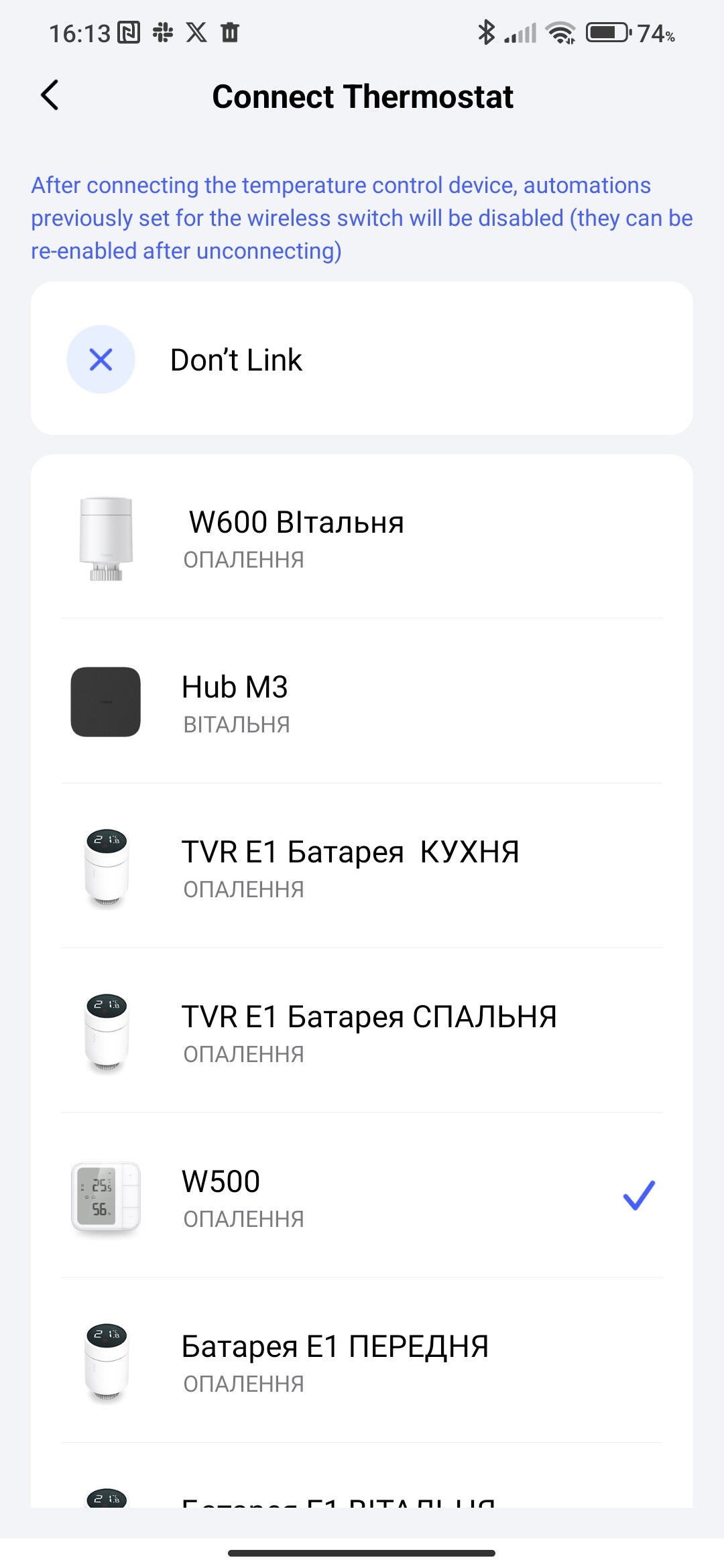

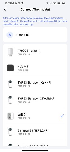

These are completely different things!!! This is a link to THERMOSTAT E1, W500, W600. In these settings there will never be a thermometer T1.
