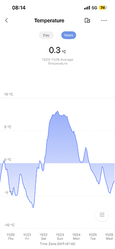

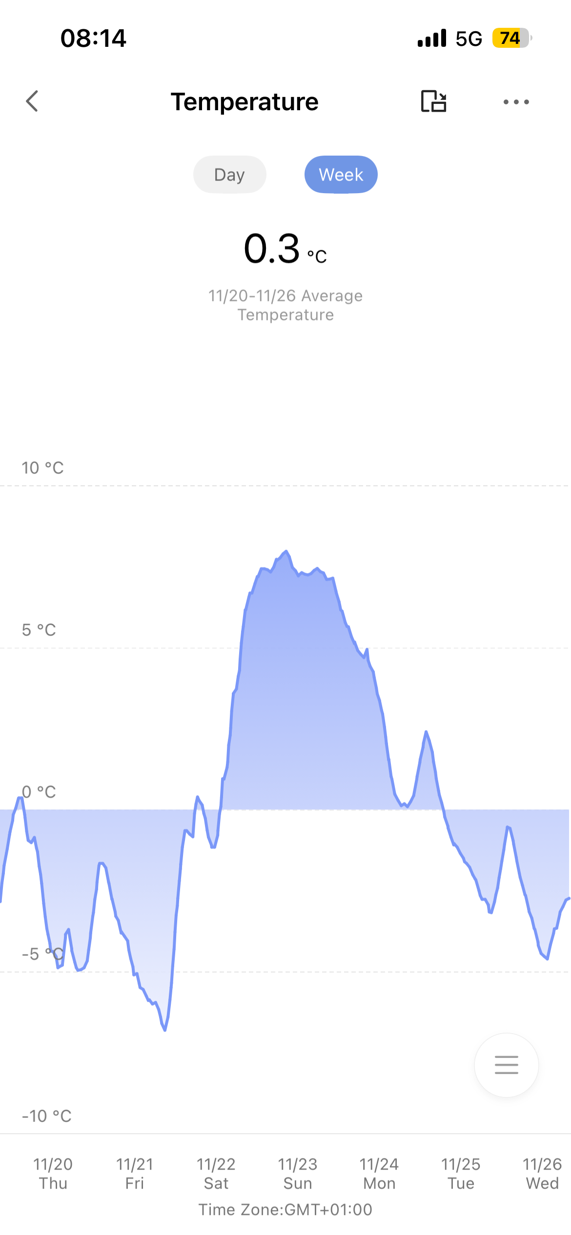

I have Temperature sensor outside on window, but now in cold weather it can’t handle low temperatures and is still disconnecting. It is only slightly below 0 celsius, but it should work until -20.
What’s wrong?

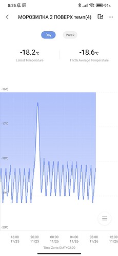

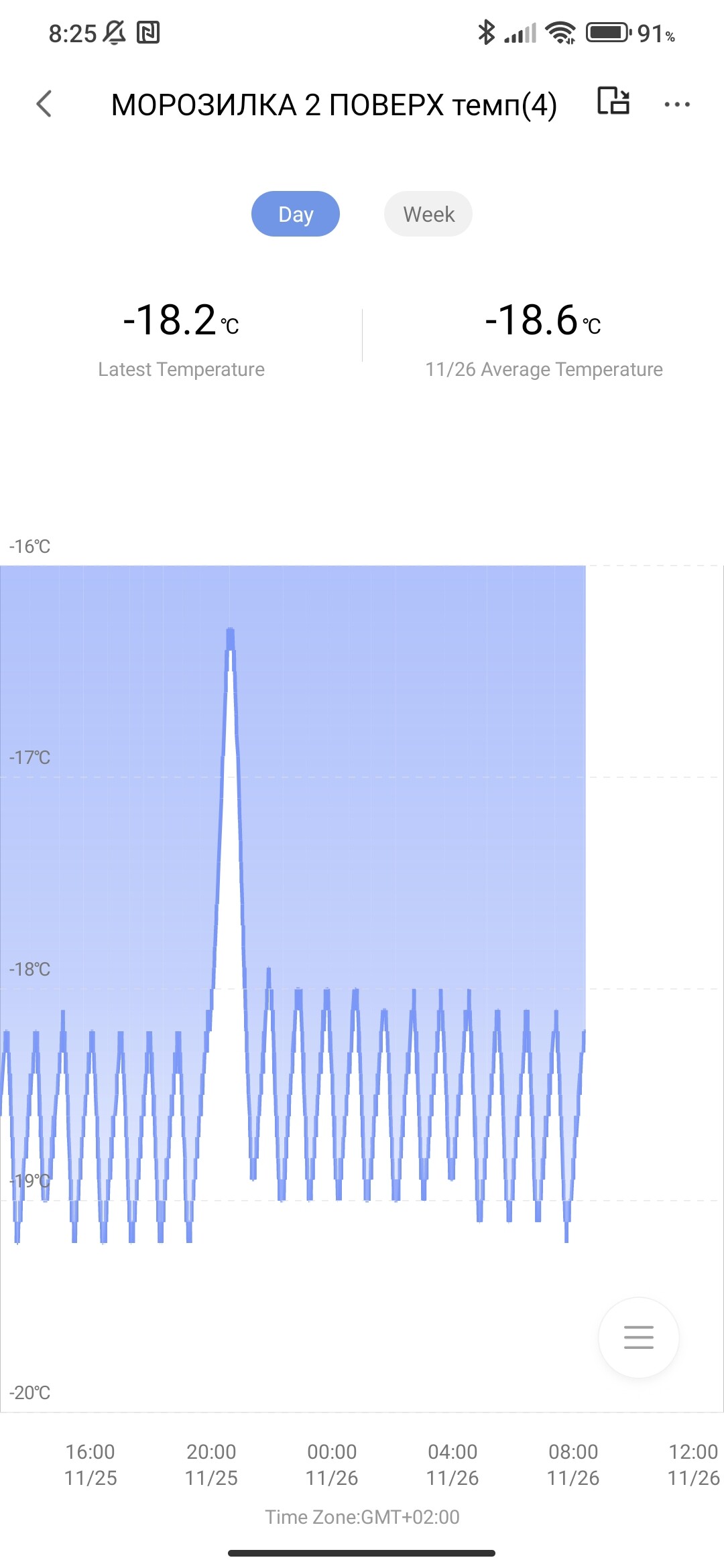

Change to a new battery, 99% that the problem is in it. This is a graph of the temperature in my freezer.
I have a temperature sensor outside too, worked well here, been a few minus degrees the last week
so it seems that Consumable overview is useless, when it displays full battery
anyway, I have changed battery and it is offline again :-/
but thanks for tip
