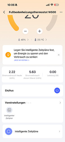

When I add the device in the Aqara Home app, the initial setup process completes successfully. However, after closing and reopening the app, it asks me to go through the setup process again, as if the device was never configured.

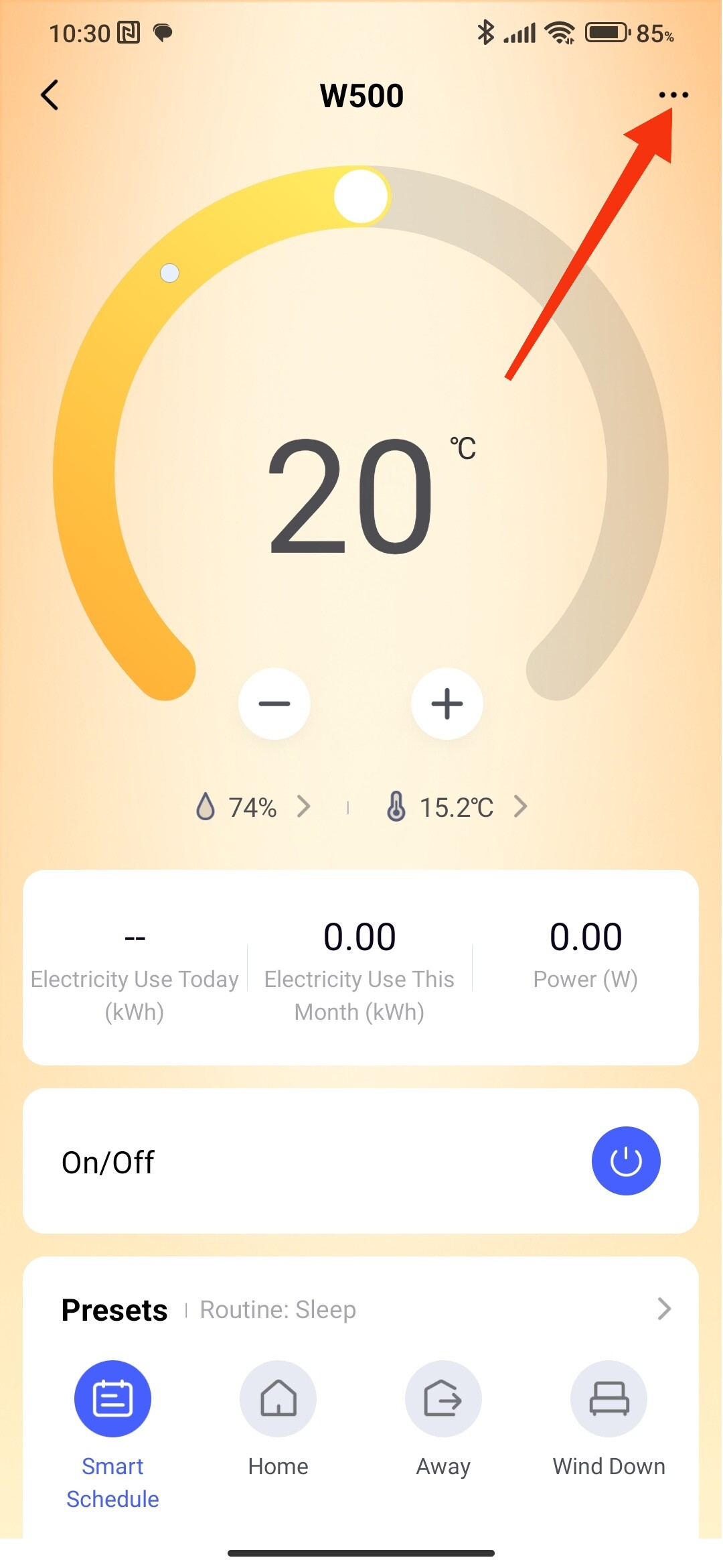

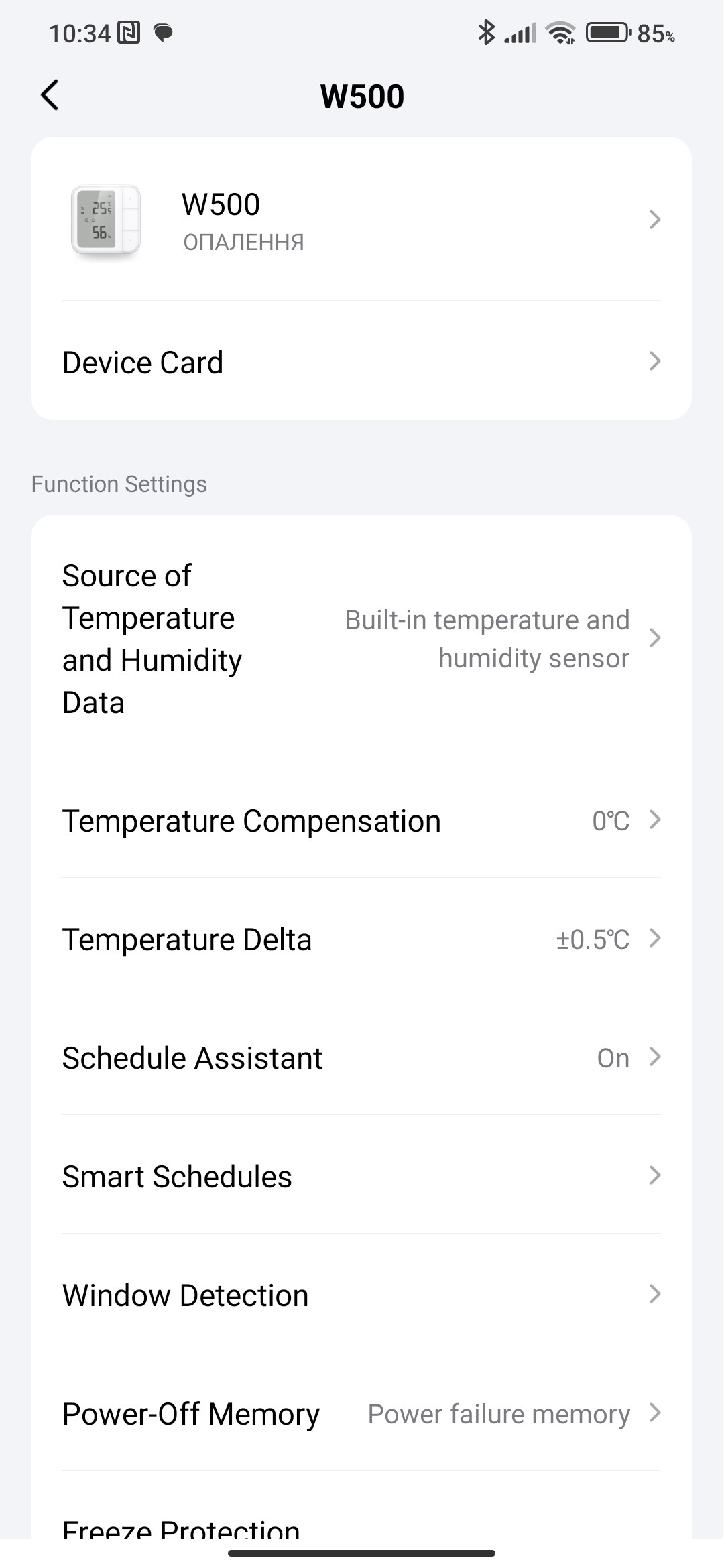

Hello, please tell me, do you have an Aqara gateway? Show me a screenshot of these settings. Thank you.

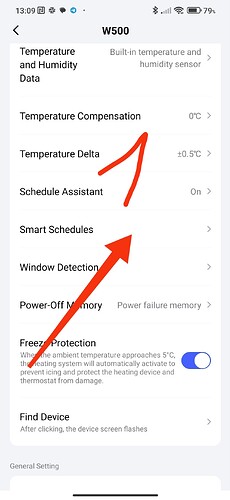

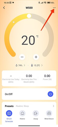

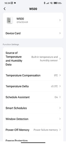

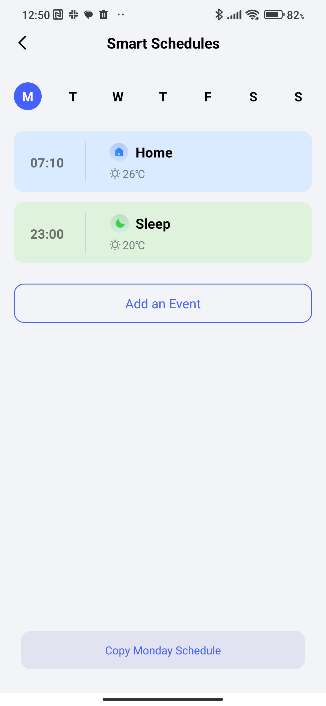

You didn’t choose a reasonable schedule, and that’s why the assistant constantly wants to set a temperature schedule for you.
Install manually here.

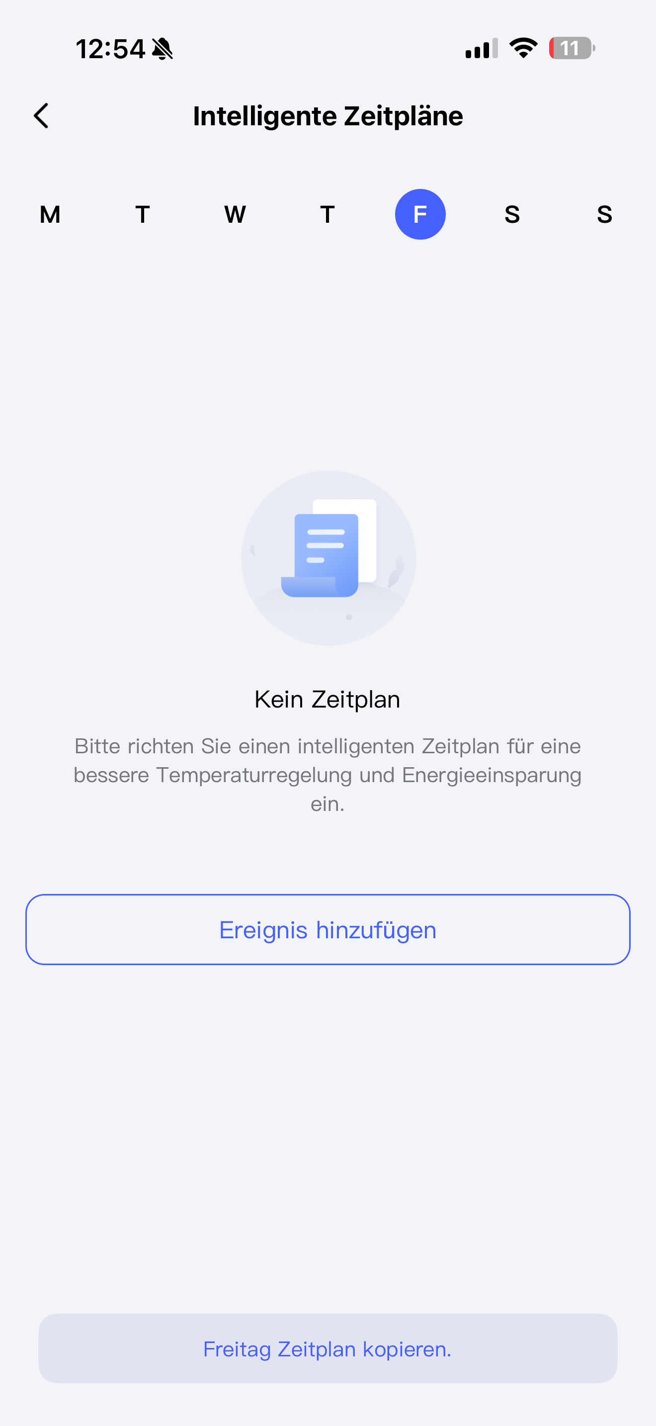

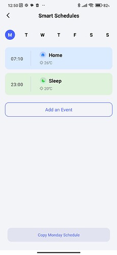

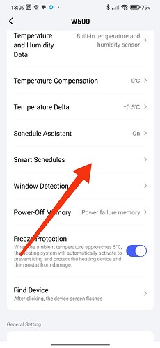

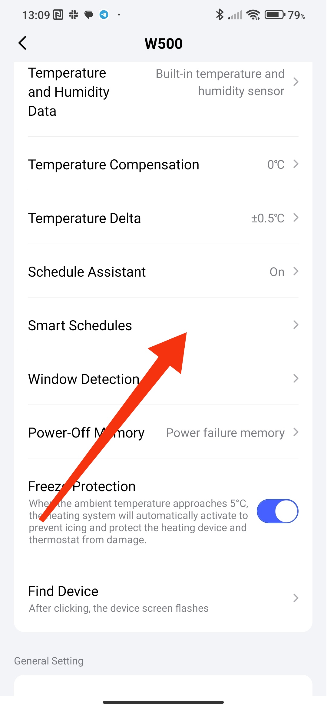

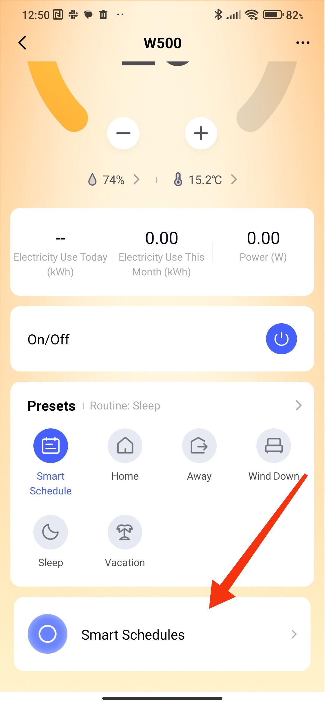

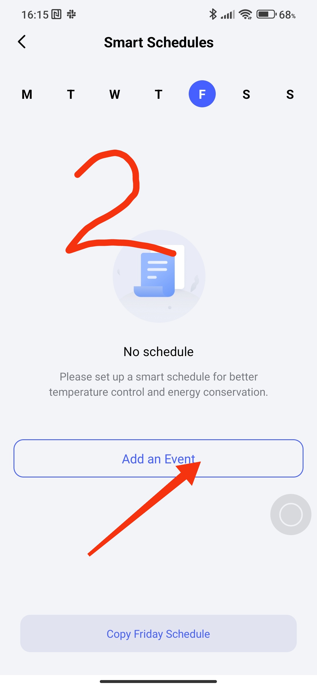

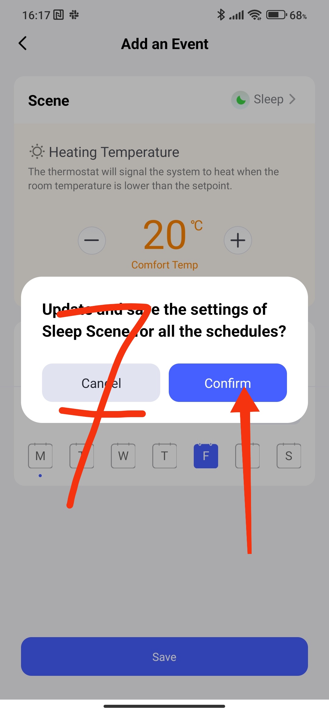

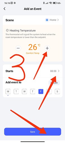

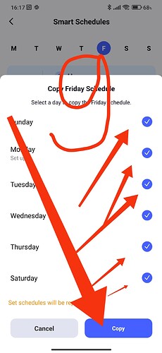

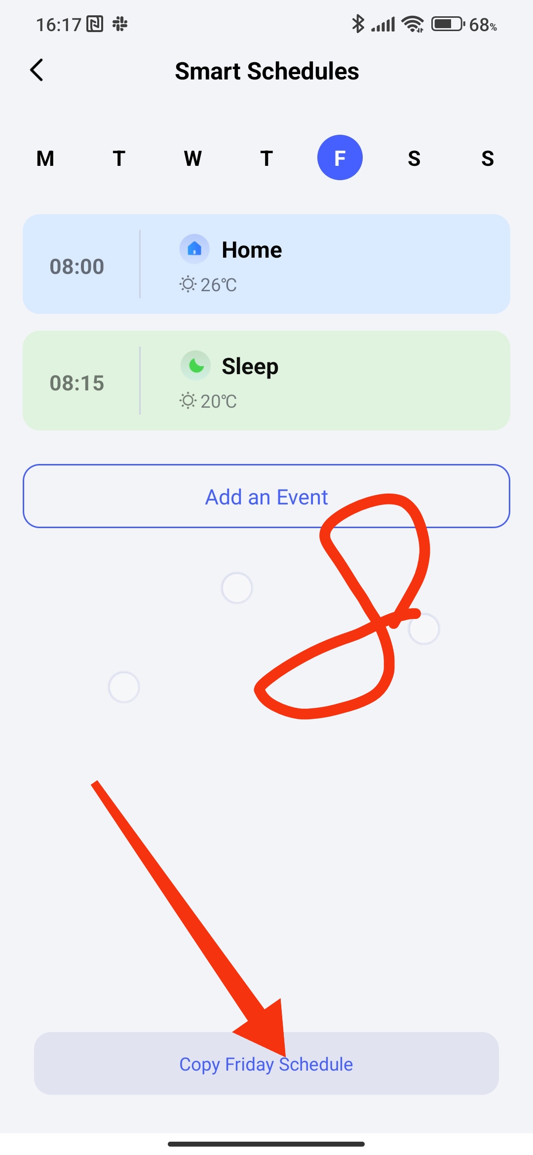

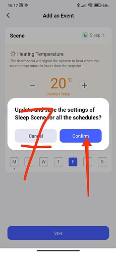

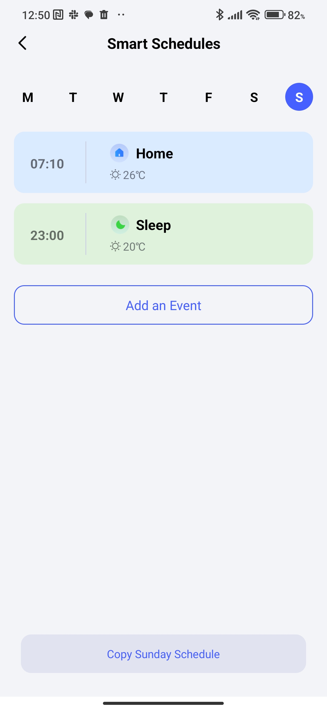

Please show me with a concrete example because it doesn’t seem to work for me. I’ll send a picture of how far I’ve gotten, thank you

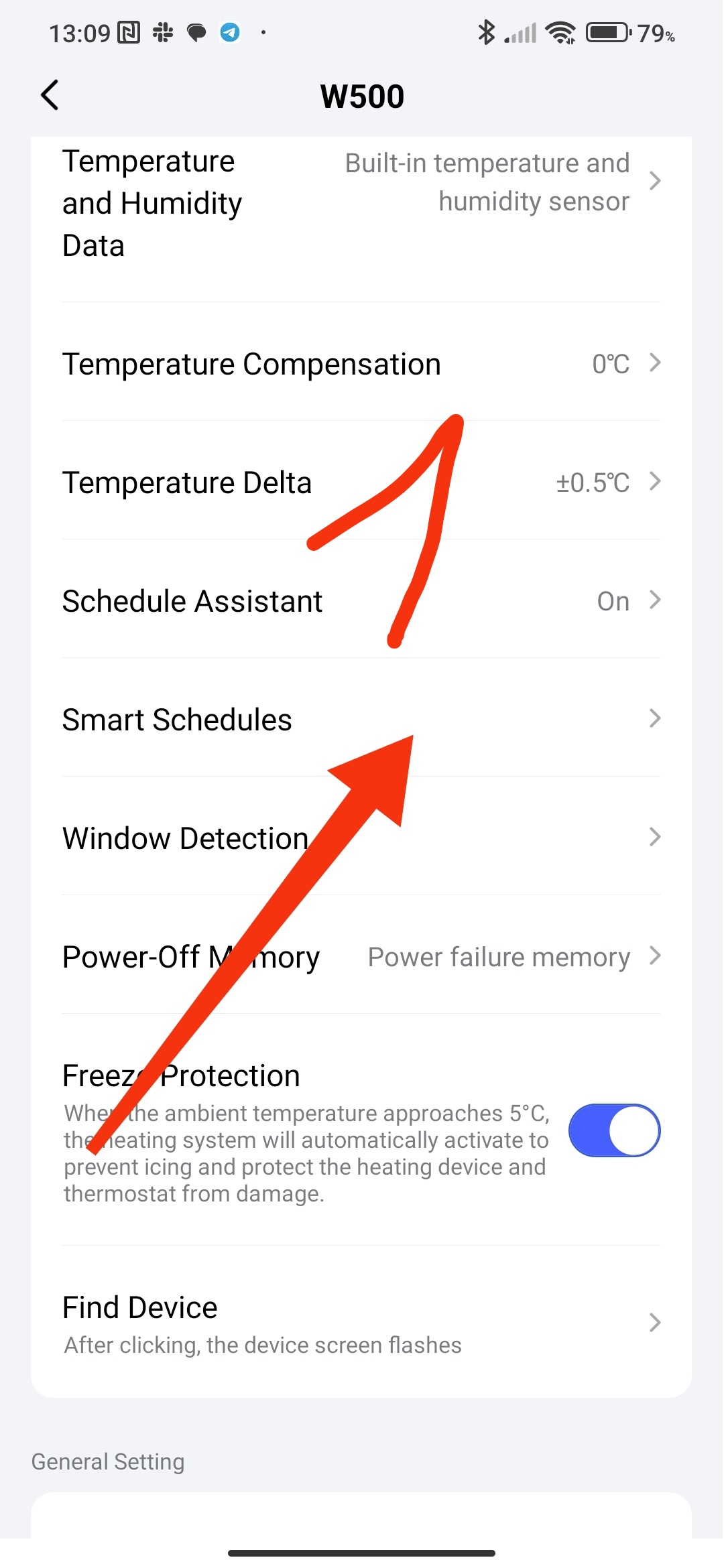

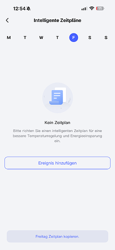

Smart Shedules this shows up here.and here I dönt know

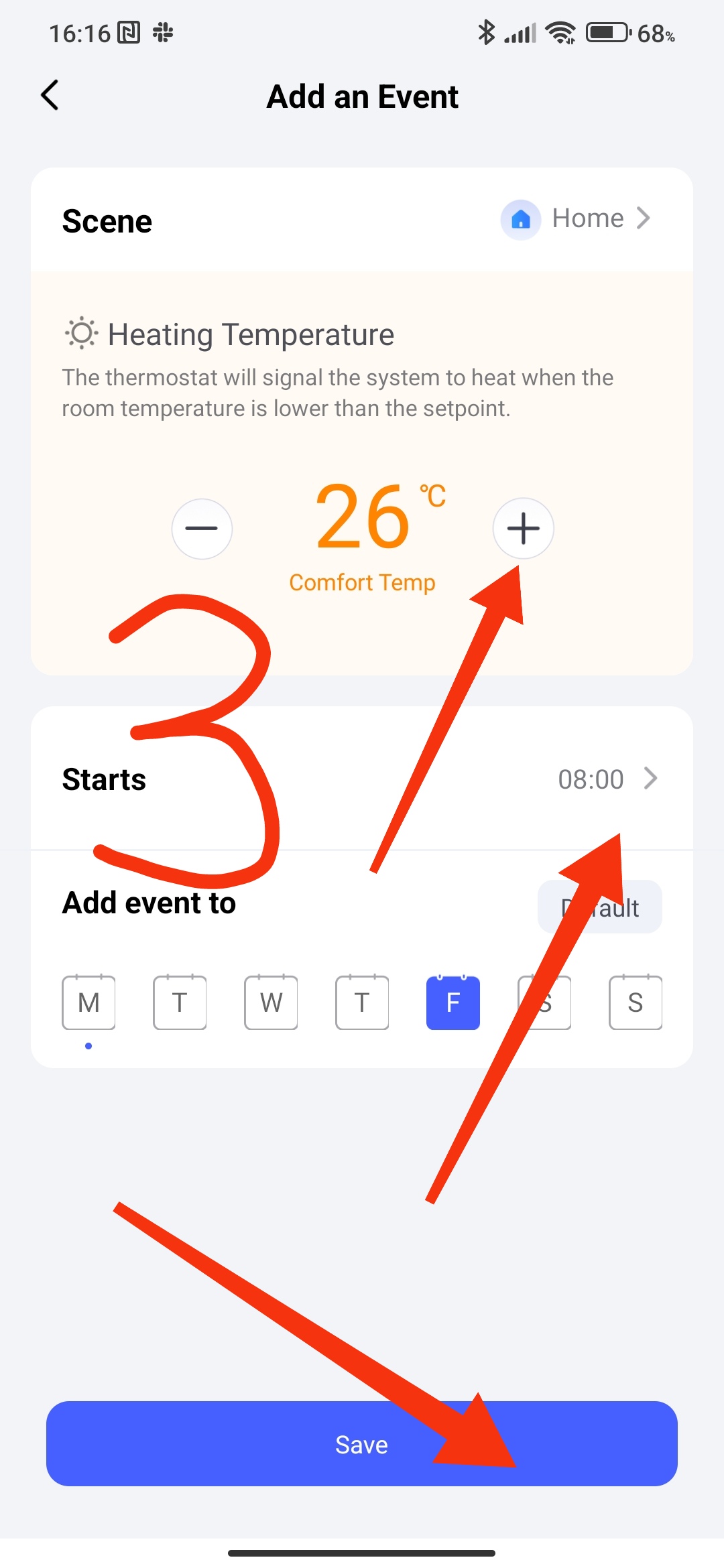

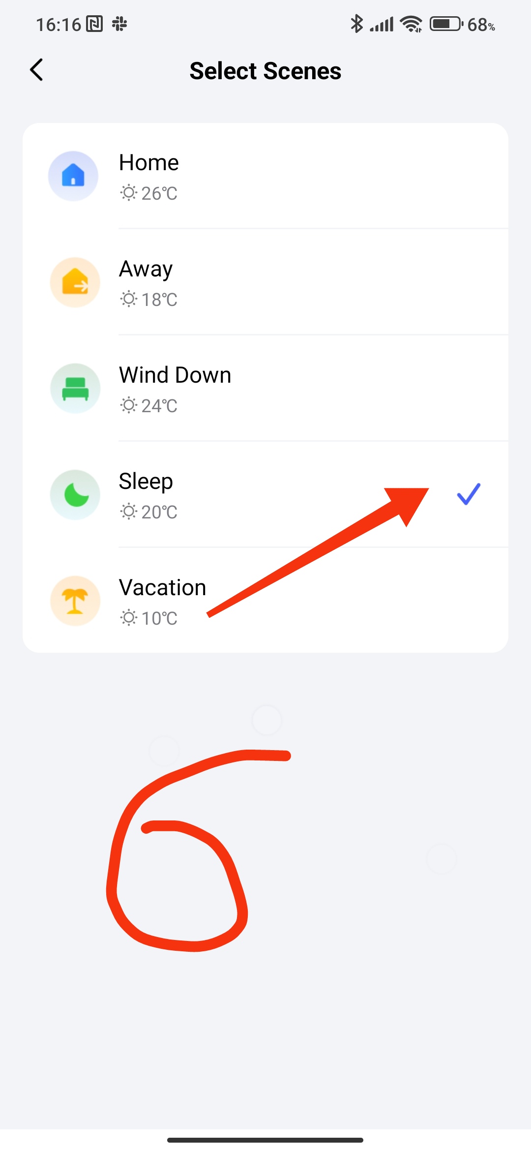

This is what it looks like on the screenshots step by step.

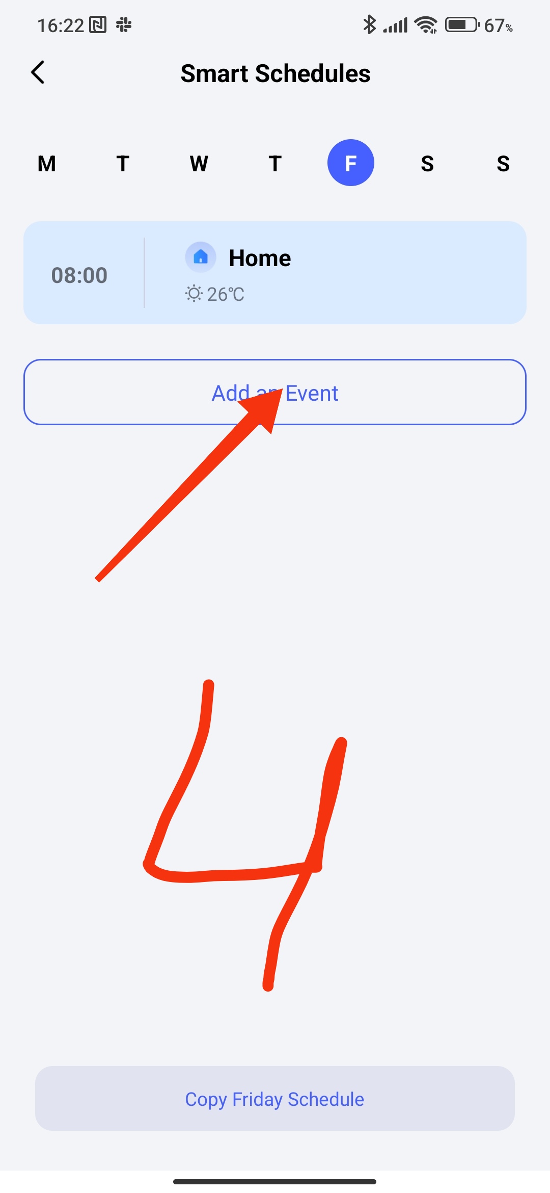

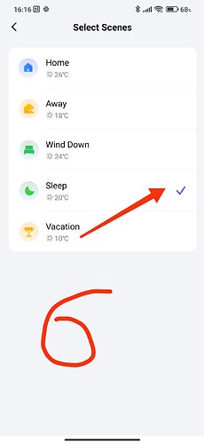

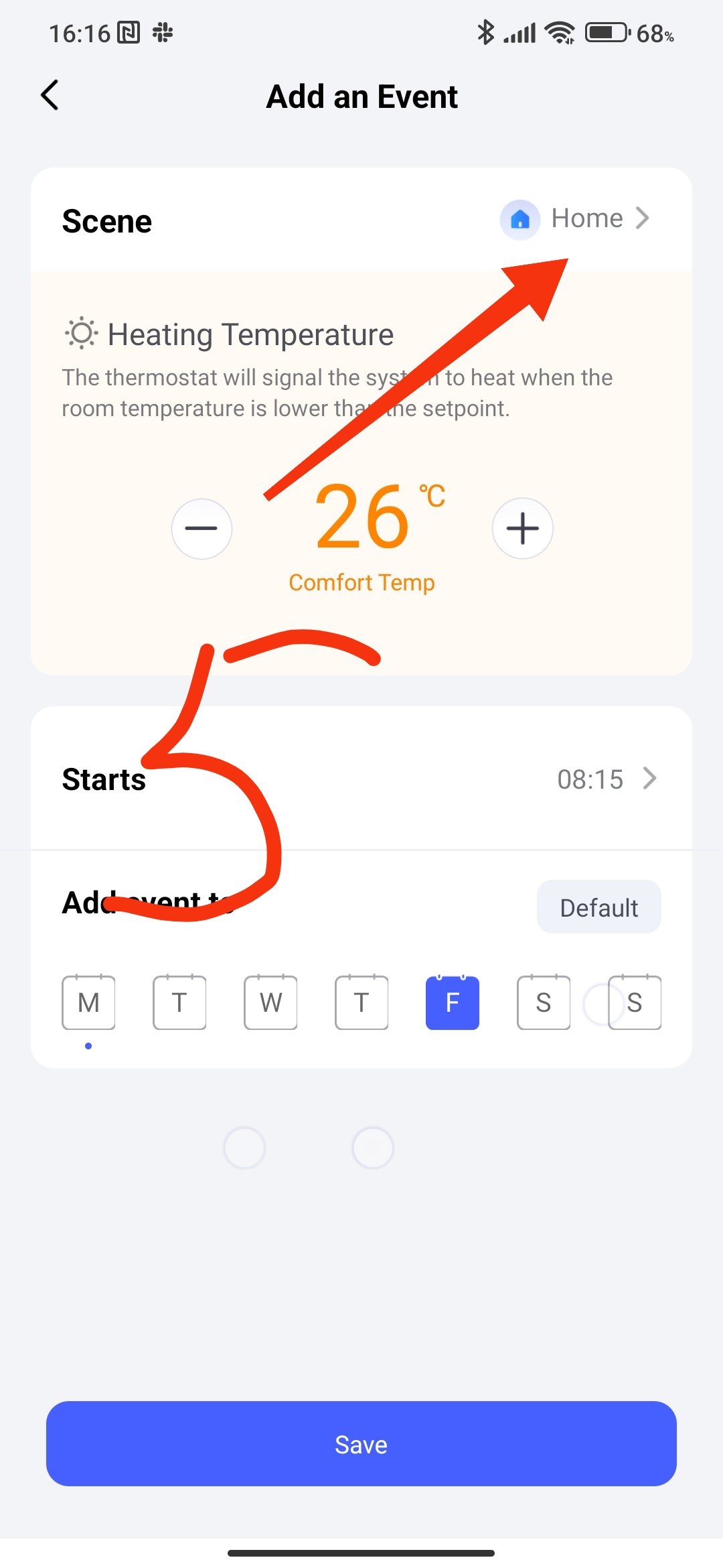

I don’t know what’s wrong, step 3 doesn’t give me the scenes. No matter what I do, it doesn’t work and I can’t save the scenes
. I don’t know if the thermostat is bad or the camera g3hub is not compatible.
Do you enter manually or automatically (with an assistant)?
Scene 1

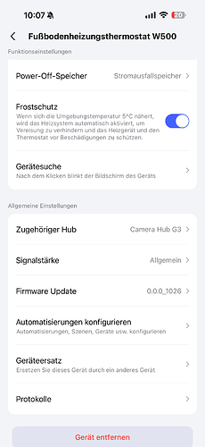

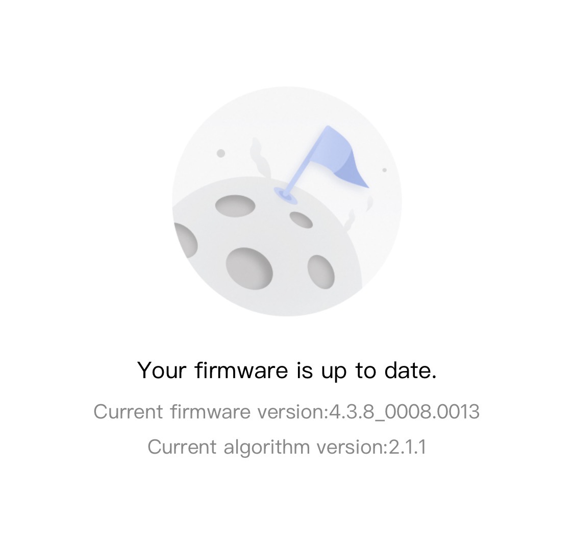

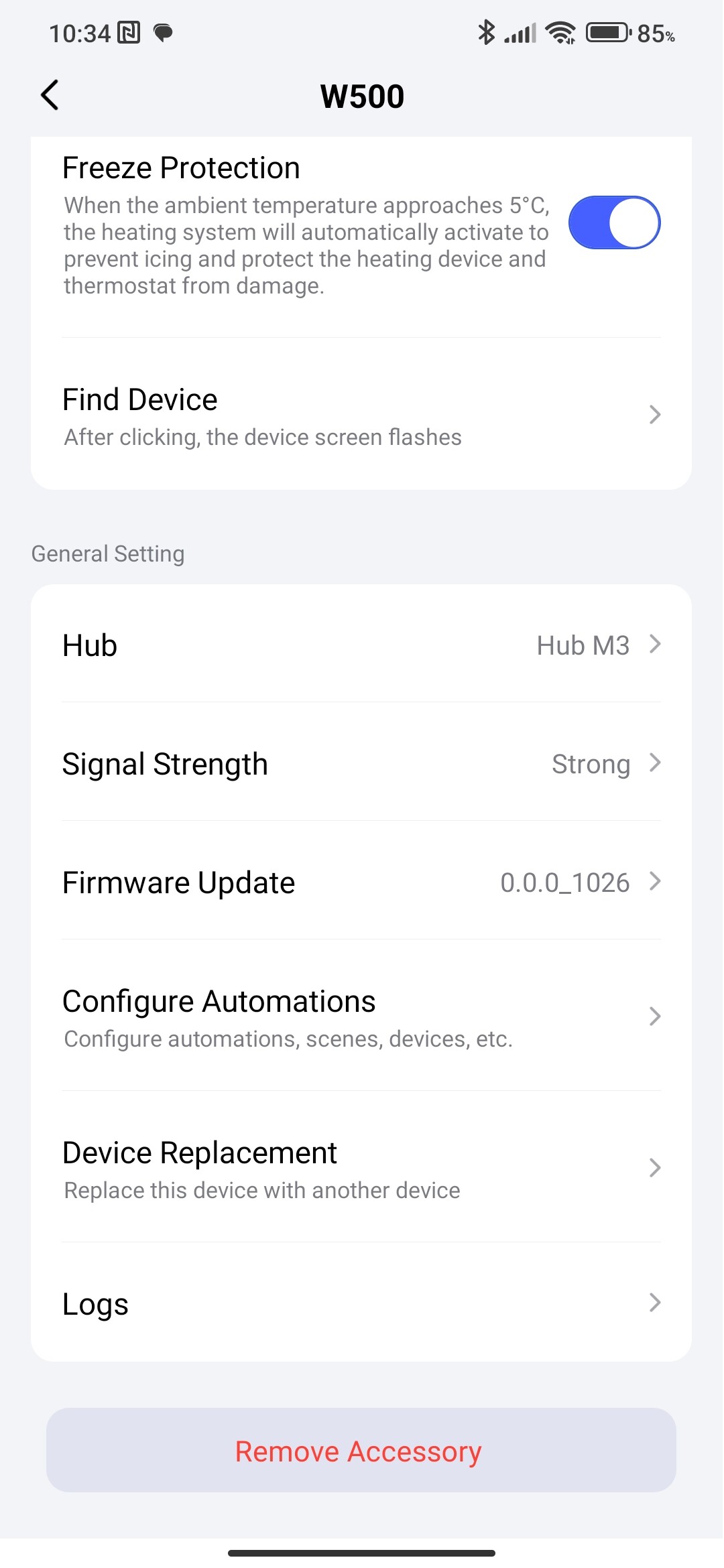

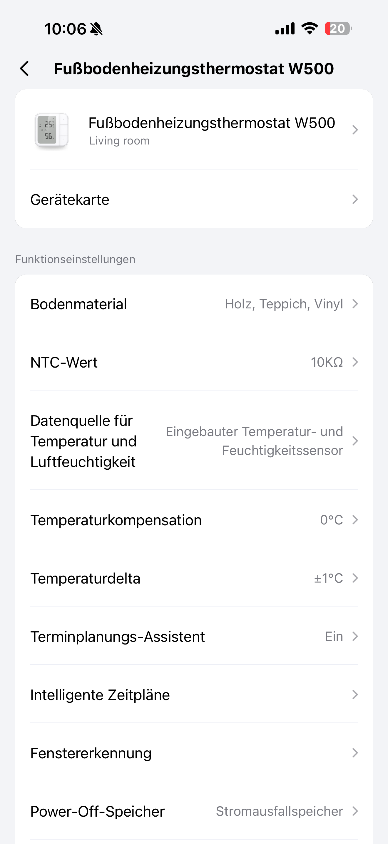

If still no solution, check the fix, that worked for me:

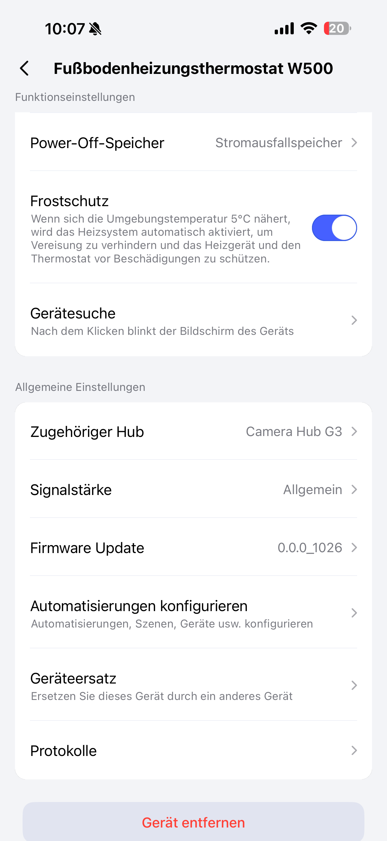

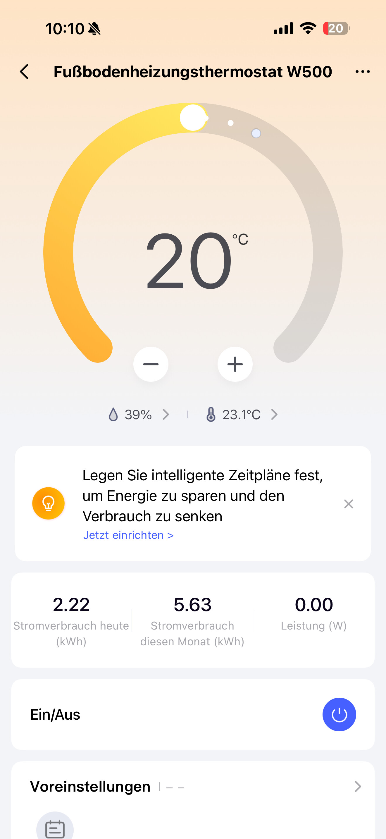

Hi, support fixed this problem for me today. Problem for me was current G3 firmware version. I guess this is something they have not released yet (everything was up to date). They pushed it forward for me.
Check this screenshot (version that is working for me), if it is different, ask support for help.
