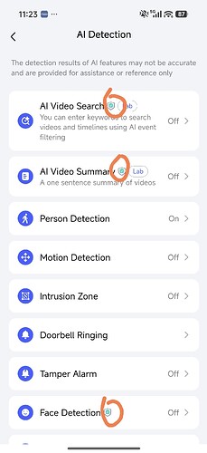

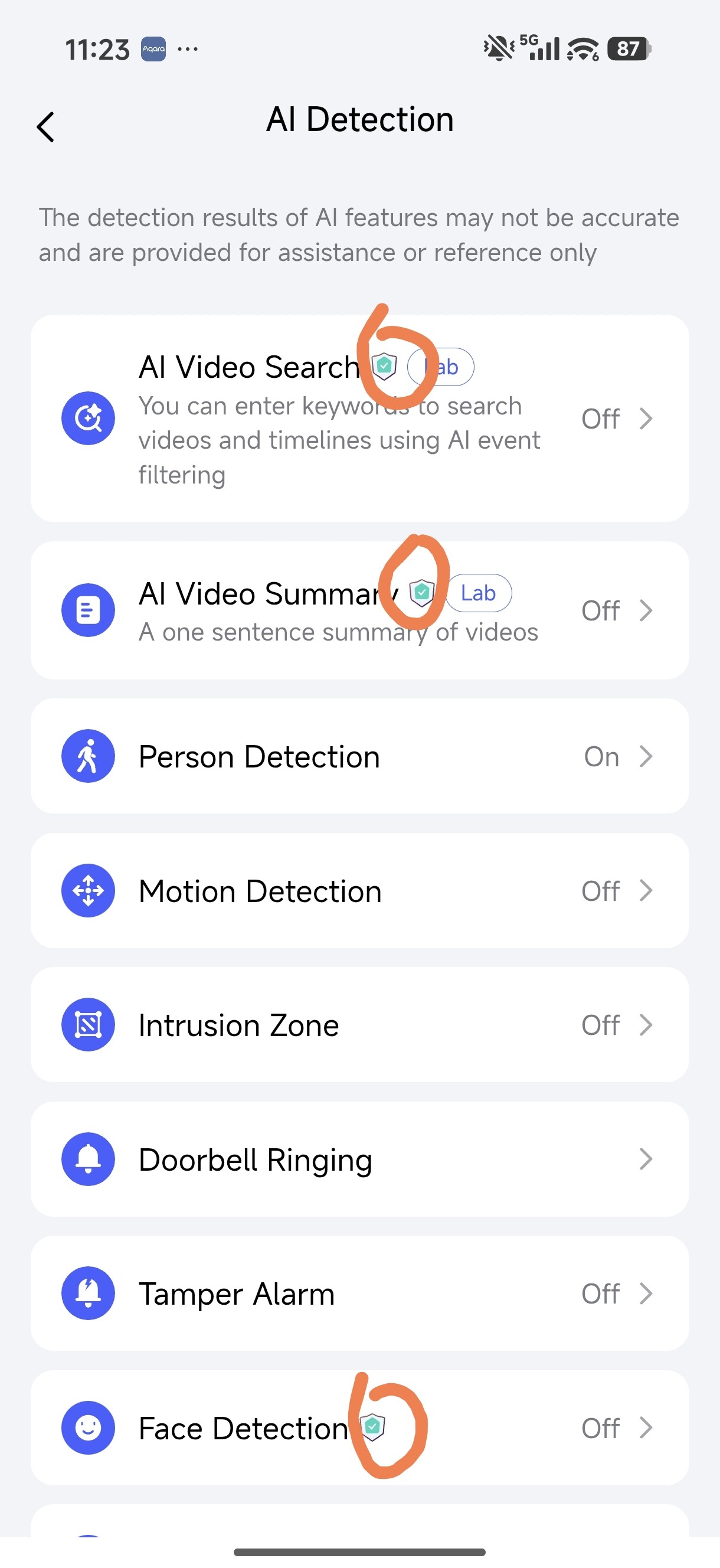

  3. The cloud AI recognition message of the camera usually has a specific home guarding icon on the app page (I have shown the cloud AI event in red circles in the figure below), and requires payment to continue activation. Their detection logic is to first trigger recording through motion detection, and then send the recorded video to the cloud server for analysis. After the analysis is completed, the results are pushed. Therefore, the delay fluctuation of the classification message is very large and random, completely dependent on the time consumption of the entire process and the processing speed of the server, we have recently increased the AI processing capability of our servers to alleviate the bottleneck of analysis. Moreover, if this type of detection is configured with automation control, it usually affects the duration of automation execution (as it can only be determined as an event after the AI analysis of the cloud server is completed)
When you notice a message delay in the app, please first confirm which type of problem it is based on the above principle. For the message push logic of the cameras mentioned in the second point, if you have good modification suggestions, please feel free to discuss them in the comment section or feedback directly to me.

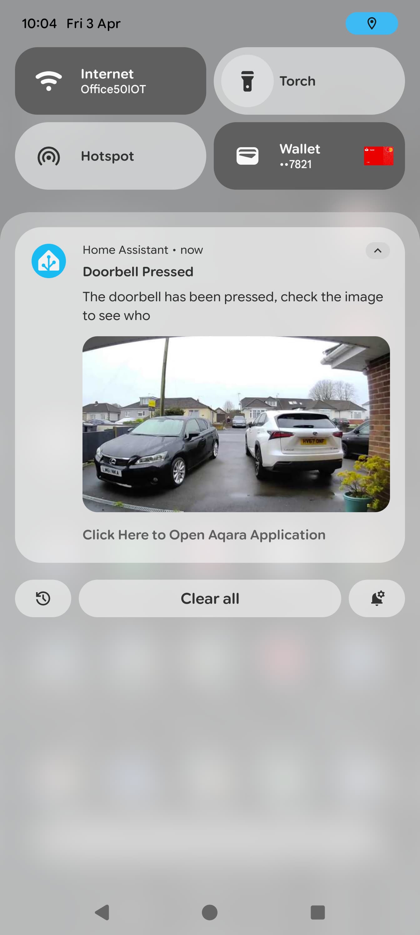

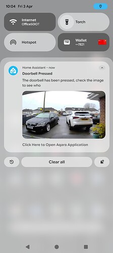

I think Aqara should study how Home Assistant does it’s notifications, they are always instant and never delayed and on android you can have nice rich notifications with images and action buttons etc…
