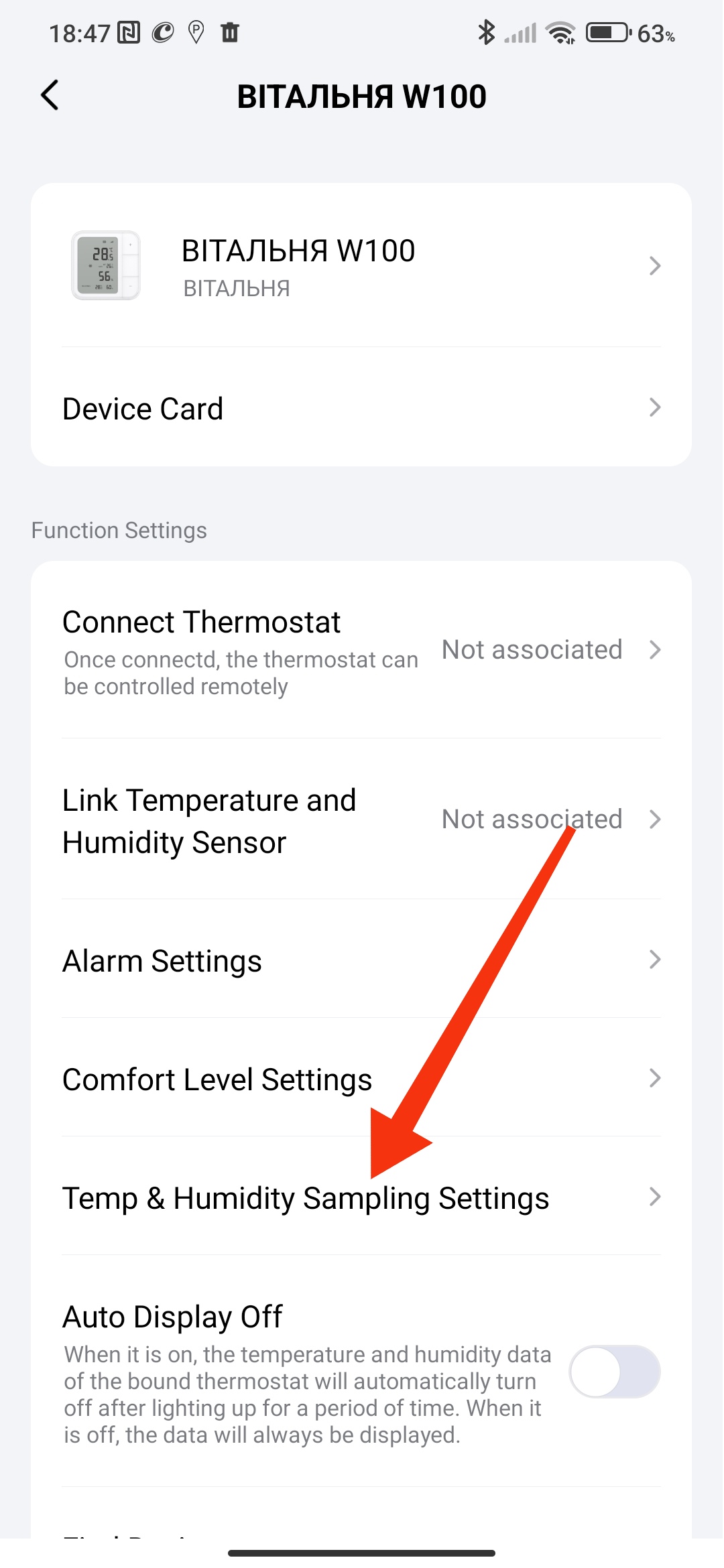

There is one caveat, Aqara gives a minimum temperature hysteresis of 0.5 °C (W500). W100 sensor, you can set the sensitivity to 0.2 °C, but in automation 0.5 °C is used.
