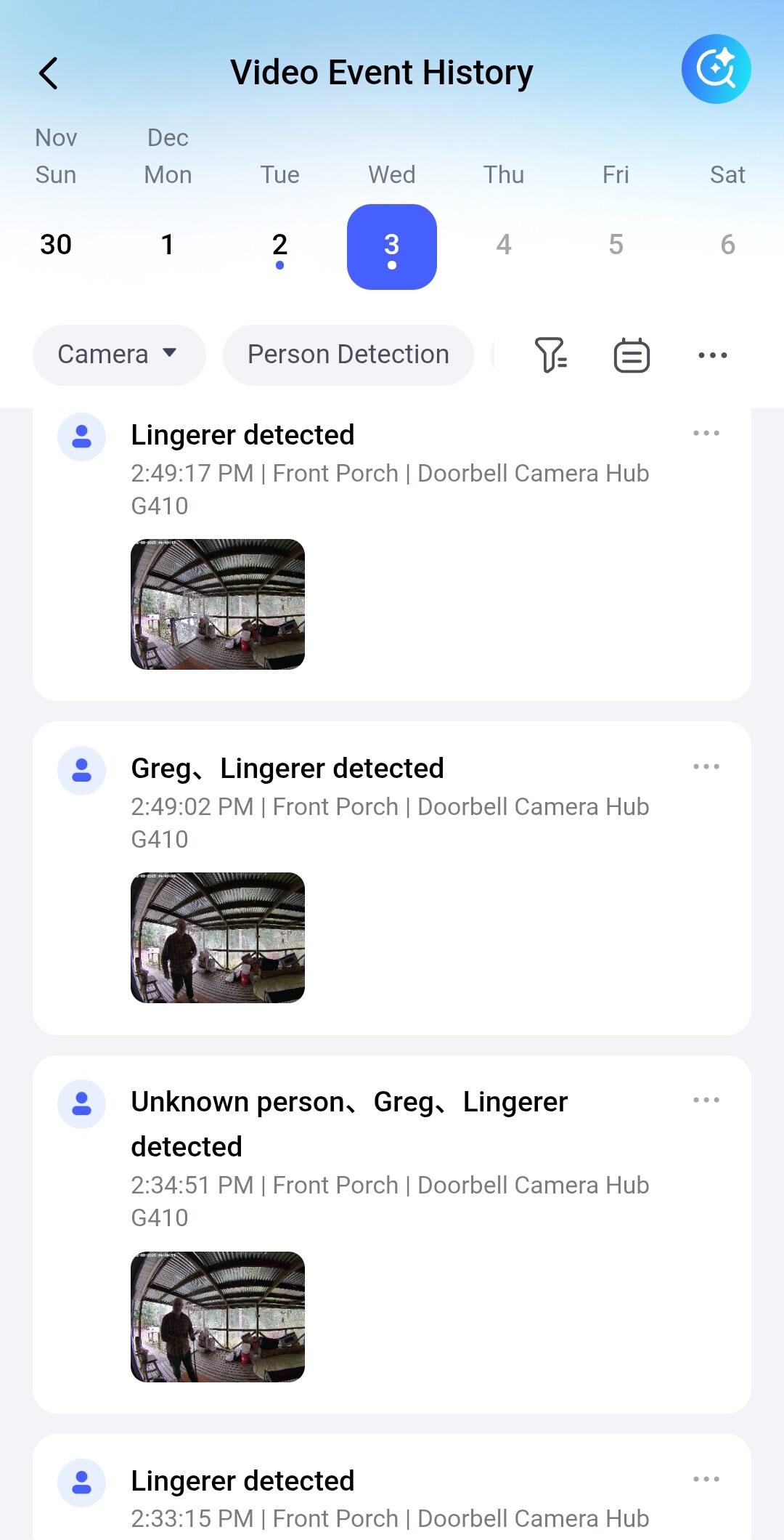

Installed 2 days ago (which was a challenge in itself.) No motion detection notifications, I’ve had 5 deliveries and my wife and I leaving and coming home twice (That’s 9 detections that should have happened that never did). Got two “unknown face notifications” (again out of 9). When a delivery this morning at 2am happened, I got another detection event that had a video of the last face detection from the previous day.

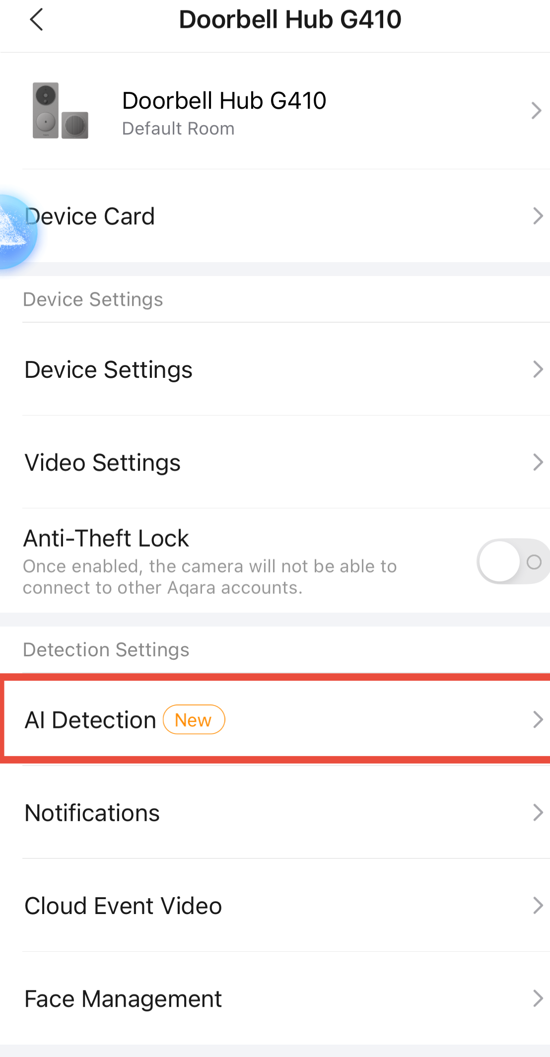

First let’s look at your detections. In the Aqara app go to the G410’s settings and click on AI Detection.
Next, go to Lingerer Detection as this is where the core motion/presence detection is set up.

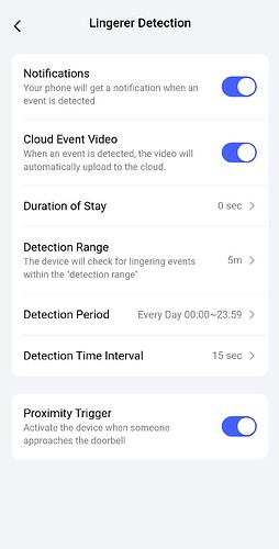

What do your settings here look like? Do you have notifications enabled? You may want to tune the duration and detection settings down to capture more. Feel free to share a screenshot of what your settings look like.

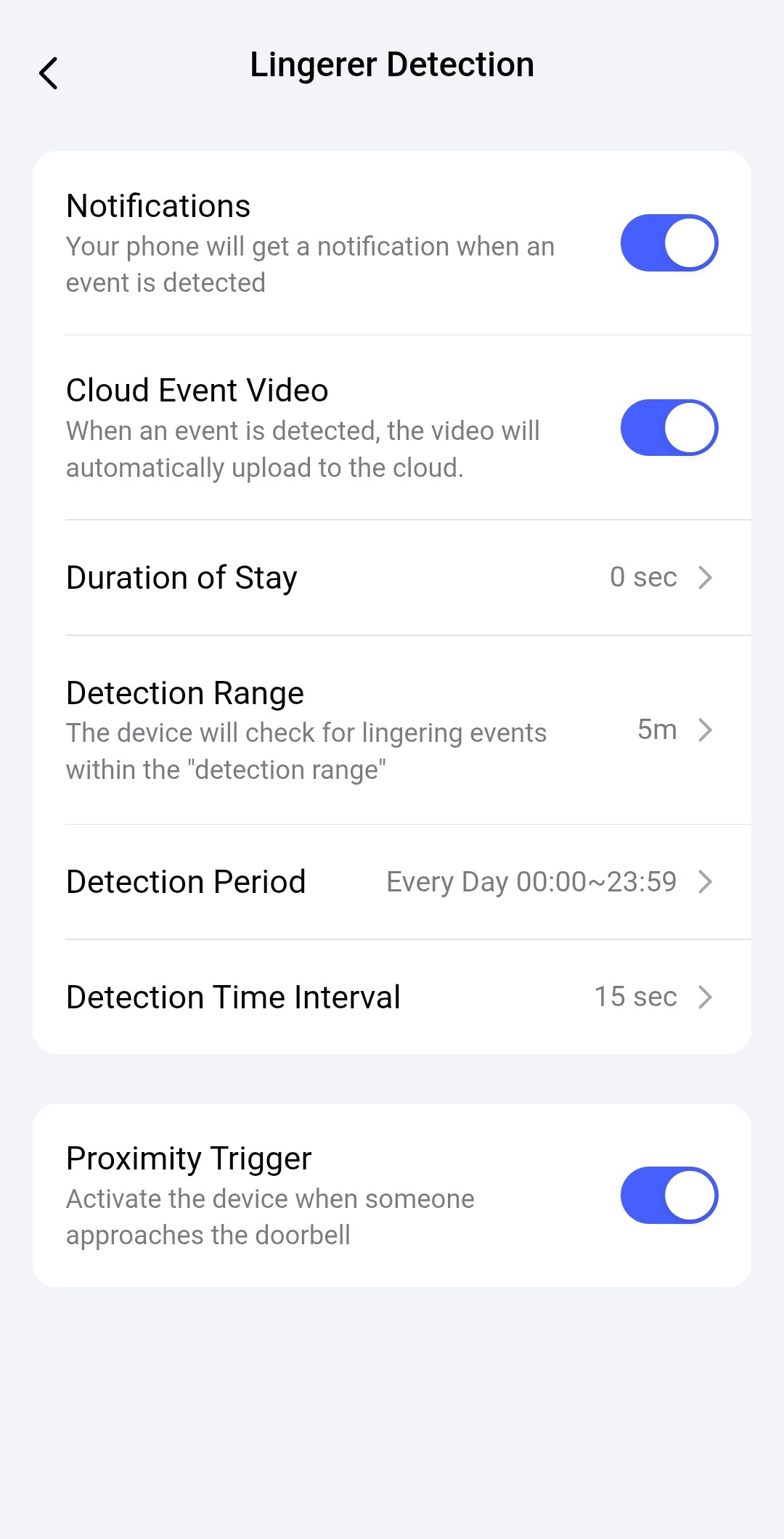

Only difference in lingerer detection is range up to 5m.

Update. Put in an sdcard. No change. I have detection at 5m. Walked at a slow pace and it announced a lingerer (terrible naming) when I was 24 inches away. I was watching myself and I was visible from 20 feet away on the doorbell camera.
You can try turning off the proximity trigger
Not sure I understand. Turn off proximity trigger to get proximity notifications?
Turn off proximity trigger to make Lingerer Detection more easily.
Maybe I’m misunderstanding what “lingerer” means. To me, someone who lingers is someone who stays around too long. That I’m not concerned with. I want notifications the second someone approaches. Not when they are .6m away, but when they are what is supposed to be the maximum 5m. Isn’t that what proximity notifications are? When someone is in the cameras proximity. I want 2 notifications. One the second they are approaching, and one when the face is detected. I should disable proximity trigger to accomplish this?

Proximity detection means it will detect intent based on someone approaching the door, not just walking past the doorbell, but towards it with the intent to knock, ring, etc… In most cases this is the behavior you do want to rule out the “noise” of passers by. But @Tech-savvy is suggesting you try to disable this and see if general detection improves for you and gets the behavior you expect.
If you’re used to Ring, the concept here is a bit different. In Ring you create zones for notifications, but this uses mmwave to detect human presence + AI to determine the person’s intentions. If they aren’t coming to the door, the doorbell doesn’t care about them (when proximity is enabled).
