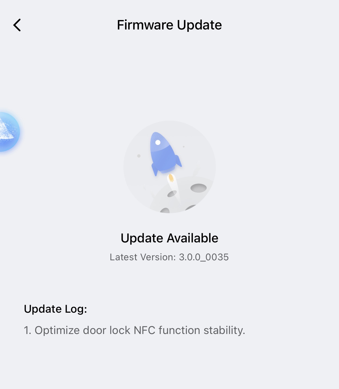

Looks like Aqara pushed firmware 3.0.0_0035 for the U100 smart lock. The official release note says it “optimizes door lock NFC functionality stability.”
