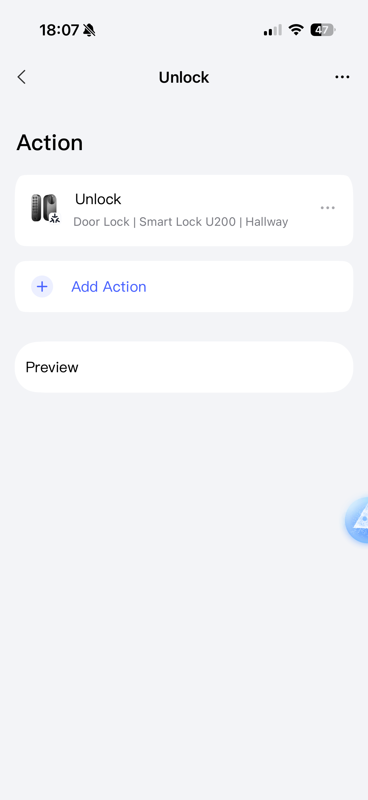

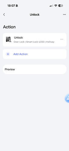

You can also make a scene in the Aqara app that unlocks the door. Then you can synchronize this scene with HomeKit (you will see this scene in Apple Home), and from Apple Home, you can run an automation that activates this scene when you come back home.

Yes, the unlock action in the Aqara automations and scenes doesn’t require face ID/touch ID. So if your HomeKit automation activates the Aqara automation, then it will work even if your phone is unlocked.

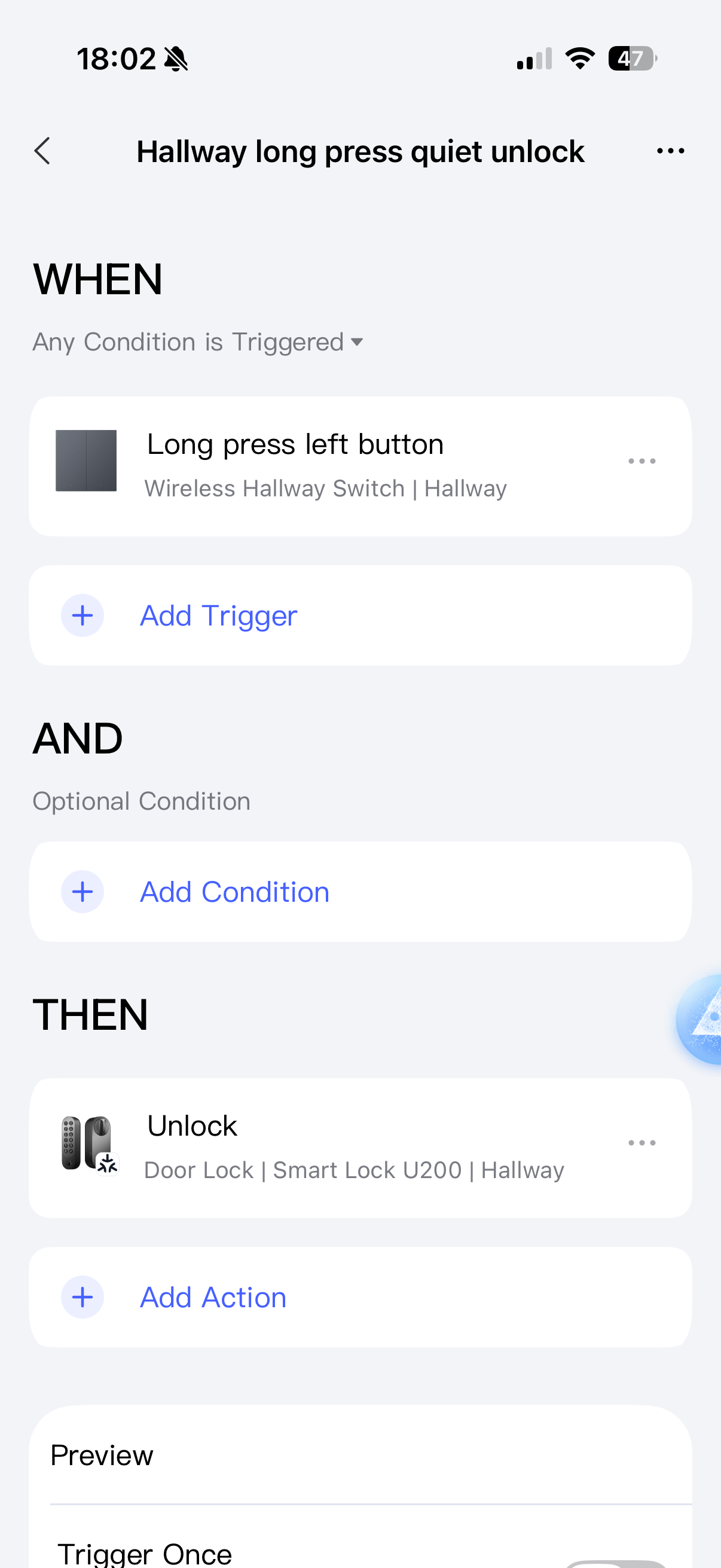

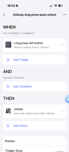

For example, I use the following automation to unlock the door from the another end of the hallway, and I don’t need to unlock the phone.

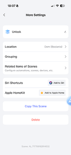

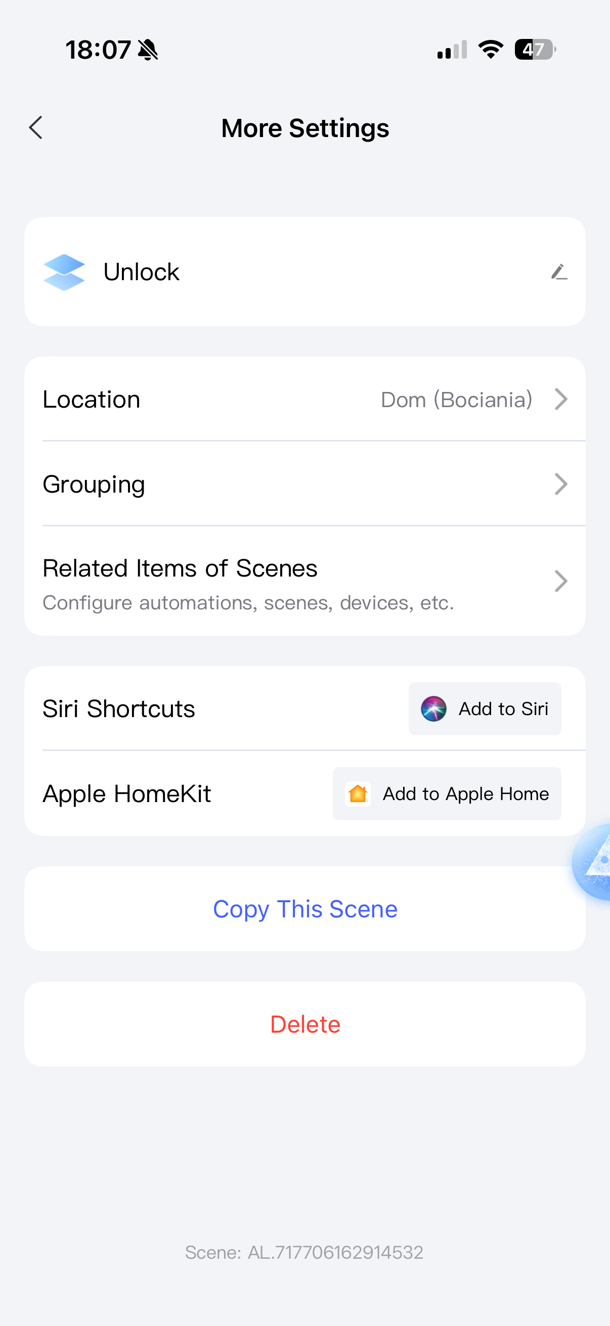

In the scene settings there’s “Add to Apple Home”. Using this button will synchronize this scene with Apple Home and it will appear just as if it was an Apple Home scene.
Then you can use it to create an automation triggered by “when someone comes home”
