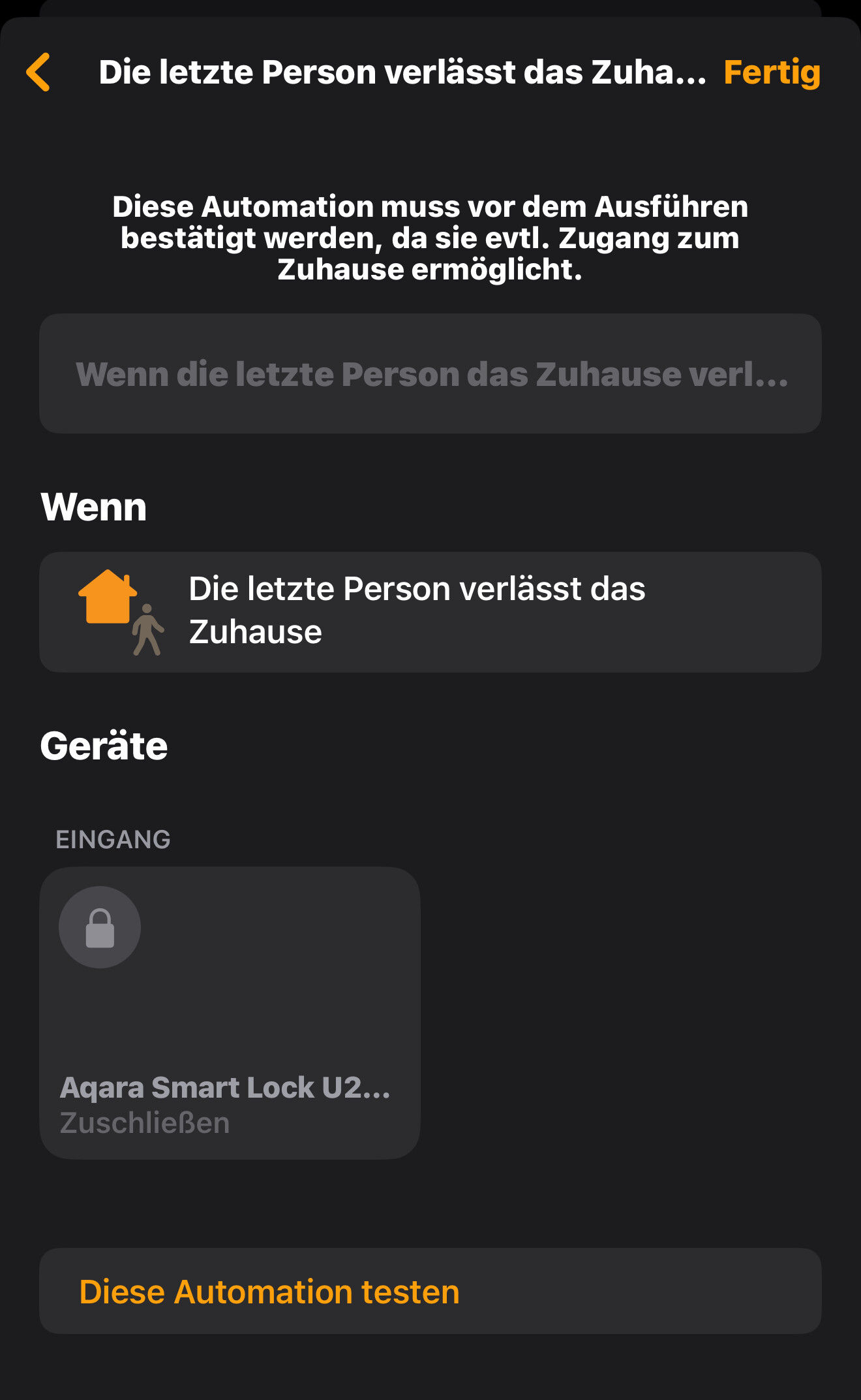

Über Homekit würde es gehen:
Ja das weiß ich. Das geht aber man muss es extra noch bestätigen und das finde ich leider schlecht. Ist wohl eine Apple Sache.
Ich dachte man kann das über die Aqara App per Automation so einstellen, dass es ohne Bestätigung geht.
Kann ich dich bitten, bei dir zu prüfen, ob das bei dir geht per HomeKit geht?

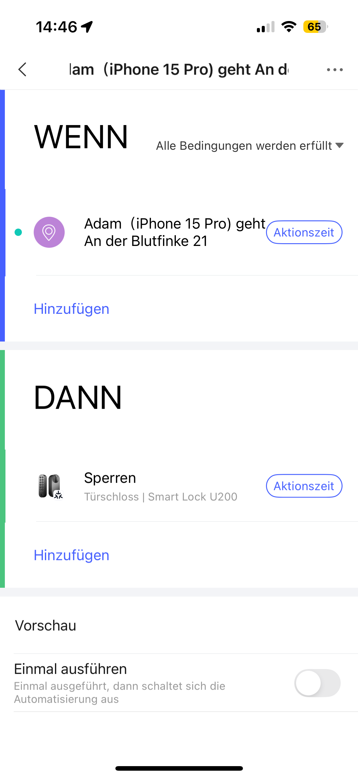

Thanks for your reply. How to set an automation when leaving home is quite easy but not if I am living with my family. Please explain how to set an automation when me and my wife are leaving home.
Please have a look at the picture. There is no possibility to add my wife within the automation.
I got out of this problem like this. I have an unused old type of Aqara relay with two channels.
1 automation made from my phone. IF I (husband) left the area. THEN turn on channel 1 of the Aqara relay.
2 automation (made from my wife’s phone). IF my wife left the area THEN turn on channel 2 of the Aqara relay.
3 Automation total for the lock. IF channel 1 and channel 2 are on THEN close the lock.
