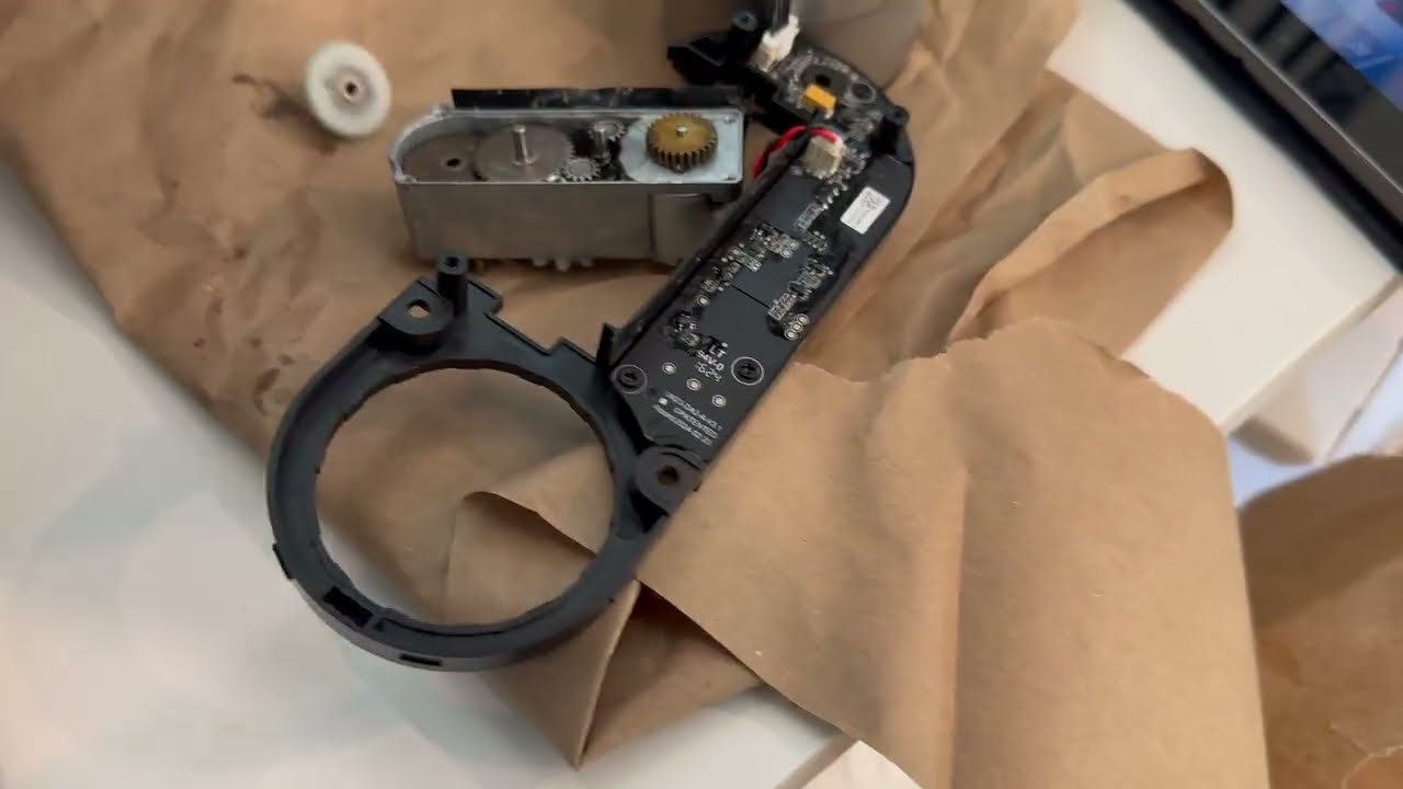

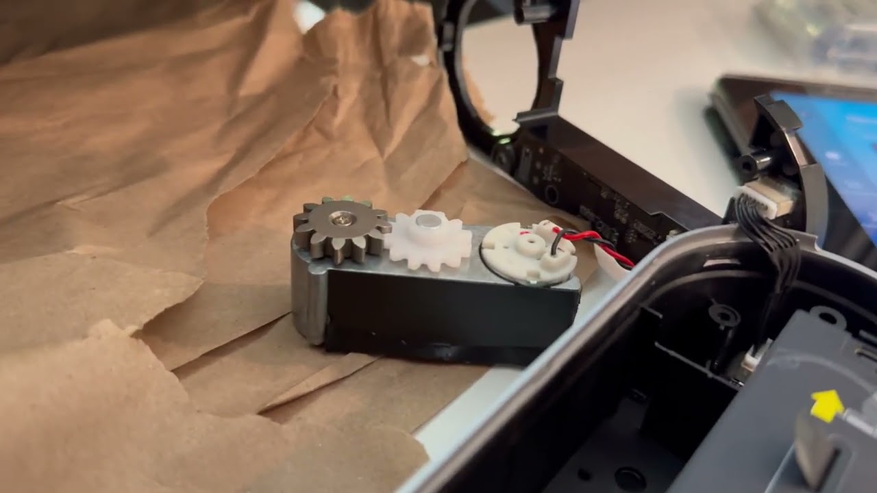

I’ve been working with Aqara support on this, trying all sorts of things and so far nothing has helped. Essentially what’s happening is that the motor is turning but it’s failing to engage with the other gears in the gear box. I can sometimes get it to work for a while, but then it exhibits the same behavior you showed in your video. I decided to give up and return the locks. It’s saddens me because it’s the only lock that supports Matter and Home Keys.
Here are some videos I created while trying to solve the problem myself. As you can tell, I was highly motivated to fix this. But no luck. I can’t tell if this is a hardware issue or a software issue.
Definitely a gearbox or wrong lubricant used so imo we need a new lock where the hardware is working.
