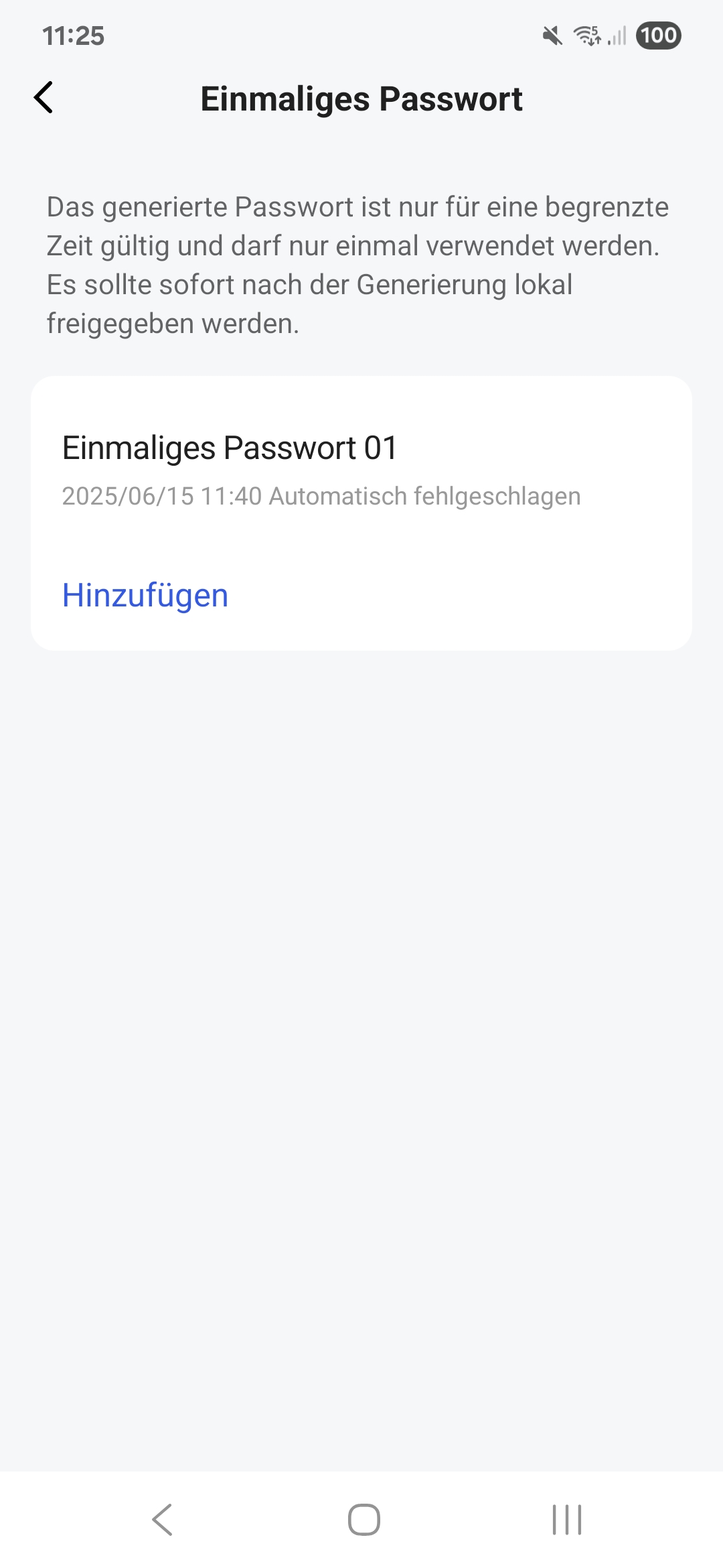

Hello,
I mentioned that I’m not able to use the one time password for the u200.

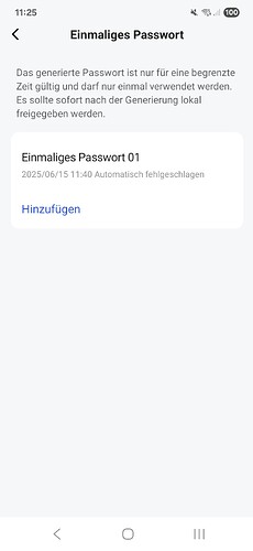

When I try to set a one time password, it shows a password which I can share but when I go back it says “automatic failed” (translated from german).
It doesn’t matter whether I’m connected via Bluetooth or a aqara hub m100…
App, hub und u200 are up to date.
Someone know a solution?

Hello Marvin,
Thank you for your feedback. Here are the details regarding the one-time password functionality:
  1. The OTP can be generated and used without requiring an Aqara Hub.
    Each code is valid for 20 minutes only; after this time, it will expire.
  2. Quick Test Suggestion
    Generate a new OTP and attempt to use it within 1–3 minutes of creation to verify the process.
  3. Troubleshooting Steps (If OTP Fails)
    Check Time Zones: Ensure your mobile device’s time zone matches that of the door lock (both should be set to the same time zone and daylight saving settings).
  4. Re-sync Devices: If the issue persists, reset and re-pair the door lock with the app.
If you continue to face issues, please share your device model and app version for further assistance.
