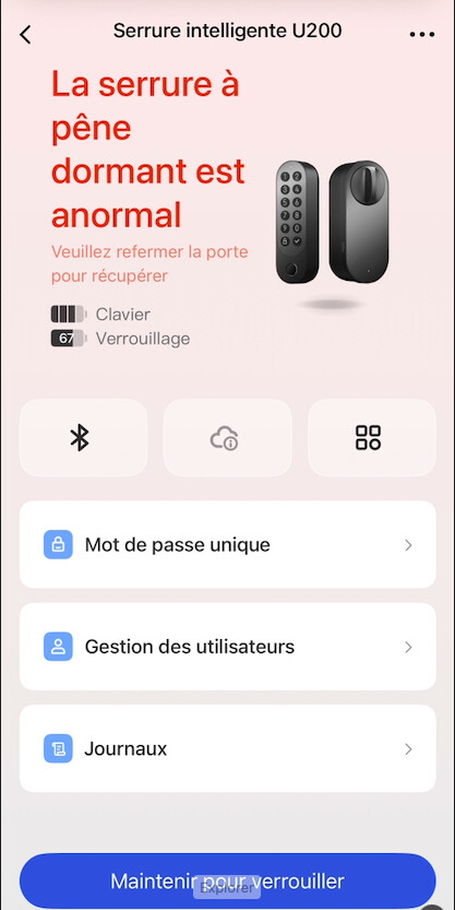

Hello,
I’m writing because unfortunately, the lock has started behaving strangely again and displayed the messages:
“Deadbolt lock is abnormal”
“Please close the door to recover.”
However, the door was properly closed. I thought maybe it was because I hadn’t recalibrated the lock after updating to firmware v81, so I attempted both a manual and automatic calibration — but that actually made things worse.
The lock began to change status without physically moving, and at times, I thought it was working — but I could hear the motor running too far when unlocking.
After at least 20 minutes of attempts, I finally managed to get it calibrated.
During those attempts, I also removed the battery to force a reboot.
I’ve extracted the latest Aqara app logs from today , as well as iOS and tvOS diagnostics .
I will send your colleague the logs for the past 24 hours — the issue started at 9:30 PM and I managed to complete the calibration at 9:50 PM (Paris time).
PS: The first logs I sent earlier today correspond to the requested period from July 4th to now. The second set of logs, sent this evening, relates specifically to the issue encountered during calibration.
I hope these logs will help you identify the root cause of the issue.
Best regards,
Hans

Hi,
Just to share my experience — I also updated to firmware v81 (beta) but unfortunately, the same issues persisted: HomeKey not working reliably, calibration failures, and occasional lock error messages like “Deadbolt lock is abnormal.”
After encountering these issues again under v81, I sent Aqara the full logs from the past 7 days (including Aqara Home logs, iOS, and tvOS diagnostics).
Following their analysis, the engineering team confirmed they were able to identify the root cause, and a proper fix should be included in a future firmware update.
However, I haven’t received any information yet about when this next firmware version will be released.
So the problem is still present in v81, but a solution is on the way. Fingers crossed :crossed_fingers:
