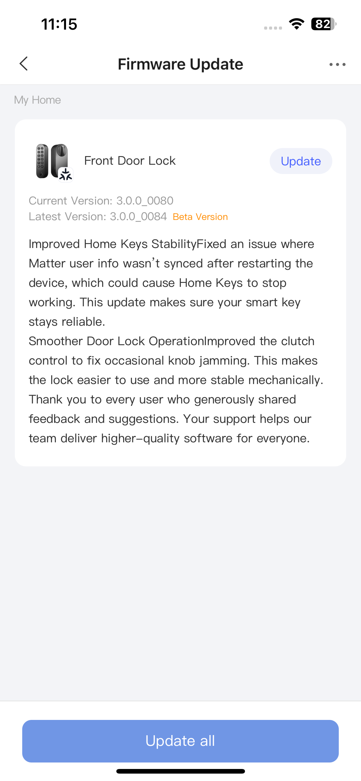

this is just nightmare, I am on beta enabled days now, still not getting any .81 or .84, stuck on v.80 and homkey is not working. can we please push this beta globally, Europe or so?
Just ask Service via e-mail to push the latest beta to your account. They were able to help me within 2 hrs.

.84 really fixes it. I got it and it has been few days. Working fine.
Feedback – Firmware 84
Since updating to firmware 84, HomeKey has been working flawlessly! :tada:
No more issues at all — everything is smooth and reliable now.

I heard from Aqara support that v84 would be generally available today, August 12th. I don’t see it yet. Does anyone else see it?
.84 is beta
Yes, Aqara Support responded that the release of v84 was delayed. I was eventually able to download the beta version and test it to see if it fixes my calibration issues. It does not. I suspect this release is mostly focused on fixing the HomeKey issues -which I never experienced.
