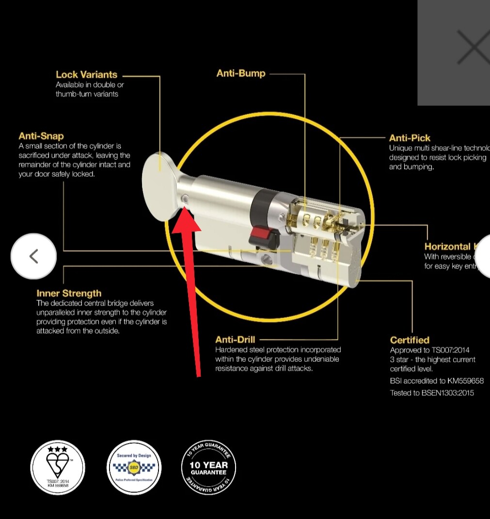

I’m looking at getting the U200 lock and I wanted to check a specific lock type before I get it. I need to replace the lock on my house anyway as it’s a new home so best to get the right one now that will work with the U200. I’m looking at getting the Yale Platinum TS007 3-Star Euro Cylinder Key/Thumbturn Yale Platinum 3 Star Thumbturn Anti Snap Cylinder Lock | YaleHome
Does anyone know if this lock will work OK with the U200? I’m not sure if the thumbturn will remove from this lock but I think it if will it should work ok as it allows entry from both sides and I believe that’s what is needed for the U200.
Any help is much appreciated.
Thank you.
For me it looks too big from the thumbturn- if it’s removable it should work
Hi, if you enlarge the picture from your link you can see the hexagon that secures the handle. If so, then the lock will fit the U200.
