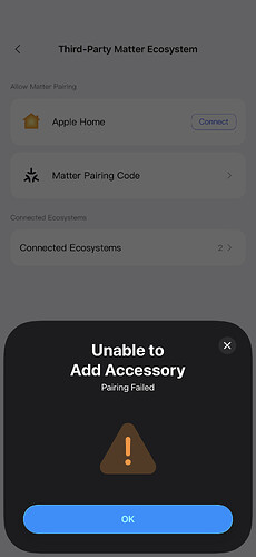

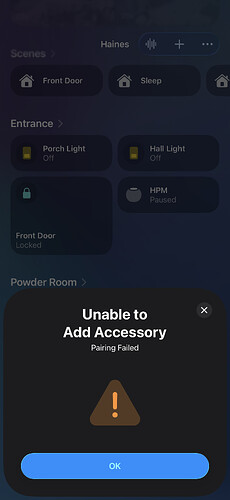

However, whenever I tried I kept getting the same screen:
I I tried to go through the Aqara home app and I got the same thing:

Unfortunately I am getting the same messages as before.
“Unable to pair”
There are no problems adding this to the Aqara app. Everything is great there.
It’s just when trying to add it to Apple home is where the issues are.
