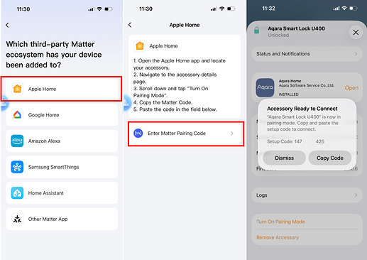

What I’m trying to do is have a Matter connection inside the Aqara app. The Aqara app tells me to:
  • Go to Apple Home
  • Turn on pairing mode for the lock
  • Copy the Matter code from Apple Home
  • Paste it back into the Aqara app
However, when I do that, Aqara fails with:
“There is no Matter controller in the current home.”
That’s the point where I get stuck. I’m adding images to make it easier to follow

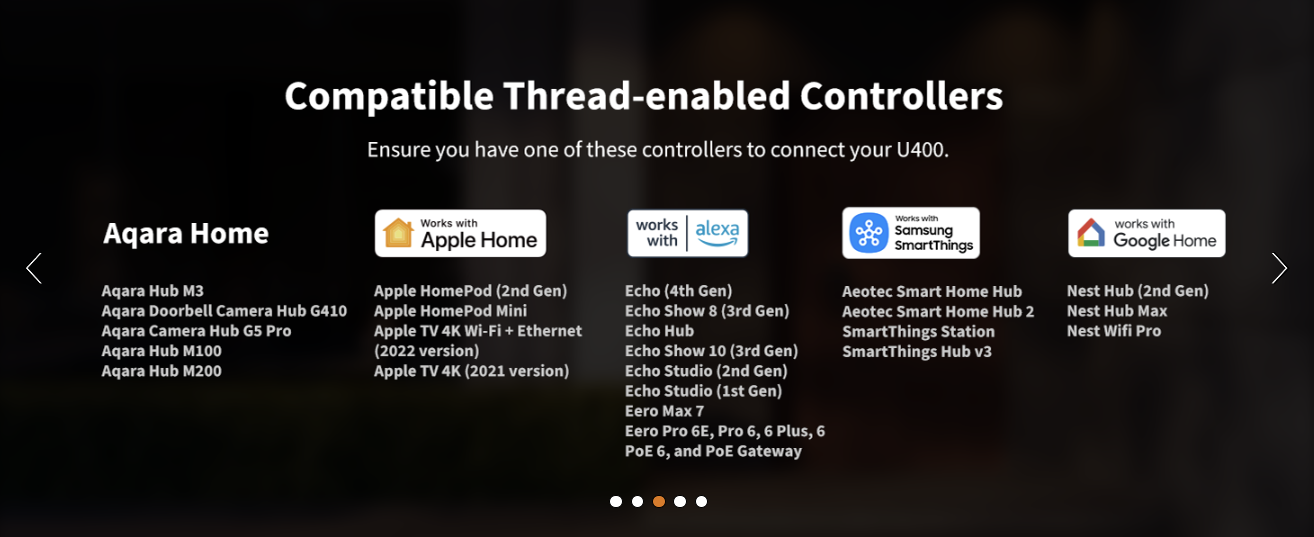

If you would like to enable a Matter connection within the Aqara Home app, an Aqara Thread-enabled Matter Controller (such as Hub M3) must be connected to your current Home.
To use the Smart Lock U400 through Matter in any ecosystem, you must have a Thread-enabled Matter Controller for that specific ecosystem. Without it, the lock will not be able to stay online or be controlled remotely through Matter.
The supported Thread-enabled Matter Controllers are following, please kindly check:

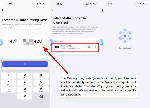

Yes, this part is correct.
But this is all really confusing. If you are saying that the only way to use the U400 via Matter within the Aqara Home app is with an Aqara Thread-enabled Matter Controller, then what functionality is being displayed in the screenshots posted by yanivfridman?
He is clearly showing that within the app, there is a screen that has instructions on joining Aqara home through sharing and another screen that shows specifically how to do this within Apple Home.
If this functionality within the app isn’t to be able to use Matter within the Aqara app without using an Aqara controller, then what is it for?
Thanks.
Dear users
Thank you for your detailed question—we understand why this can be confusing, and we will continue improving our software instructions to provide clearer and more helpful guidance.
To clarify, the screens shown by yanivfridman inside the Aqara Home app are not intended to indicate that the U400 can operate in Aqara Home via Matter without an Aqara Matter controller.
What those screenshots are actually for:
Connecting An Aqara Thread-enabled Matter Controller to Smart Lock U400
The supported Thread-enabled Matter Controller is as follows:
  1. Aqara Hub M3
  2. Aqara Hub M100
  3. Aqara Hub M200
  4. Aqara Doorbell Camera Hub G410
  5. Aqara Camera Hub G5 Pro
Check Points:
  1. Bluetooth must be enabled during the binding process.
  2. Make sure your phone and Thread Border Router(e.g. Hub M3) are under the same Wi-Fi network.
  3. Keep the distance between the lock and the Thread-enabled Matter controller(e.g. Hub M3) within 5 meters. If there are obstacles such as walls, keep the distance within 3 meters.
  4. Make sure the Hub M3 has already been added to the “Home” you want to use in the Aqara Home app.
  5. Your Hub M3 is running the latest firmware.
  6. Your Aqara account region is set to one of the supported regions: United States, Canada, Singapore, Australia and New Zealand.
    (In Aqara Home app, go to “Profile”> Settings > Region to change your environment)

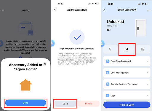

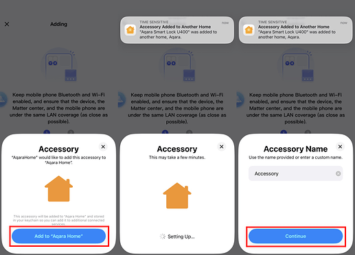

Binding procedures:
After everything is set up, you’ll be able to remotely control the Smart Lock U400 and create automations that suit your personal preferences.
we currently support the following remote features, please check:
  1. Remote Periodic Password
  2. Locking/Unlocking
  3. Check Lock status
  4. Check Battery level
  5. Automations
  6. Set Linked Devices
