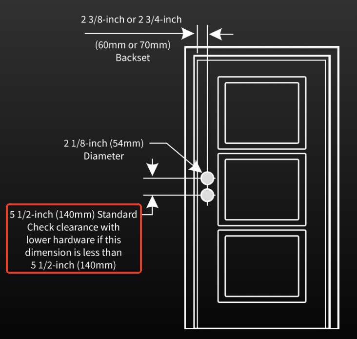

1. Clearance for installation
Please refer to the attached screenshot for the recommended clearance between the lock and the lower door handle to ensure proper installation.
