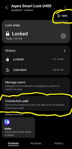

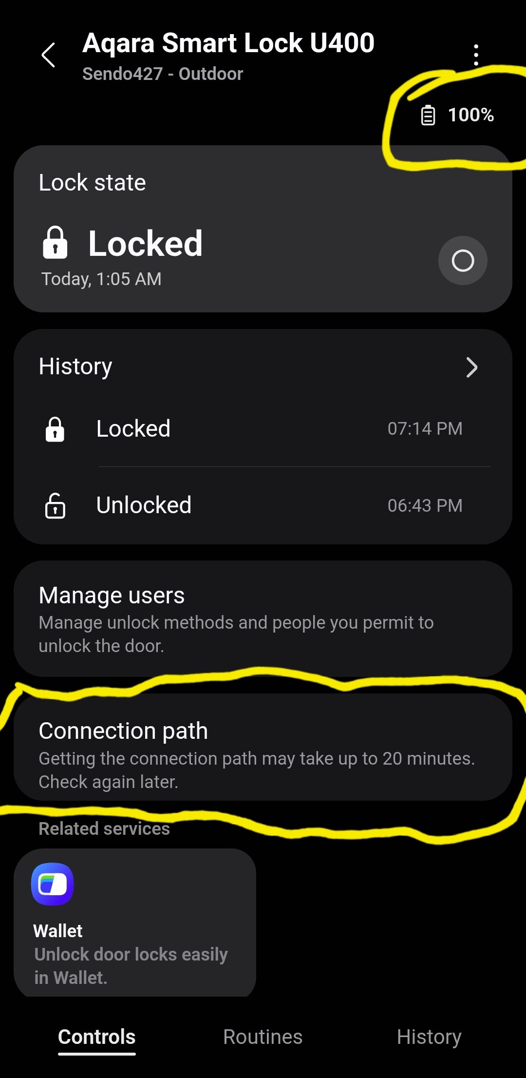

Hi thank you so much for all these suggestions, I absolutely love and appreciate it. So I have good news, I did a power cycle to my router and all my Aqara hubs and I also did a reset on my smartthings hub and everything seems to have settled in and is working so far. After resetting smartthings hub I actually got more settings to appear, like creating a passcode and I think UWB as well?. Those features and settings did not pop up when I originally had binded it to smart things. So everything looks to be synchronizing like the battery is showing the proper state of charge. The only two things that I have noticed is my auto Lock automations didn’t run because the u400 wasn’t responding to the hub and the other thing that’s still not working is the gyroscope it works for a while and then it goes back to unknown status in the aqara app I have done a couple of calibrations and I have updated the u400.I’m going to include some pictures and videos on one of the pictures there is a setting called connection path is that UWB for smartthings?
Dear User,

UWB feature in SmartThings ecosystem
We currently have not supported the UWB unlock feature in SmartThings yet. For the latest official updates and detailed information, please visit our official website or refer to the firmware update release notes.
