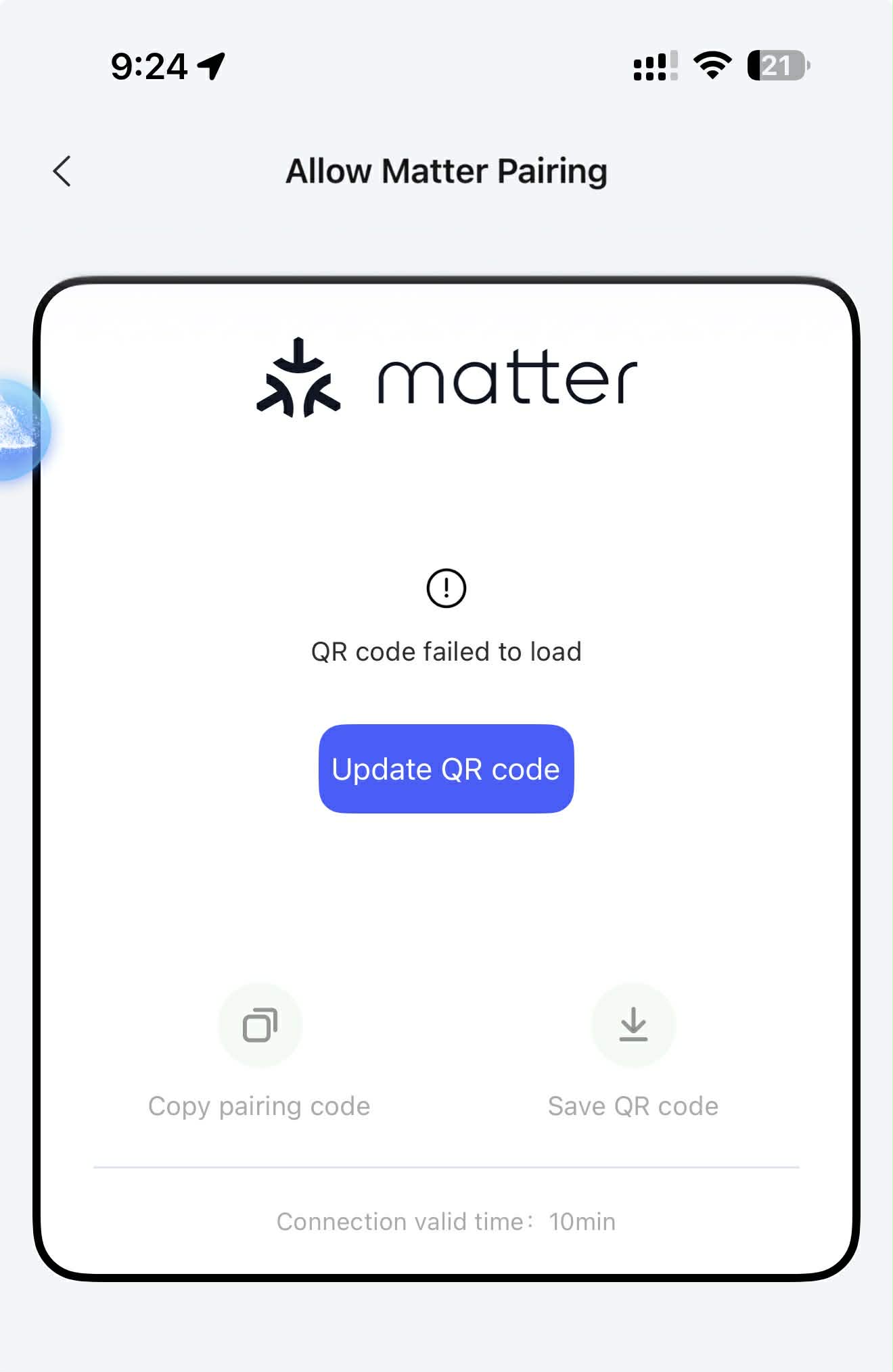

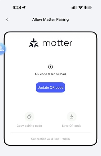

ISSUE #1 - Trying to go to the Aqara app and getting a QR code to then use to bind to Home Assistant fails with an error message. I guess this is because it is already bound via Matter to the Aqara M3 Hub (according to Claude)
Claude is telling me that because the lock’s main ecosystem is the Aquara/Matter connection that it has already connected via Matter. And that the lock is not exposed to Home Assistant via the Matter Integration in Home Assistant.

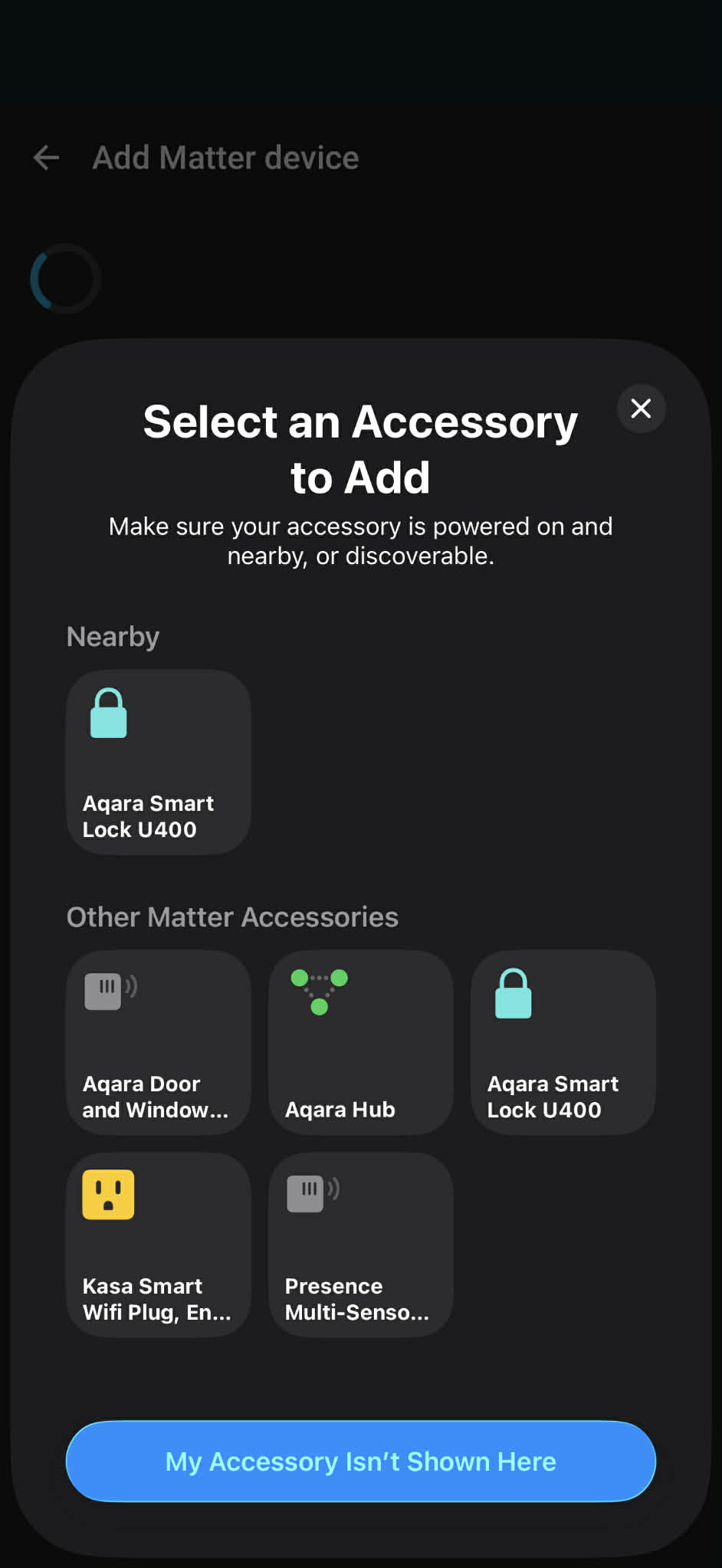

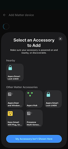

CLOSEST METHOD I HAVE FOUND is if I go into Home Assistant on my phone, to the Matter integration and select ADD NEW DEVICE and then select MORE OPTIONS…I can see my other Matter devices, INCLUDING the U400 Smart Lock. But, selecting the lock device to add never connects and gives the error “Unable to Add Accessory.”

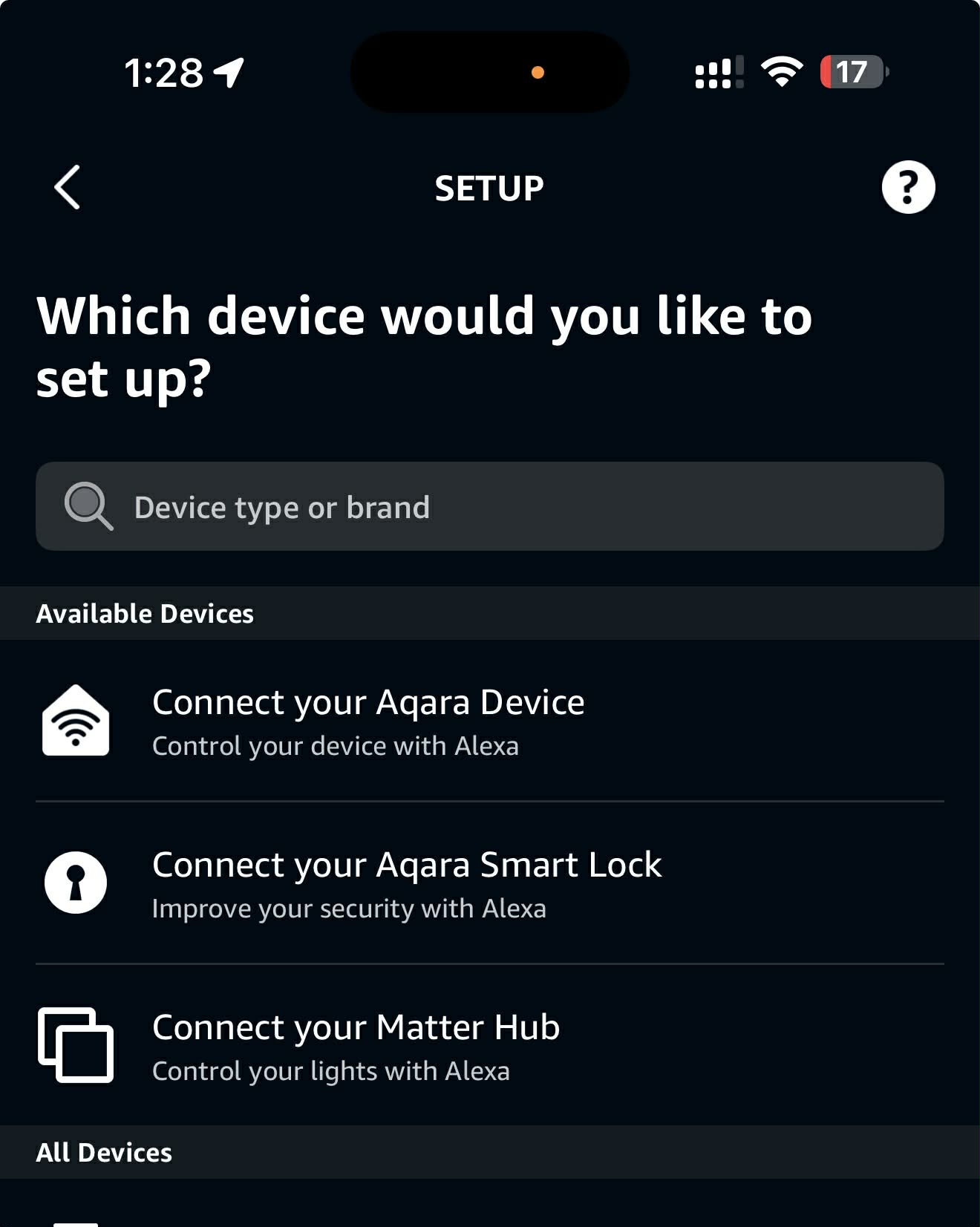

Hmmmm, and yet somehow…Alexa has discovered My Aqara Hub and Smart Lock. But then it tells me to add the devices, which then gives instructions to put the device in “pairing” mode. So, i play the game and go to the Aqara U400 lock and press the SETUP button on the back, gives me instructions provide ADMIN fingerprint, but tells me to use the APP to pair the device. #smh #ughh
Here is what I see in Alexa. I have no idea how Alexa discovered the devices.
