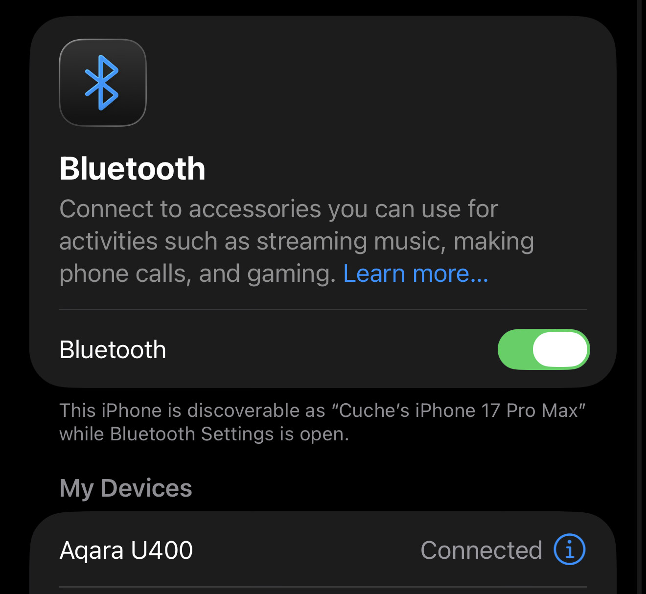

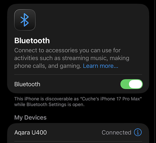

• Bluetooth on

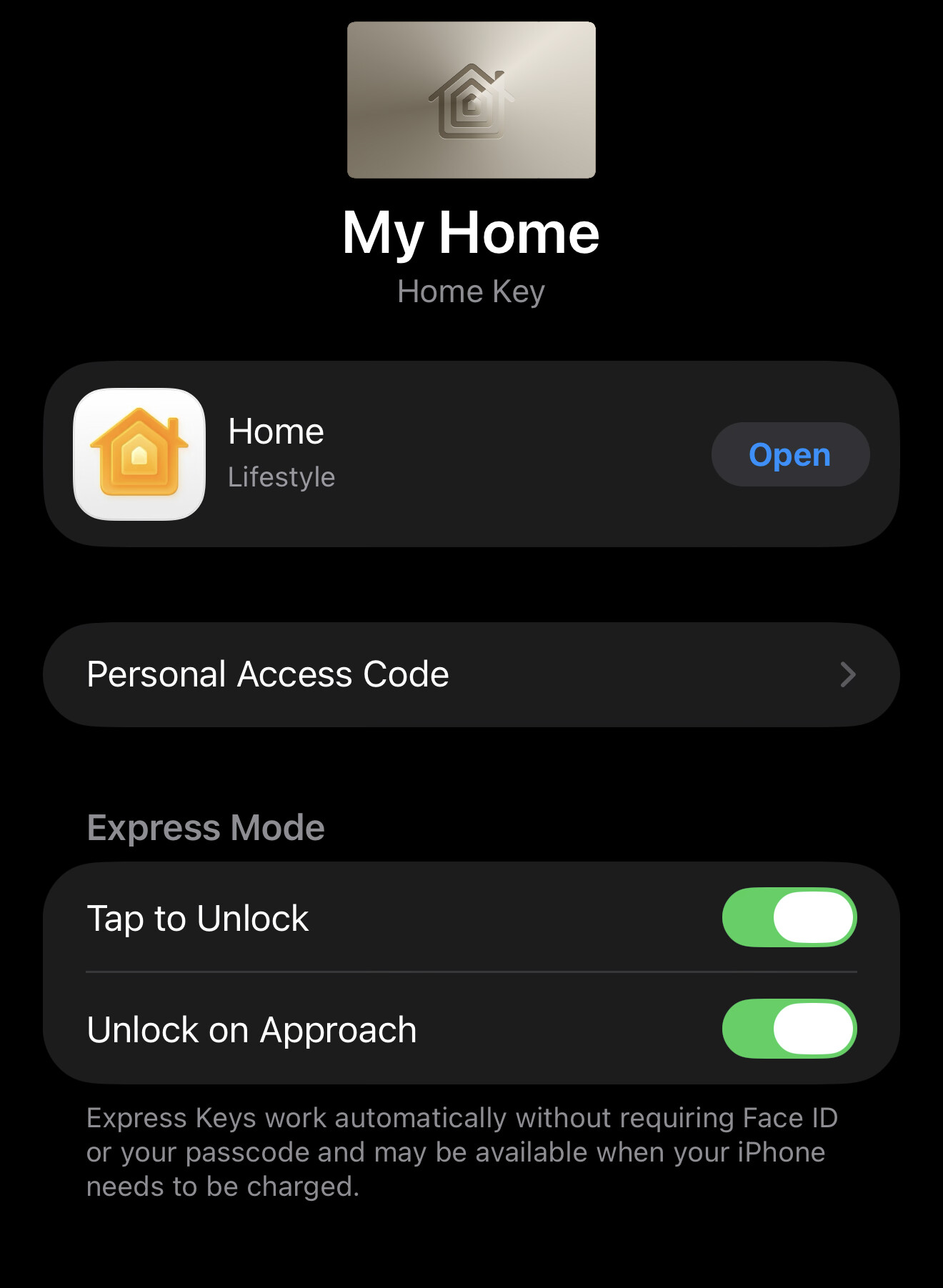

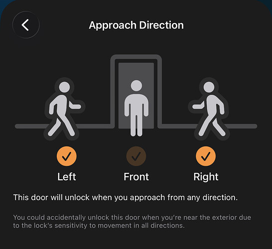

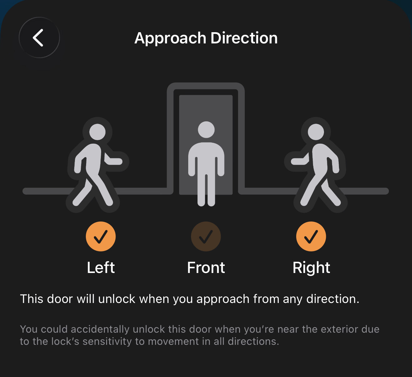

Attached screenshots show unlock on approach is enabled on my phone.
