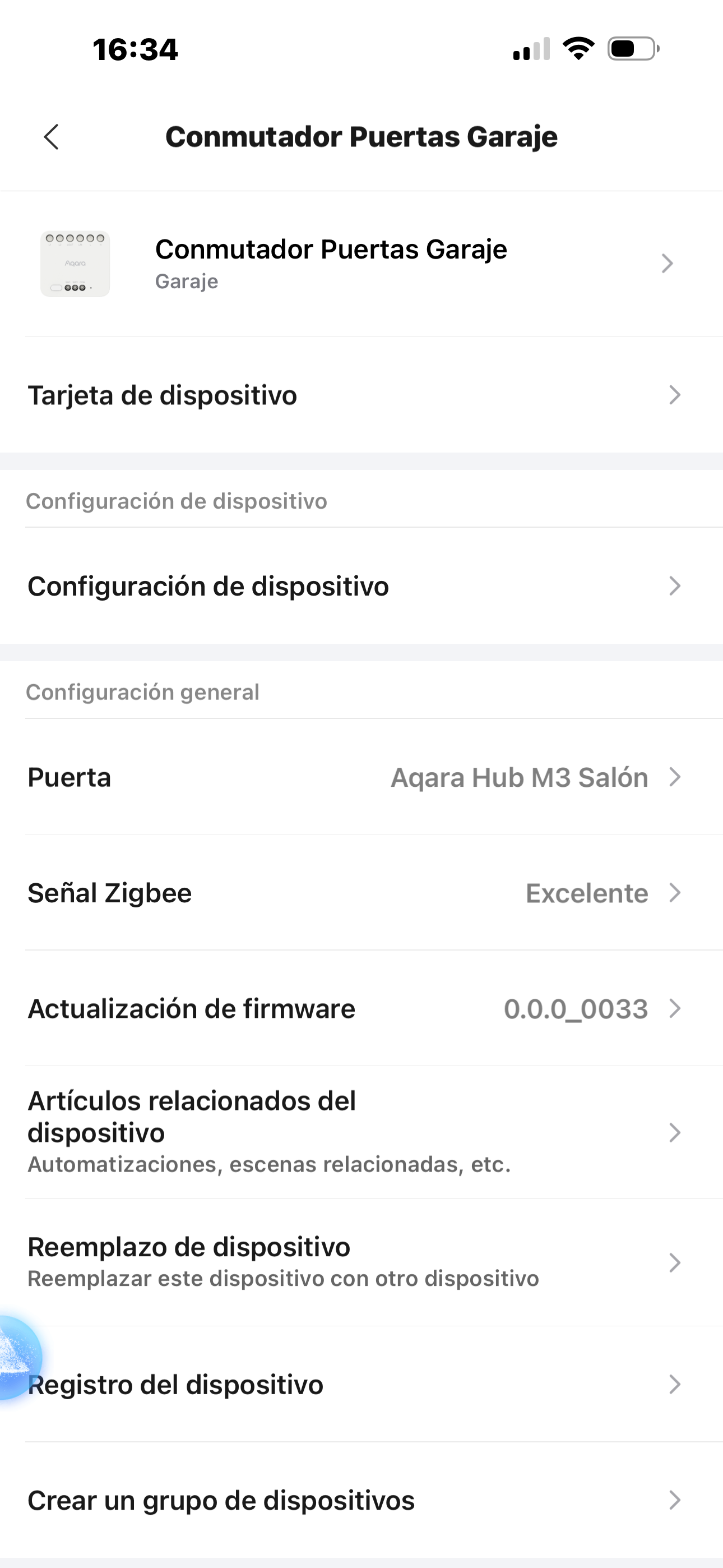

  • The Problem: The T2 Relay is forcibly exposed to HomeKit as a “Light”. Unlike their plugs, there is no option in the Aqara app to change the device type to “Switch”, “Outlet”, or “Garage Door” before passing it through Matter.
  • The Critical Risk: If I say “Hey Siri, turn off all the lights” or if the “Good Night” scene triggers, Siri cuts power to my security cameras and activates the garage relay, OPENING THE DOOR. An unacceptable security breach.

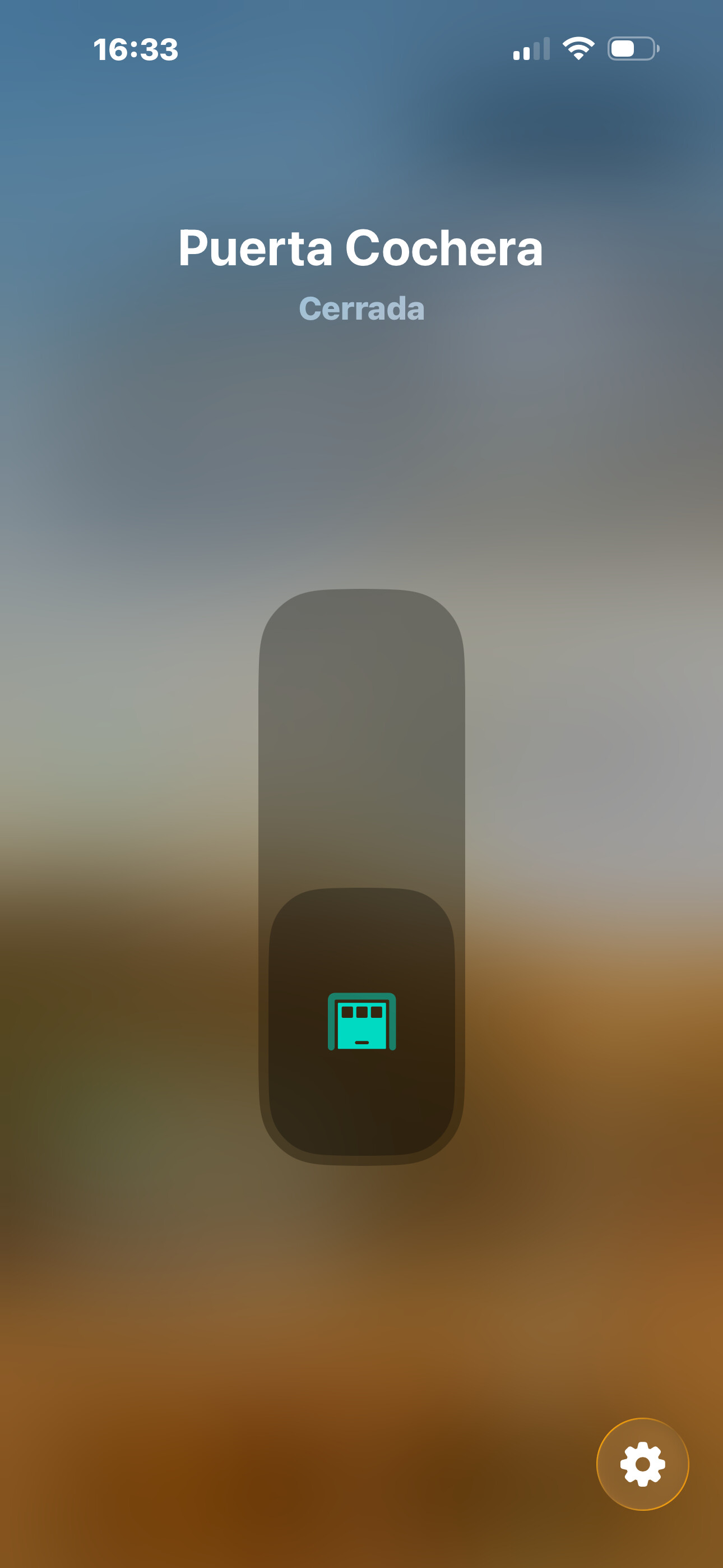

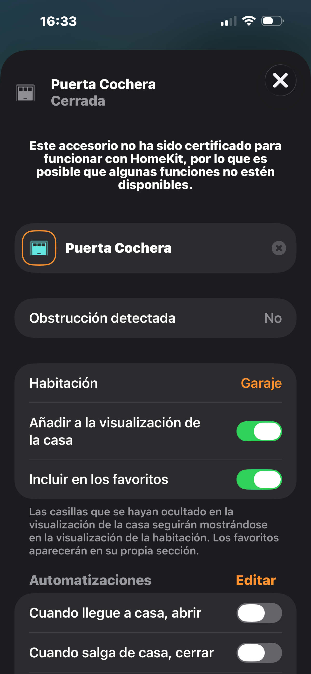

CASE A: For Garage Doors (We use cover) This ensures the correct Garage icon appears, Siri asks for authentication before opening, and it works natively with CarPlay.

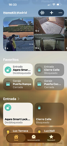

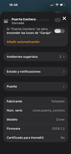

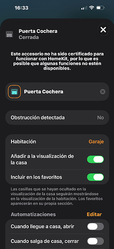

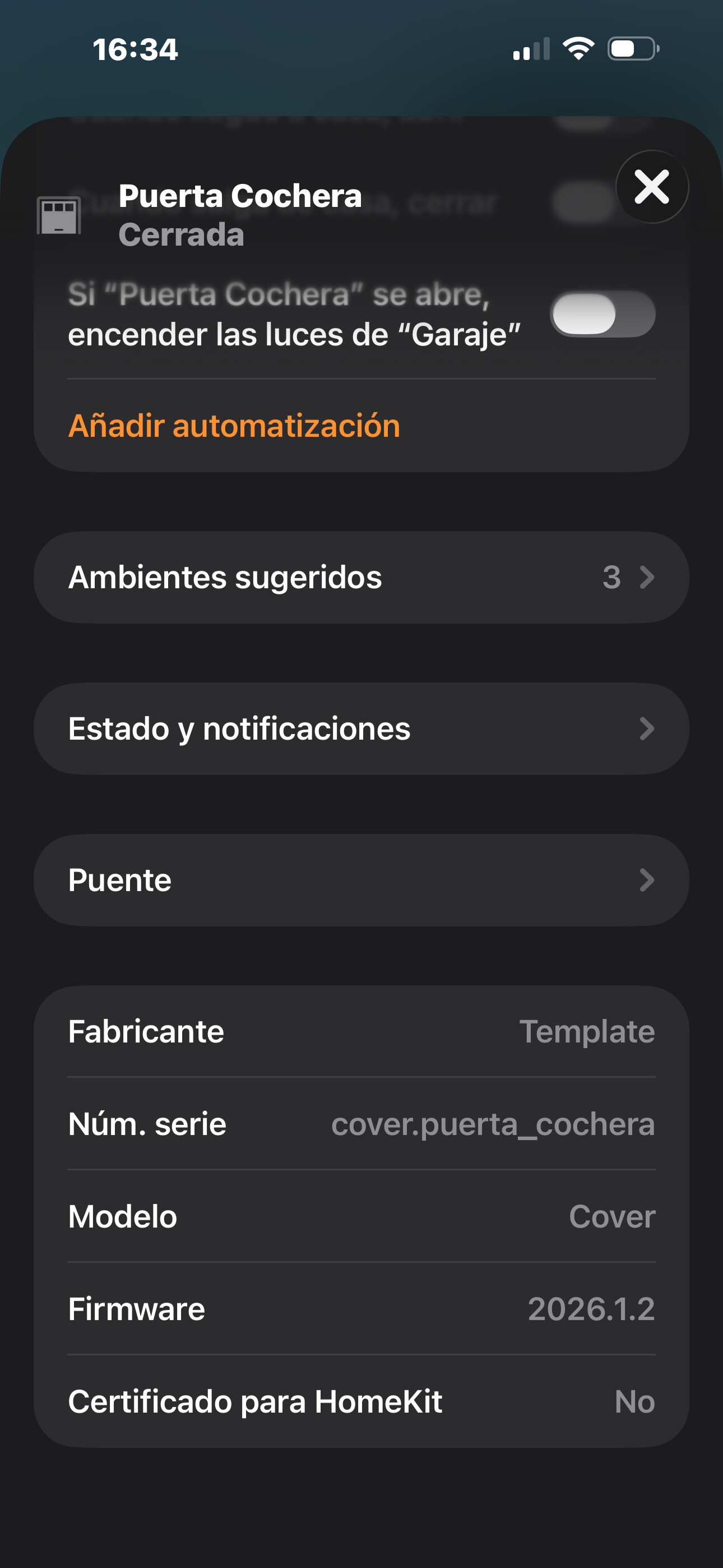

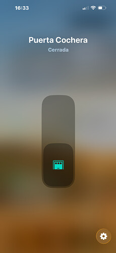

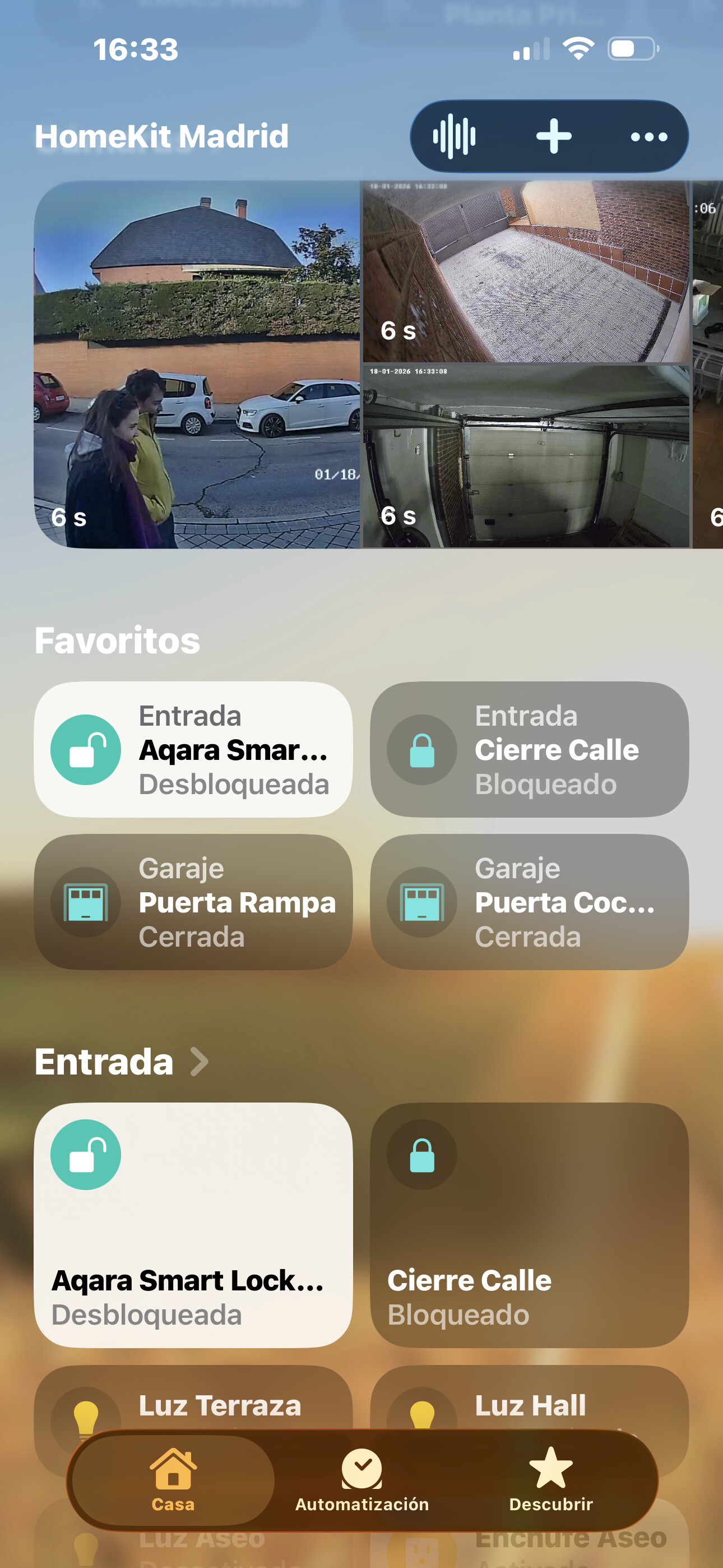

Step 3: Apple Integration (HomeKit Bridge)
By passing these new entities through the HomeKit Bridge integration:
  1. Siri Security: The garage will require authentication (FaceID/Passcode) to open. Cameras won’t turn off when saying “turn off lights” (because they are now Switches, not Lights).
  2. CarPlay: When arriving home, the “Open Garage” button appears automatically on the car dashboard.
  3. Iconography: Every device has its real icon (Door or Switch), not a lightbulb.
