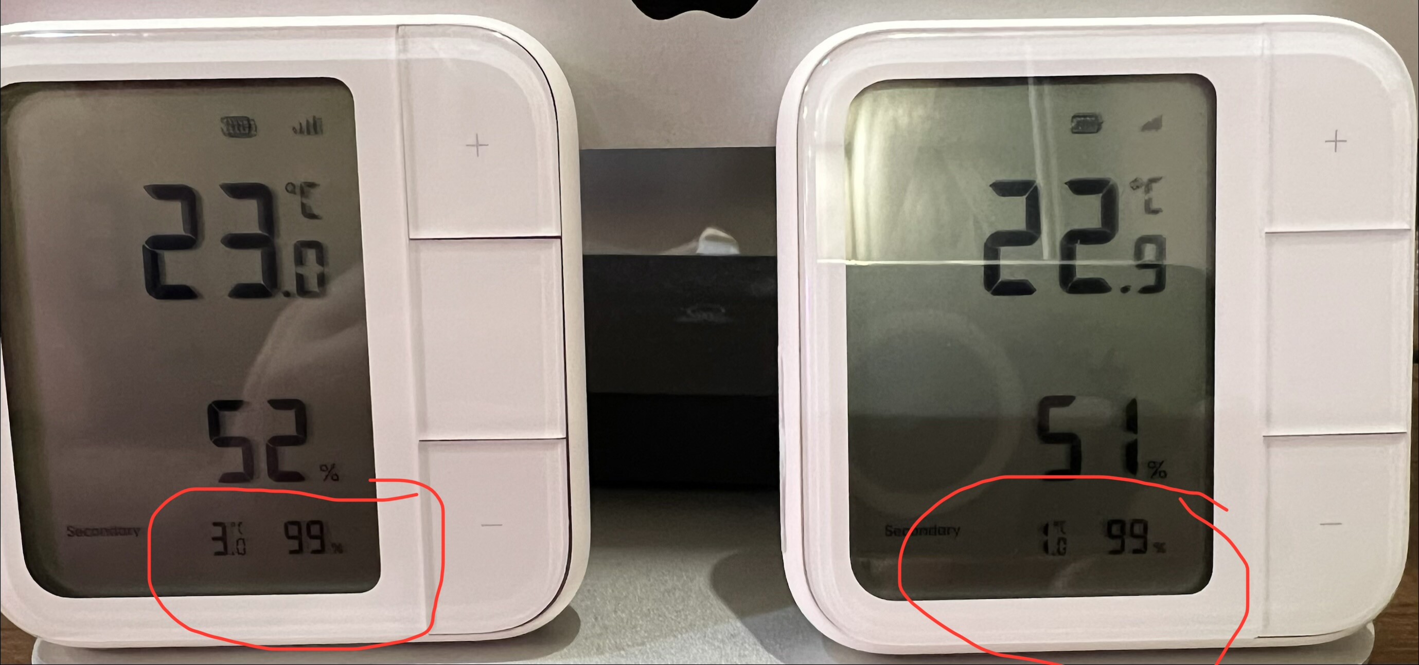

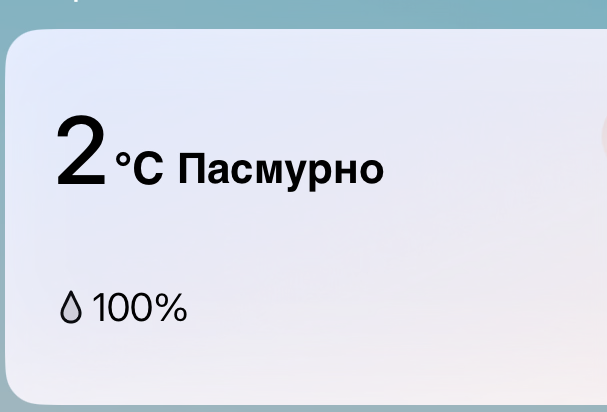

Synchronization is very bad when displaying weather data from Aqara home, the application shows +2 degrees and humidity 100%, but on one w100 shows +3 and humidity 99%, on the second w100 shows +1 and humidity 99%. As soon as M3 restarts, it immediately starts displaying weather data correctly, but unfortunately not for long.

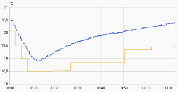

As @gafich10 said, the temperature sensor updates with a time delay or when there are significant changes in temperature. This is because the sensor runs on batteries and needs to conserve power. Sensors with a permanent power supply send values more frequently.
The upper history diagram allows you to compare the two sensor types and see how they have developed over time. The yellow line represents the battery-powered sensor, while the blue line represents a sensor with a permanent power supply.
Please note that temperature sensors are never 100% accurate. If you require such accuracy, you will have to spend a lot of money on a sensor.
Thank you guys, I know, I forgot to write that the temperature update can take half a day, and it became on the latest W100 firmware, before that there were no such delays
Okay. Strange. I have firmware version 0.0.0_1539 and the app says it’s the latest version. But I don’t have any problems with the W100. What firmware version do you have?
The same
The joke is that after rebooting the M3 hub, the data update works for a while, but then the synchronization lives its own life

None, I take data from the weather informer Aqara home app

What? W100 if T1 or TVOC is not tied to it, it takes data from the Aqara home application, that is, from the server
