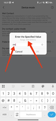

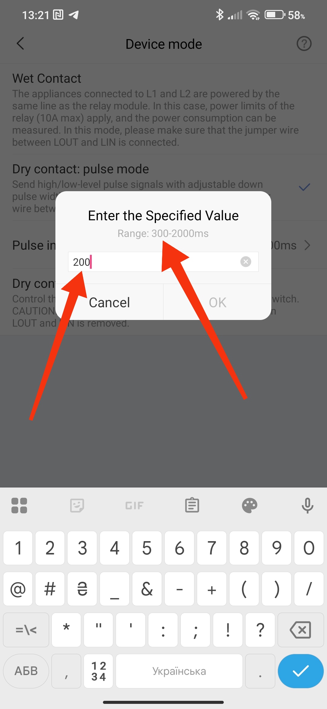

@forum6691
Attention!!!
Relay T2 is not suitable for you, the delay range starts from 300😢
Impulsion of 300 ms is also OK to command the garden gate
