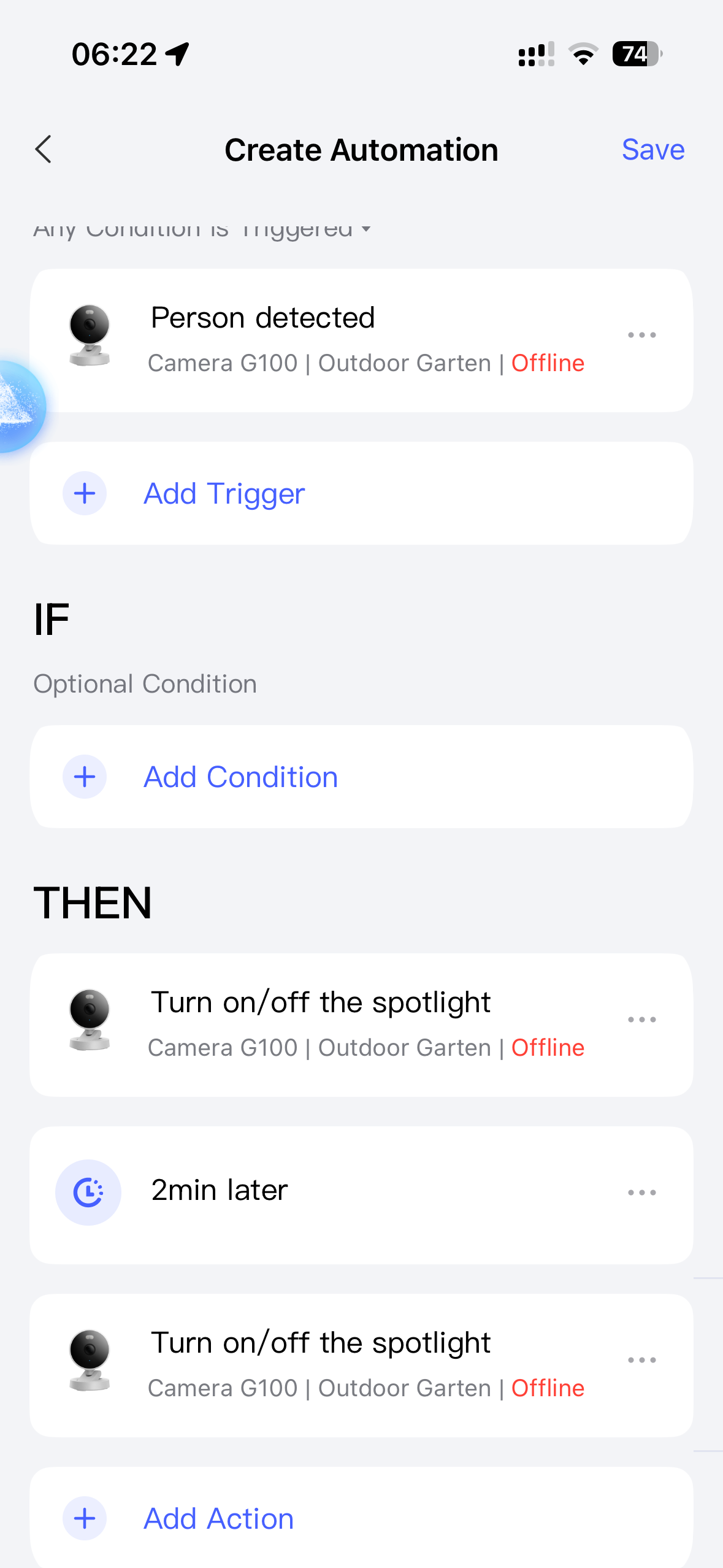

Hi , unfortunately I’m not at home and can test this automation… but this should work with a delay in automation settings
Otherwise you need a sensor like @Caroline_Zzz mentioned
Thanks - yes, that’s how I’ve set it up, with a time delay to switch off. It would be better to have an option such as ‘when no person detected over x minutes’ so the light doesn’t go off prematurely when there is someone still around. Is this likely to be a future option, do you think? This is for a terrace light exposed to a lot of wind so things move about. I’ve tried a presence sensor, but when it’s very windy or rainy it can’t differentiate humans from other things moving. However, the G100 detecting just person movements seem to have solved the problem except that the timed off sometimes cuts the light when somebody is still present.

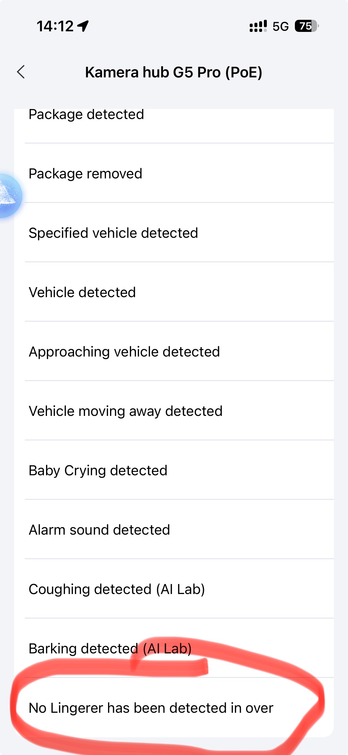

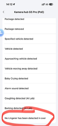

The G5 has this option you asked for - but it’s named a bit strange in my opinion
Thank you - as you say, the detection of ‘non-lingerers’ is strange phrasing but I’m sure it’s what I need. This feature isn’t available in the G100, so I I’m hoping for a response from Cifer as to what camera I need- If it’s only the C5 then I’ll get one, but I want WiFi not PoE so will wait for confirmation of what models detect ‘non-lingerers’

As far as I know, the PIR sensor on the G5 Pro camera activates both the recording function and AI image interpretation. Depending on the settings, the AI image interpretation then determines whether to discard or keep the recording, send a notification, or start an automation.
You cannot select the sensor directly for automation. Only as shown by DEChrisE in the screenshot (e.g., when a person is detected or is no longer there). Which, in my opinion, is just the AI interpretation of the image. If there were another option for the PIR sensor, I would personally use it, but there isn’t one at the moment.

Follow up- I’ve just bought a G5 and have installed it so that my terrace lights come on when a person is detected. I’ve just used a delay function (1 min) to turn them off again. It seems very reliable with no false positives so far. The ‘lingerer’ option doesn’t seem to work, but I’m happy with the timer option. This works much better than the presence sensor I had before, which was too sensitive to non-human movement, wind and rain. The colour night vision is amazing on this camera, by the way!
