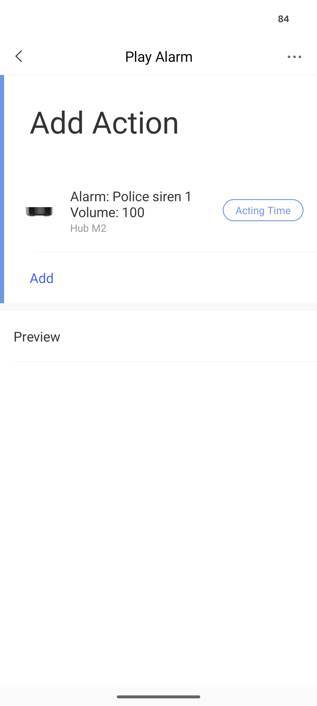

Aqara supports HomeKit or Matter to expose the smart devices as entities in Home Assistant. Or any other system that supports them. But in the past this was quite limited. For example, Alarm system could not be triggered.
Now the new functionality that support exporting any Scene or internal Aqara automation as a Matter entity works great. It involves multiple steps to get them done but works great. Add a scene and expose it in the “Connect to Ecosystems” page in your profile.
Then a switch will be exposed to Home Assistant and that can be used to trigger alarms manually.

Manual triggering via a Home Assistant switch is a practical use case, and the screenshot adds clarity. It’s always valuable to see real-world setups, so thanks for taking the time to share! If others have tried this or have tips to refine the process, feel free to chime in—community insights like this make the forum a great resource.
