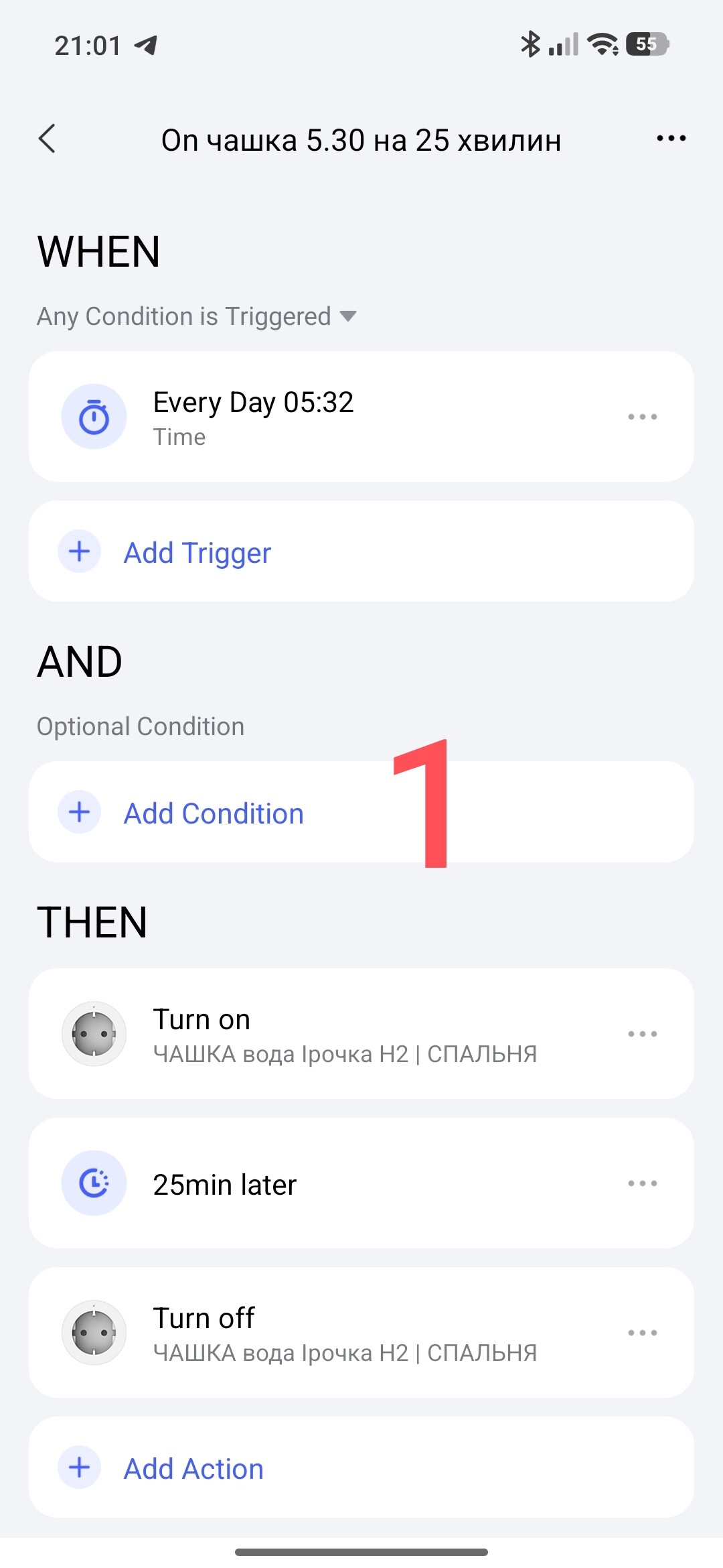

I purchased an office cup warmer. So that the water was at the right temperature at the moment of waking up, I connected it to the H2 smart socket. I set up an automation scenario: the socket turns on and off at a specified time.
Fig.1

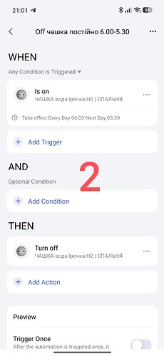

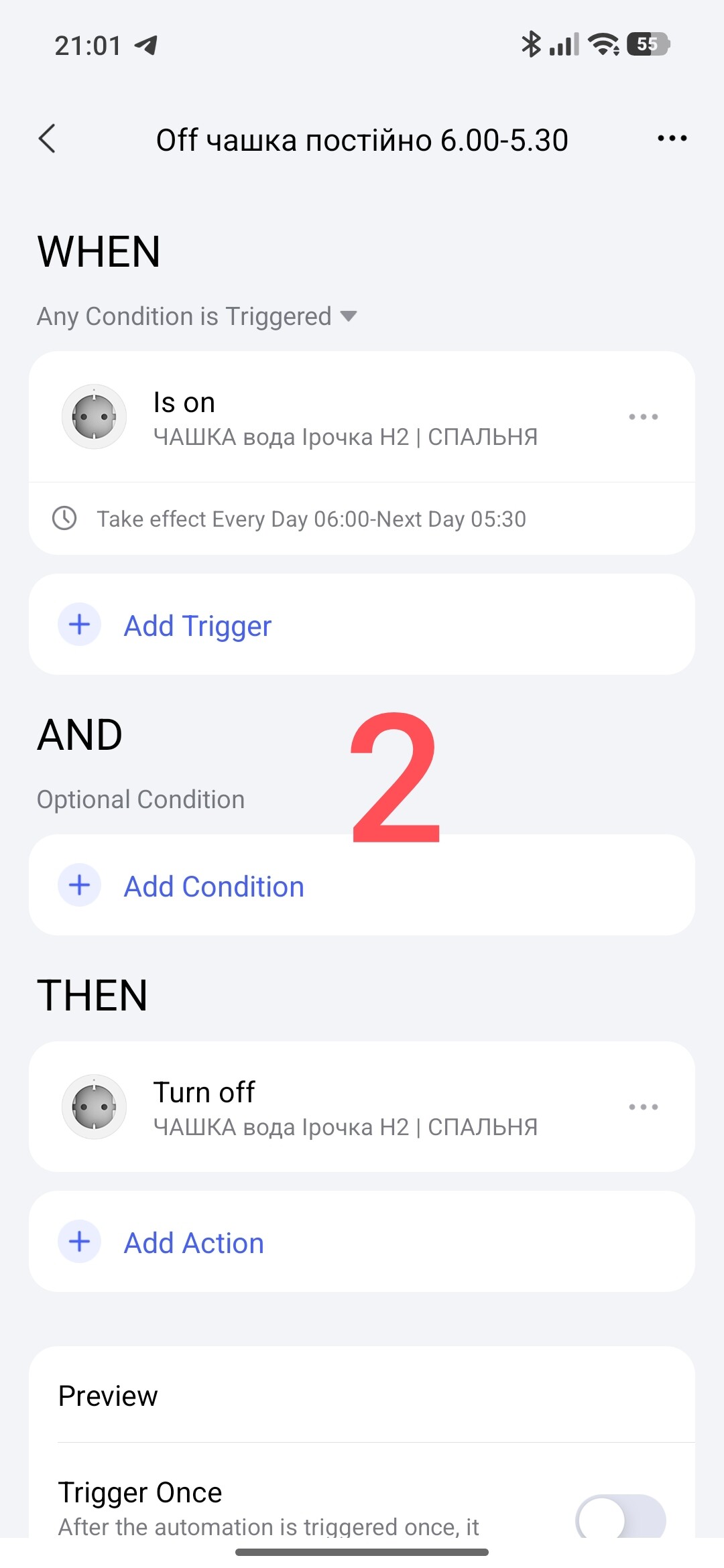

Time limit: I created an automation that automatically turns off the outlet if someone tries to turn it on outside the set morning schedule.
Fig.2

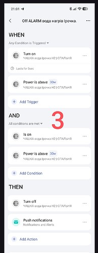

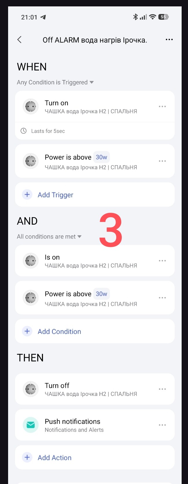

Power control: I set up protection based on current consumption (over 30 W). If the power exceeds the norm, the outlet instantly turns off, and I receive a push notification on my phone.
Fig.3
