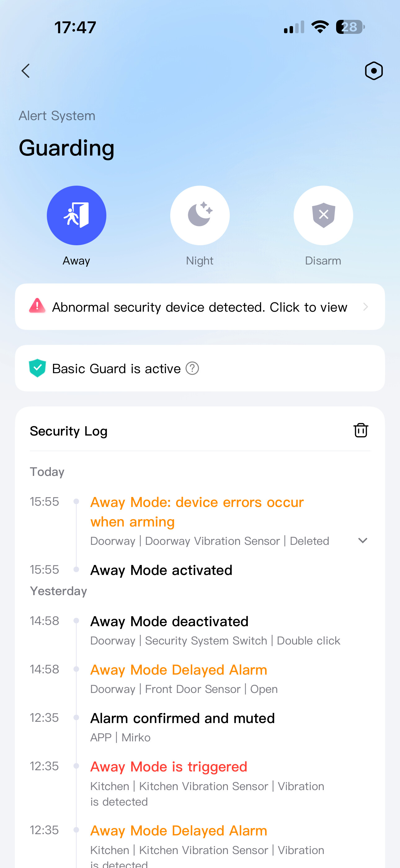

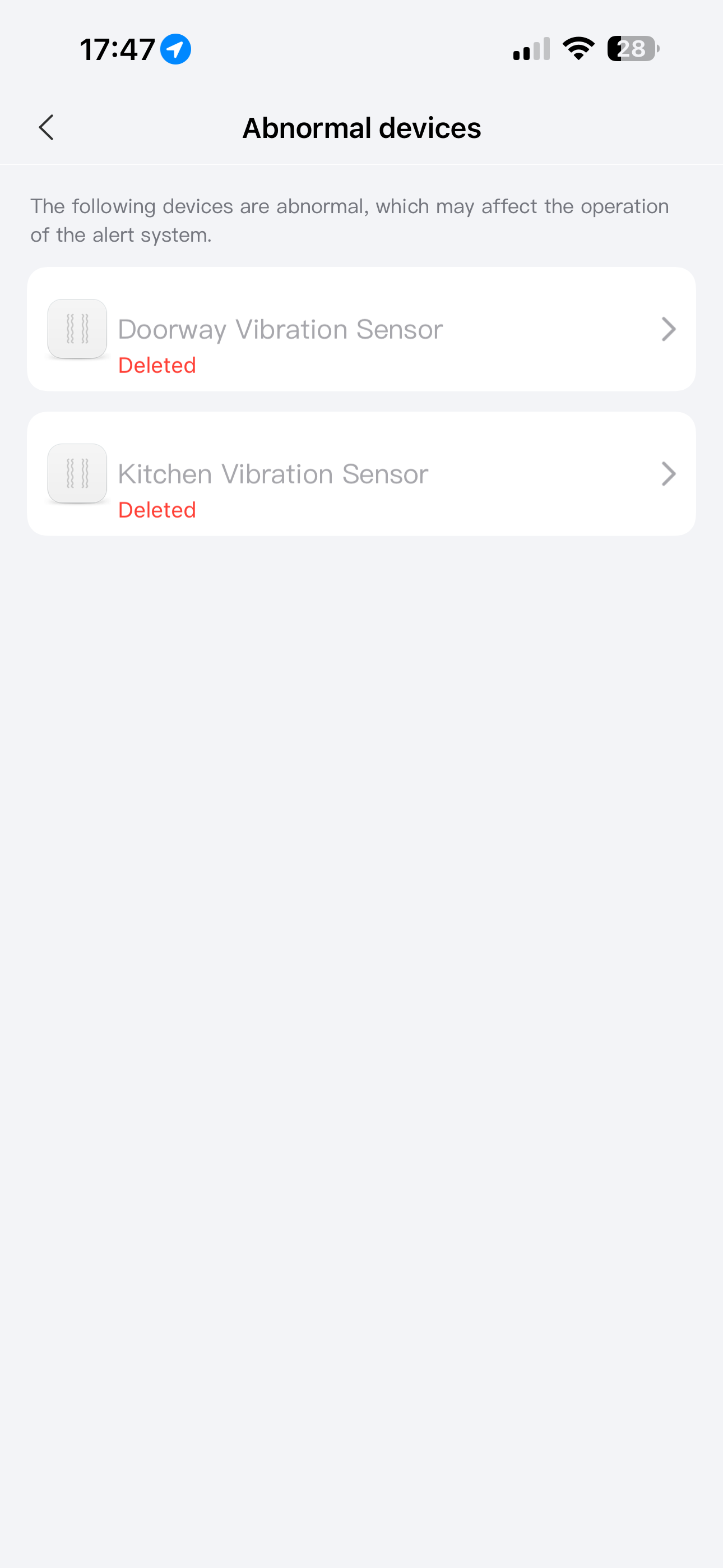

I have replaced 2 of the vibration sensors with T1 version (deleted the old ones and added the new ones) but they still appear in the Away alarm settings and are triggering abnormal device notification.
How do I fix this?

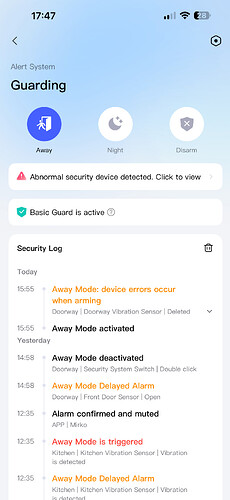

How do I fix this?

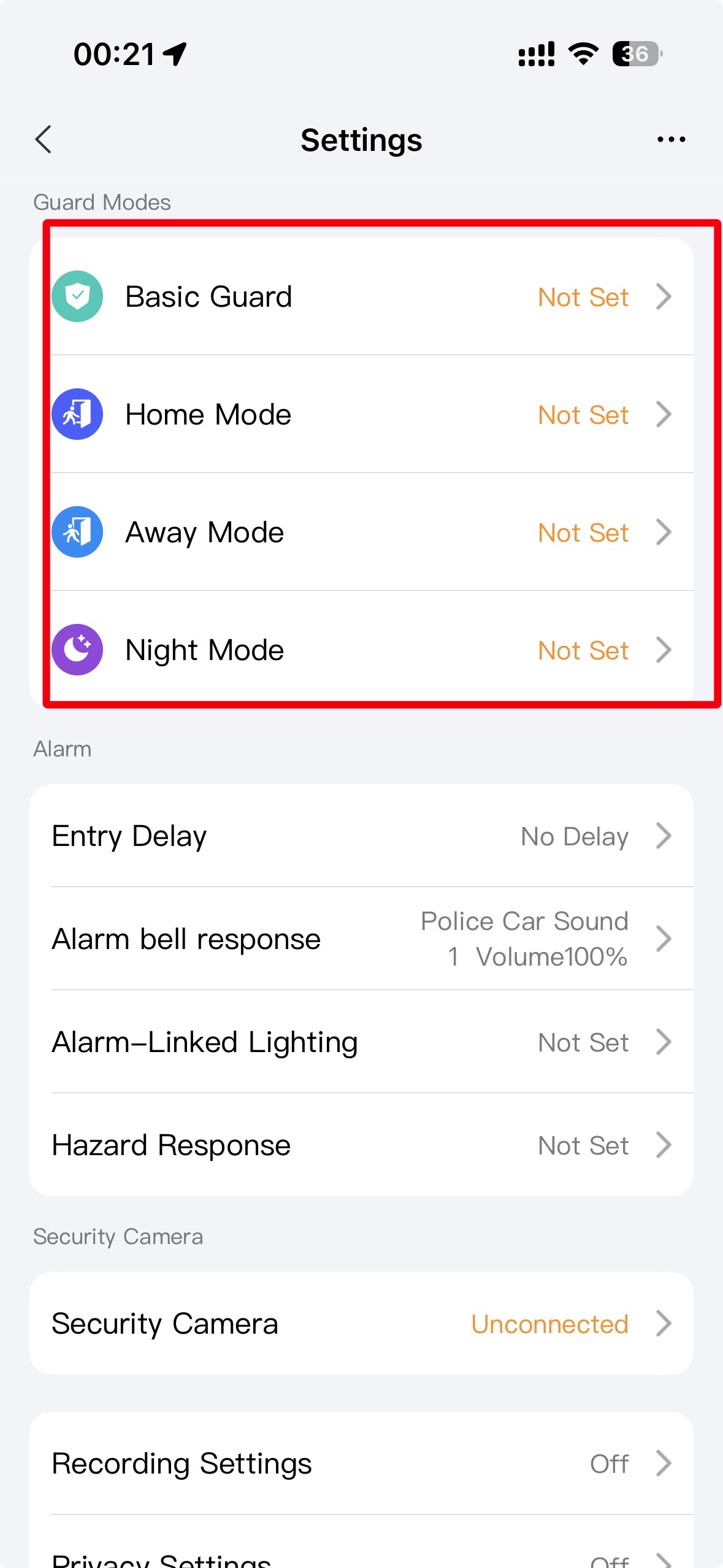

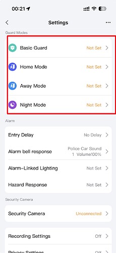

Hi @markwwd
You need to manually delete them as I did in the video. If you have them used in these sections as in the photo, you need to delete them in each.
Nothing happens when I tap on it…
Oh I got it. You actually need to tap on one of the toggles even though they’re greyed out.
