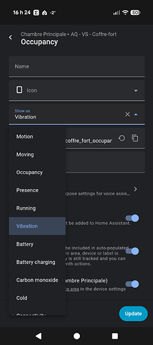

@troy_bruder no need to switch to ZigBee. If you see the occupancy entity in Home Assistant, you can easily change it to Vibration… it’s just a binary sensor after all (vibration/no vibration).
To do so, go to the device page in Home Assistant, tap on the Occupancy sensor and then on settings (cog wheel in the top right). On the form that shows up there, change “Shows as” from Occupancy to Vibration. That’s it
