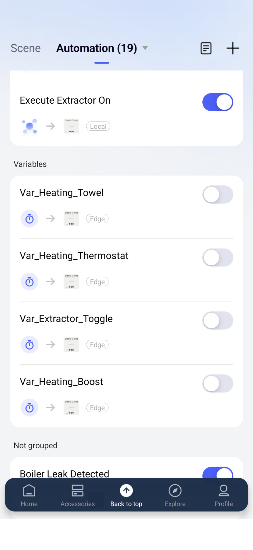

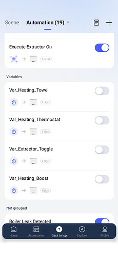

You can use the enable/disable state of automations for this.
You have to make a useless empty automation first though. I use ‘every day turn on unused relay’ as the useless automation, and then use that automation enable state as a variable.
I have multiple copies of this fake automation for this purpose
I tried to replicate the Boolean functionality with scenes and in turn switching ON and OFF automations. It is doable to a degree but not as flexible and usually involves more steps. Your idea is not bad. Like programming a useless automation, for example at 0123 am turn off a light if it is off. Ha Ha. Ok, thanks for the idea. :grinning:
Glad to hear it worked for you. You can add these fake variables to a dedicated group to keep them out of the way. It’s also good for debugging as you can see the state of the variables easily.
