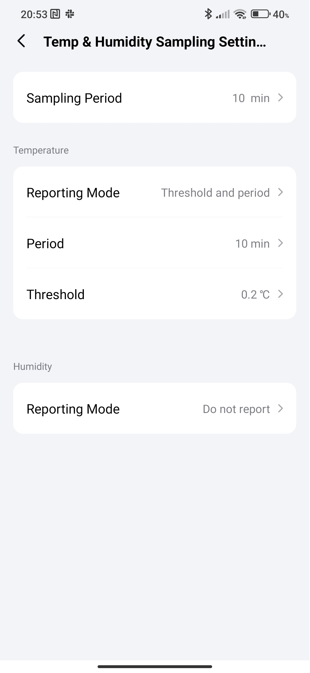

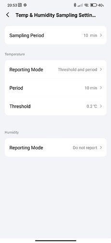

I had the same problem and resolved it by following the @gafich10 guide by modifying the W100’s update parameters. I changed the refresh rate of the temperature being sent to the E1 valve every 10 minutes. Since then I have no more problems.

All my W100 is now setup like this. (See picture)

@jarenback1 This is right. I just set the humidity differently. Only on a period and every 10 minutes.
With this configuration of mine I no longer have any disconnection problems. The W100s send data every 10 minutes to my E1s so they are always updated on the temperature status.

Hello, to save battery power of W100 in the humidity section you can leave nothing in case you do not use humidity in automation. The information about humidity will be updated on the sensor screen
You meant ”Do not report”, that’s I think you meant :face_with_peeking_eye::+1:t3:
Hi. I’m so happy to hear this. And above all to have helped resolve a common problem. Thanks also to @gafich10 for your initial guide.
You can also set 0.2 °C, this will give you greater accuracy and efficiency in starting the automation. Explanation: if 10 minutes have not passed until the next data transfer and at this moment a change of 0.2 °C has occurred, the automation will immediately be triggered (data will be transferred).

Your problem is same like I hade. So use the guide! It will help you!
Set the differens to 0,2, that’s really good advice I did get!

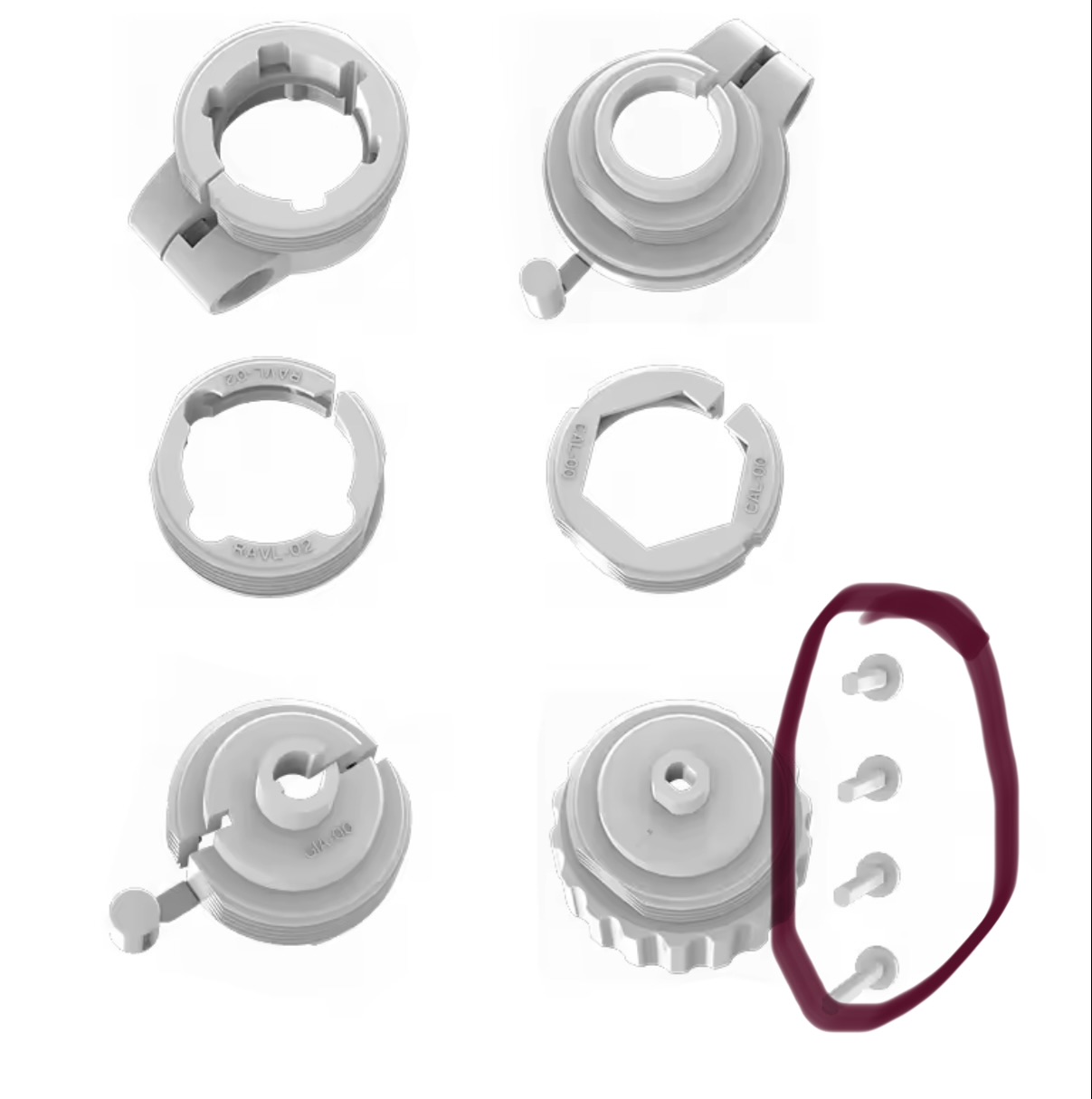

Have you setup the device correctly? You maybe need a ”pin”?
“It was installed correctly. What PIN do you have in mind?”
This pins, depending on your fittings.
