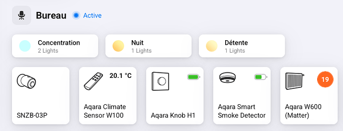

1 — HomeKit

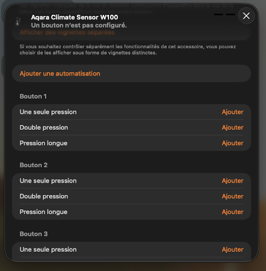

The W100 appears automatically in the Home app once the M3 is added. No additional pairing is required. You may need to look in the “Default Room” and move the thermostat to the correct room manually.

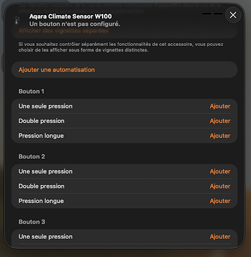

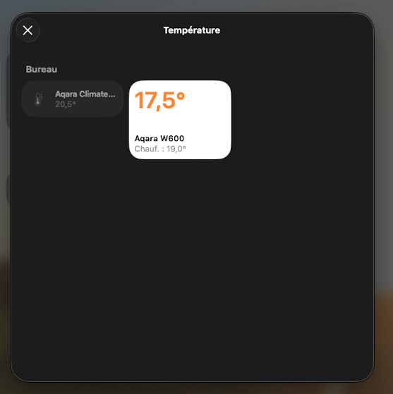

HomeKit splits the W100 into two elements:
• A climate tile at the top of the Home app window, showing temperature and humidity.
• A set of switches visible in the room, which can be used for automations or scenes.
HomeKit exposes nine switches (or buttons). They can trigger scenes or basic automation rules involving other HomeKit devices.
But you can’t use them to launch an automation with Apple Shortcuts by exemple.

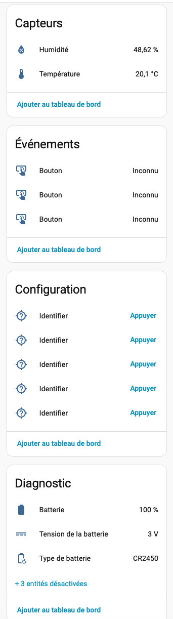

The behavior is similar: after integrating the M3, the W100 appears automatically in the Matter section.
In my setup, Home Assistant exposes only three buttons instead of nine. I do not know why this difference exists. Home Assistant also displays the temperature, humidity, battery level and even the battery type.
One useful feature that appears to be missing is the trend indicator. Some thermostats provide it in Home Assistant, and it is convenient for quick diagnostics.

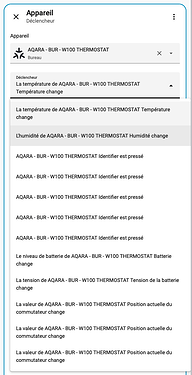

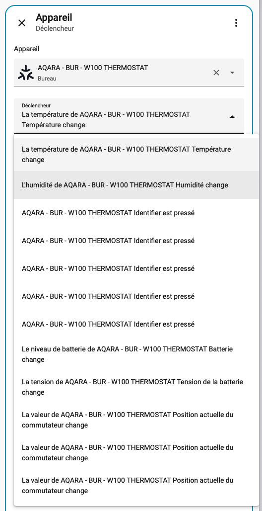

W100 exposes the following triggers in Home Assistant:
• 1 temperature trigger
• 1 humidity trigger
• 6 “Identify pressed” triggers
• 1 battery level trigger
• 1 battery voltage trigger
• 3 “switch position” triggers
That gives a total of 12 triggers, with several clear duplicates due to how Matter endpoints are exposed in Home Assistant.
The available actions feel more limited than expected. Identifying which button maps to which function can be difficult, and only four buttons appear operational. This may be related to the current ZHA/Matter implementation and how it interprets the device’s capabilities. I cannot confirm.

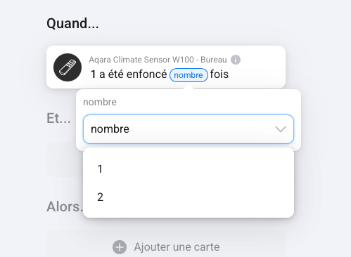

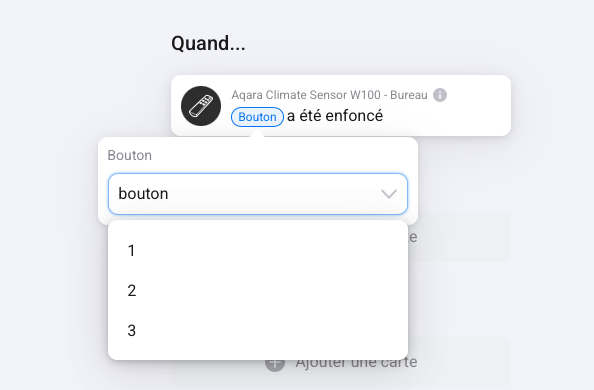

Homey does not recognize the W100 natively at the moment. With the Matter integration provided by the M3 Hub, Homey detects it as a generic “remote”-type device but still reports accurate temperature and humidity.
The good news is that Homey offers more automation options than HomeKit, with a wide set of triggers and actions available in Advanced Flows.
This action let you automate the first 3 buttons.
The one let you use 3 times (press) the same button.
List of all actions in Homey:

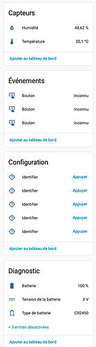

Hi, thank you for such a creative, extensive description.
It will be useful for users before purchasing to convince them of the feasibility of having the W100 in their smart home.
Correct, there are just three buttons that can be pressed in different ways.
You must consider the “event types” (on the right side of the image / Rightmost column “Attributes”).
  • multi_press_1: Button pressed once.
  • multi_press_2: button pressed twice.
  • long_press: the button is pressed and held.
  • long_release = button released after being pressed and held.
How it works with automations:
And here is the YAML for pressing the button once to turn a lamp on and off:

You forgot the battery type. And for me, there are 5 “Identify” Entities. That makes a total of 13 Entities. Only the “Identify” Entities are duplicates. However, you can also hide or disable them.
