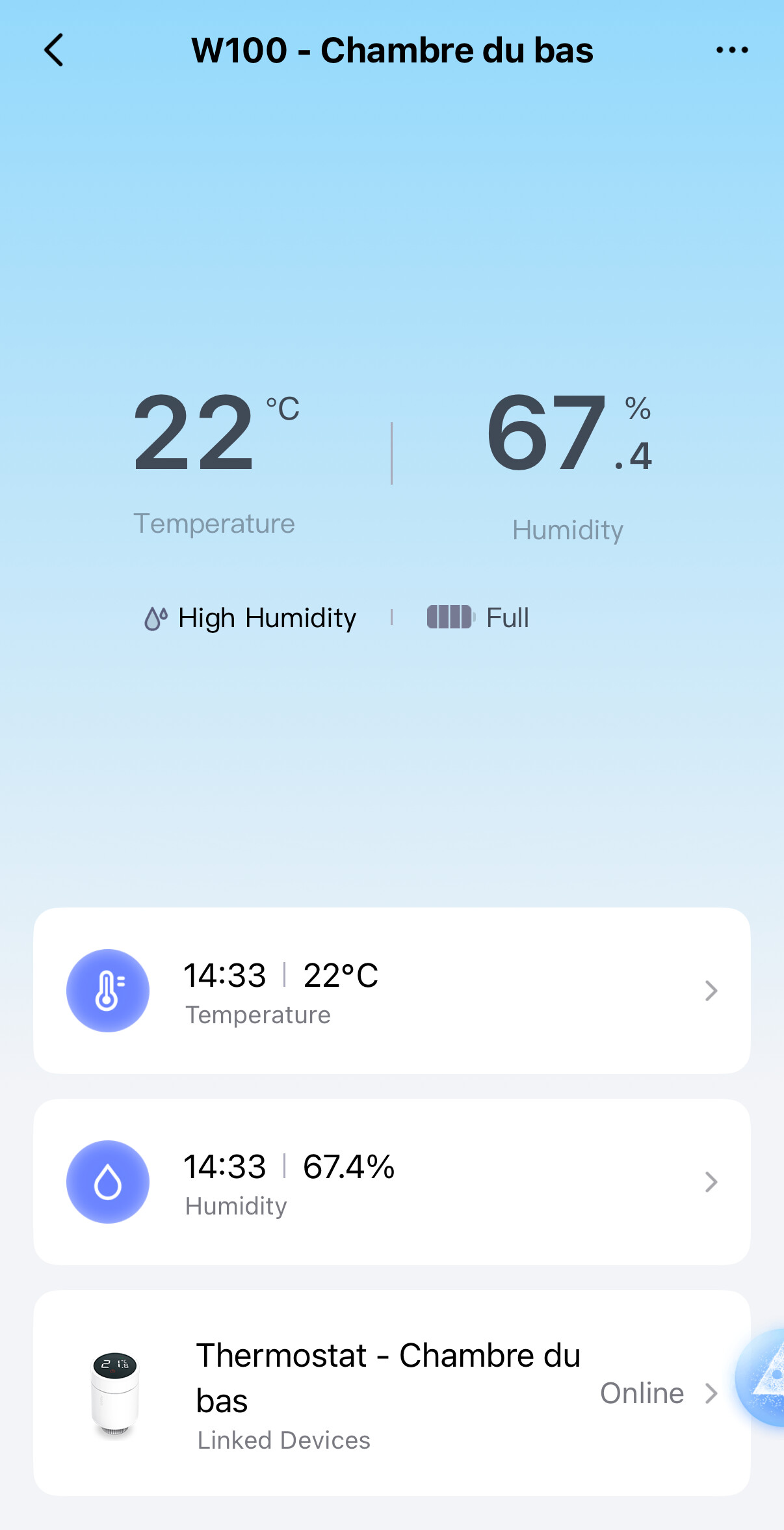

I have installed several Smart Radiator thermostat E1 on heated floor valves, It works (opens an closes the heated zones properly), expecting to use W100 with them. It is the perfect use case for the E1+W100, since I have several rooms without wired thermostats. Also I have 2 floors, which complicates a bit zigbee network, but I solved the issue with T2 relays which extend it perfectly.
I had to switch the W100 to zigbee firmware, then have linked W100 to the E1 both ways, I figured you need to add the w100 to the E1, and the E1 to the W100 to control and get feedback.
Then comes the zigbee reachability:
All my devices have strong zigbee link up to my M3 hub, which I can check in the app, this is the only zigbee network I have at home and they are all aqara devices. I have a group of E1/W100 within a few meters from each other, and a second group which are not on the same floors.
It looks like the E1 is not able to follow the zigbee network up the w100 (or the other way around), and therefore loses connexion with the w100.
It constantly tells me “please check or re associate the device if the associated device is off-line, faulty or has an abnormal network”
When I remove the w100 and E1 from the app and re-associate them, they appear connected for a few hours, I can see the real room temperature for a few hours on the E1, and it activates the heated floor as expected, but then they lose again the connection.

I have :
-tried to keep the m3 offline for a while
-tried to remove batteries of the E1
-remove all accessories then re-add them
-unpair W100 from E1 and re-add them.
All devices show strong to excellent zigbee connectivity since the T2 have been placed a week or two ago.
Every time it’s the same thing. When I pair w100 and e1, they seem to work together for a while and then, lose connectivity (both E1)
