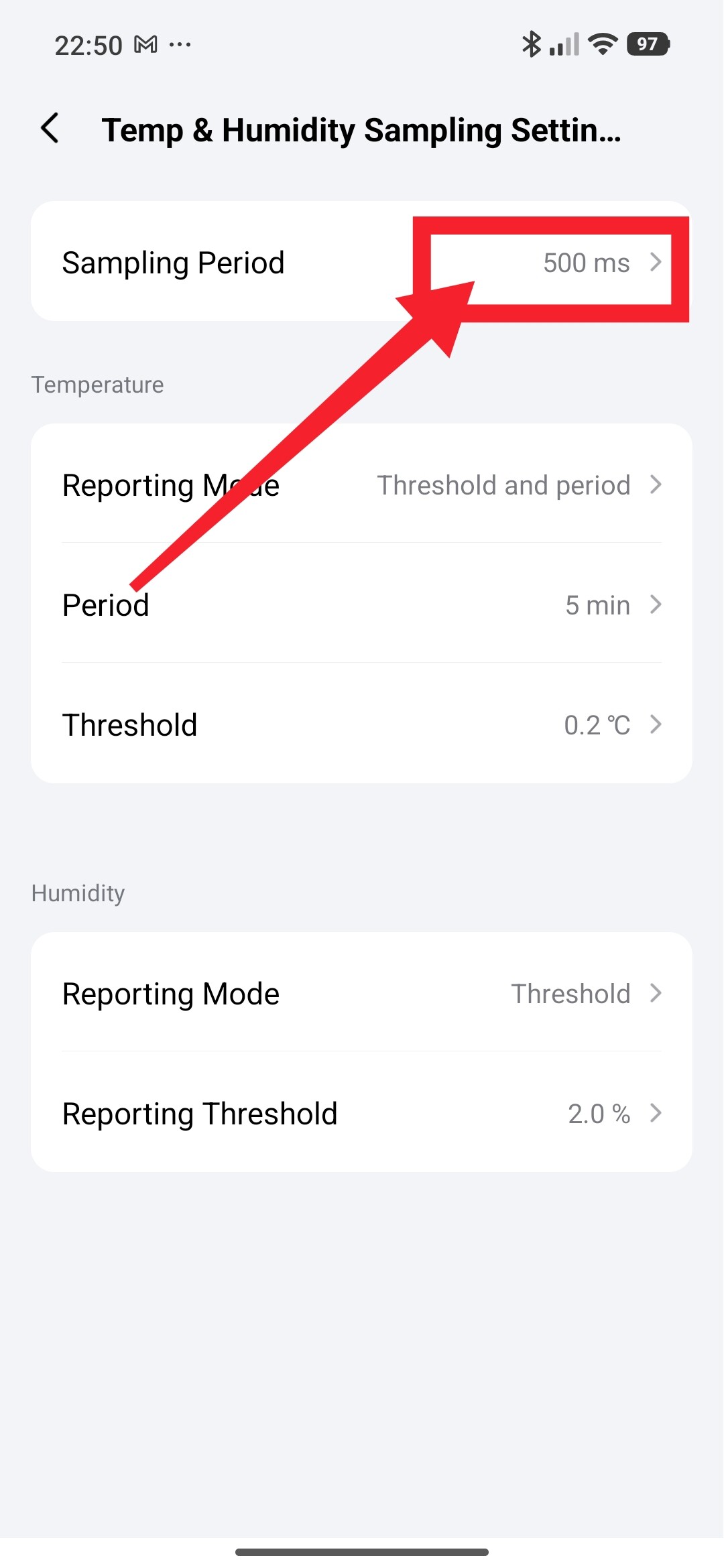

Hello, you used the temperature sampling setting with a range of mal1.
The T1 sensors transmit with a frequency of ~1 time per hour, or after a change of -/+0.5°C.
