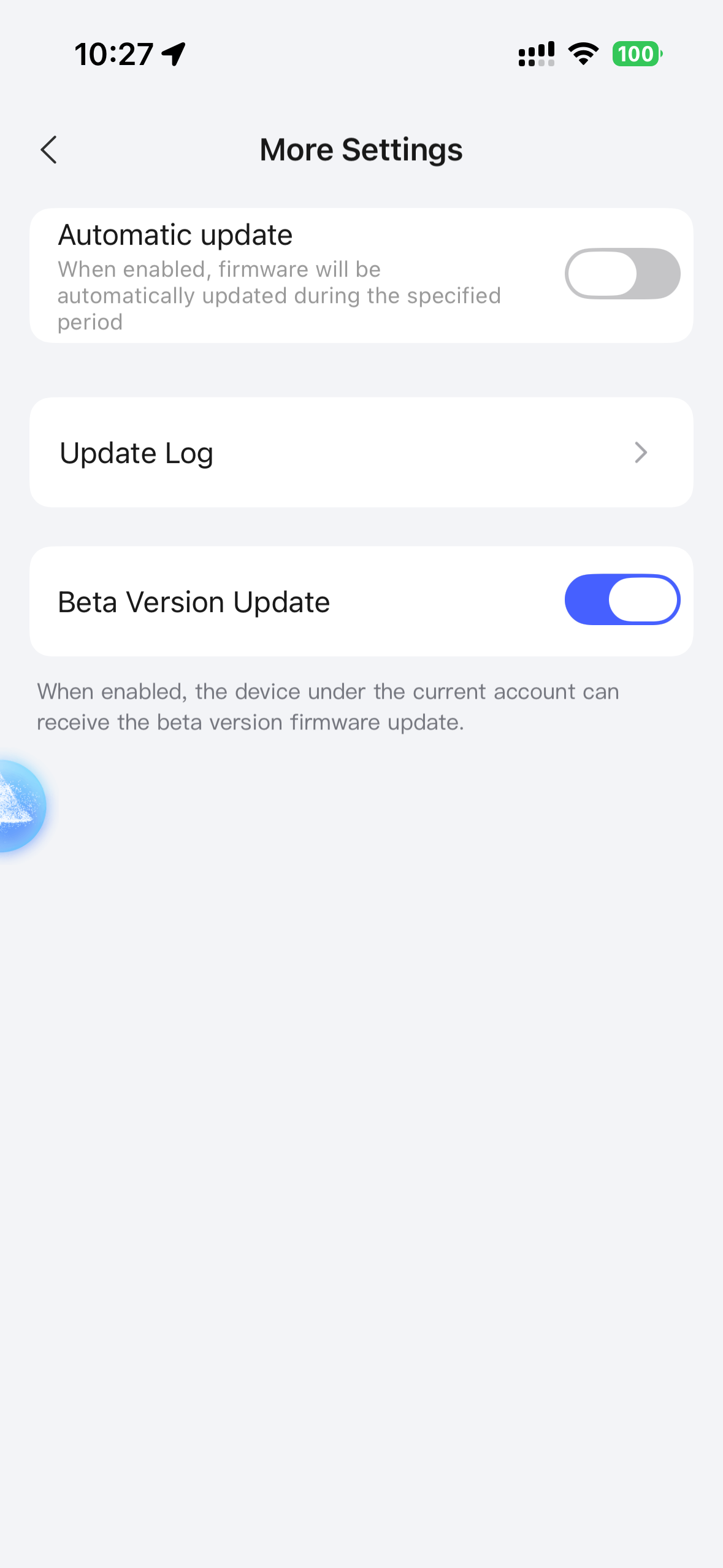

Did you turn on the beta version update?
Yes Beta Update is always turned on.
Ok ! And the update is still shown?
Problem Solved! I have delete the W100 in the App. Then added new at Thread Device. And again delete in the App. Added new with Zigbee Protocol and the App plays the new Firmware on the W100. Thank me
