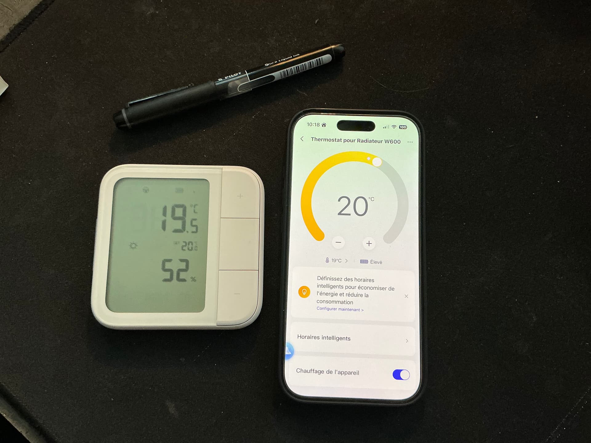

Using Zigbee inside the Aqara ecosystem unlocks a few useful features. One of the most interesting is the ability to link the W600 (radiator head) with the W100 (wall thermostat).

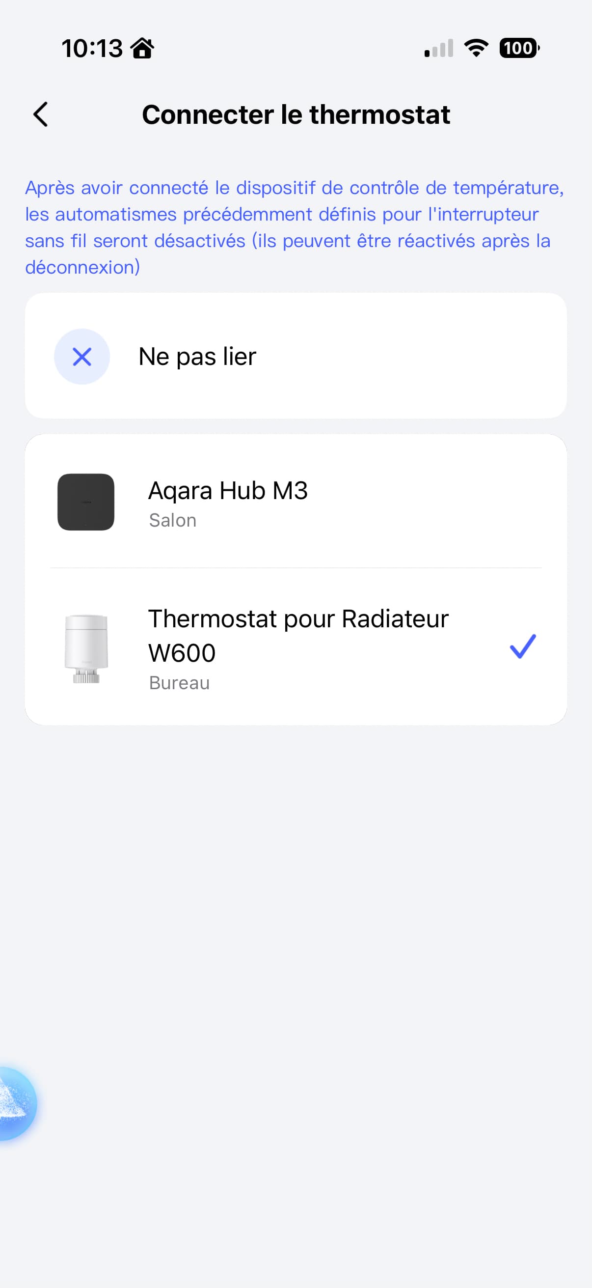

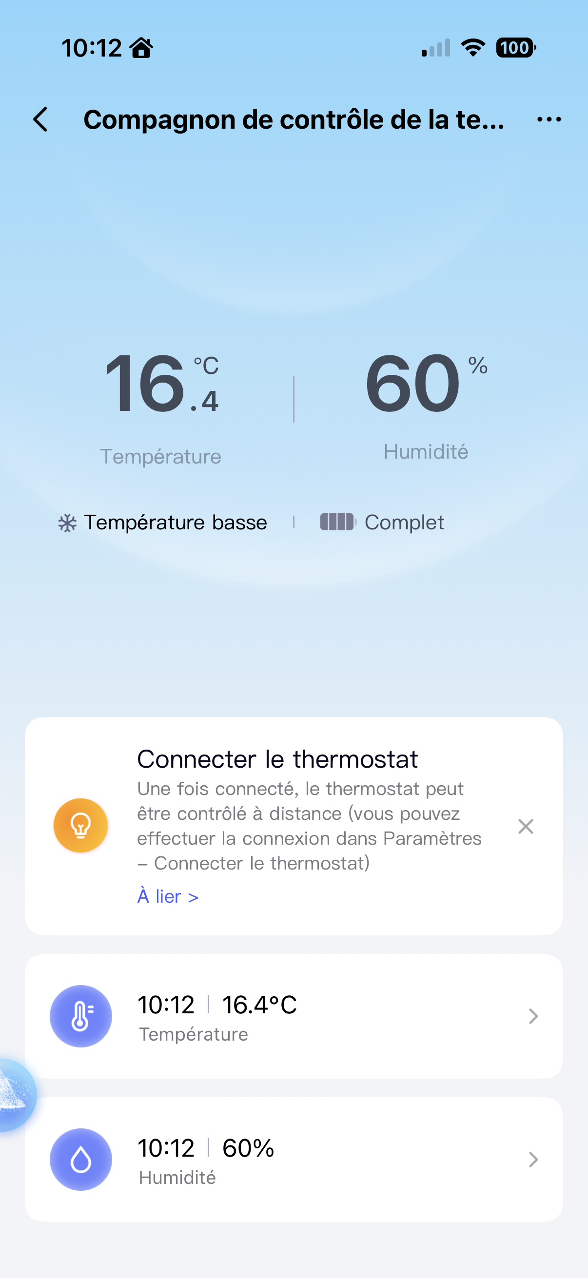

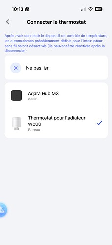

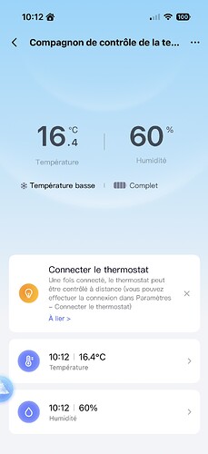

The process is straightforward: configure the W600 first, then move to the W100. During setup, if both devices are assigned to the same room, the app automatically suggests linking them. You simply choose the W600 from the list.
Once paired, the three buttons on the W100 become dedicated to controlling the W600. The centre button validates the target temperature.

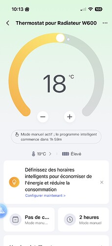

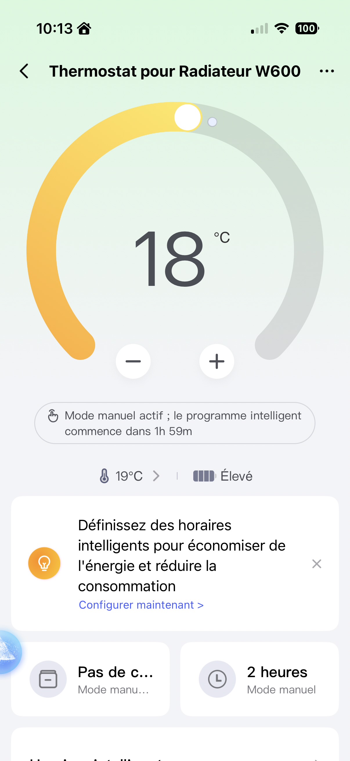

The temperature update on the W600 is not instant on my side; it usually takes two or three seconds, but it does work consistently.
This pairing is genuinely useful. The temperature measured by the W600 is often inaccurate because it sits very close to the heat source. The W100 solves this problem perfectly, as you can place it anywhere in the room to get a realistic ambient temperature.

Despite this limitation, the W100 + W600 pairing works very well overall and provides a noticeably more accurate room-temperature control. The W100 is, in my opinion, an excellent companion device for the W600.
