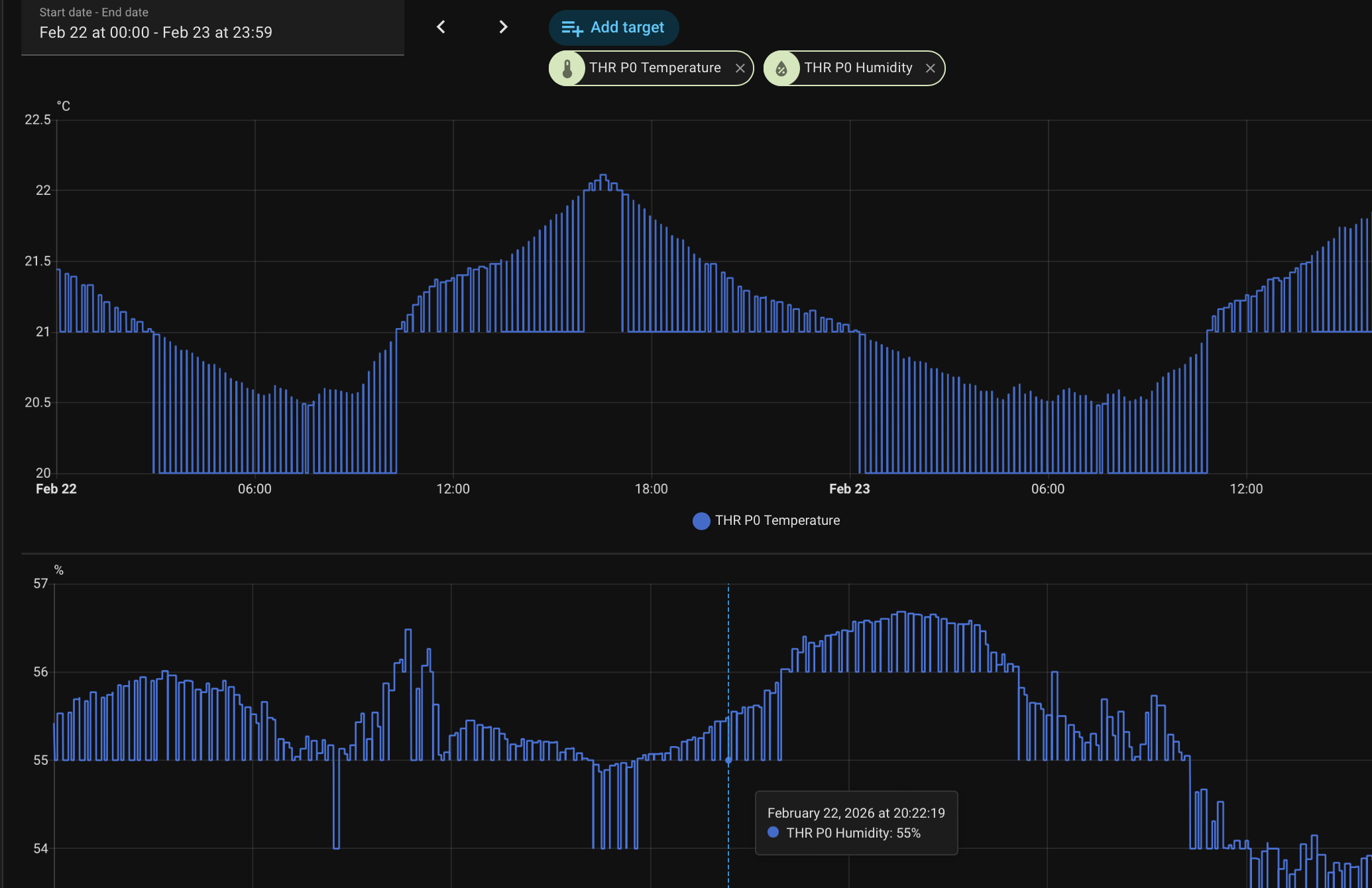

Look at this graph here:
Reported temperature & humidity oscillate between integer and float.
We can’t say that’s an improvement.
