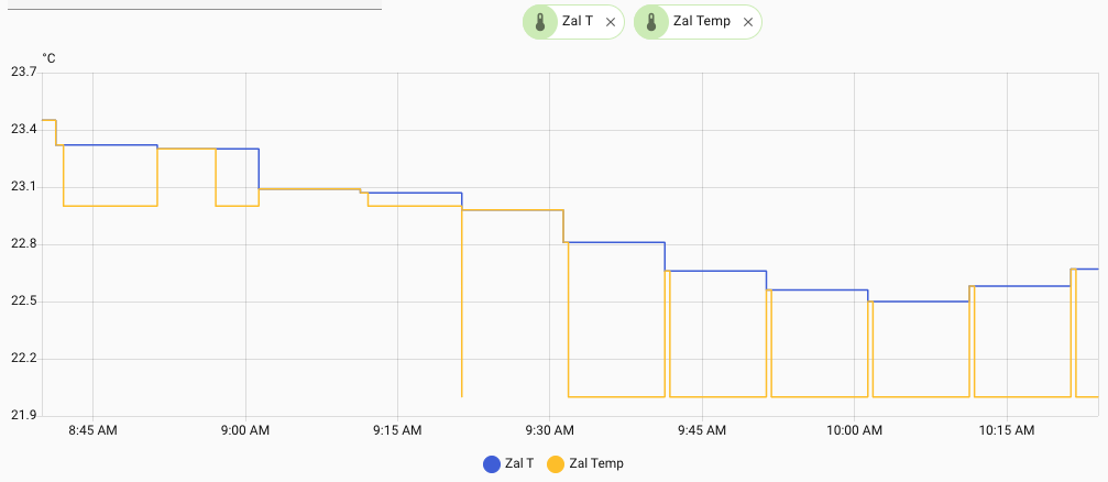

My solution for ZHA: filter out rounded values using a Template Sensor.
You can create a template sensor that only accepts values with a decimal part and ignores rounded ones.
Steps
  1. Go to:
    Settings → Devices & services → Helpers
  2. Click:
    Create helper → Template → Sensor
  3. Fill in:
Name: Filtered Temperature
State template (replace zaltemphum_temperatura to your W100 sensor):
{% set v = states('sensor.zaltemphum_temperatura') %}
{% if v not in ['unknown','unavailable',''] %}
  {% set f = v | float %}
  {% if (f * 10) % 10 != 0 %}
    {{ f }}
  {% else %}
    {{ this.state }}
  {% endif %}
{% else %}
  {{ this.state }}
{% endif %}
Unit of measurement: °C
Device class: Temperature
State class: Measurement
Device: Select W100 device to link
How it works
  • Values like 23.0 are ignored
  • Values like 23.7 are accepted
  • The sensor keeps the last valid (non-rounded) value
Result
You get a stable temperature sensor that updates only with real measurements and ignores the faulty rounded updates.
The downside is that if the actual temperature is a whole number (without decimals), it will also be ignored. However, this is still preferable for use in a virtual thermostat, as it prevents unstable fluctuations in the readings.
Use this new sensor in your automations instead of the original one.

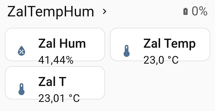

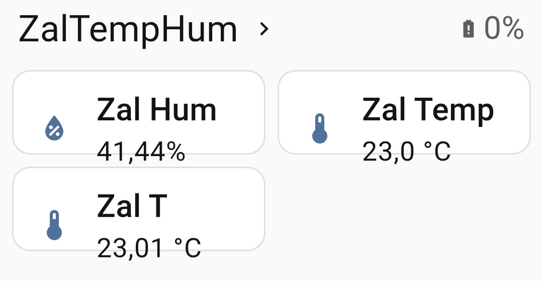

Zal T - virtual sensor
Zal Temp - real sensor
Now we just have to wait for a firmware update.
Additional note: the sensor actually reports values with two decimal places, so the chance of receiving a true integer value is extremely low.

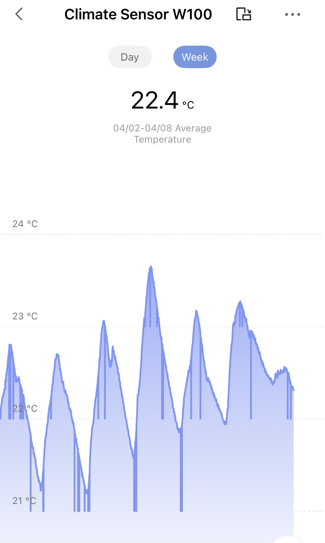

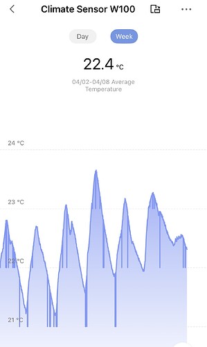

Are there any updates regarding the W100 and Home Assistant on the 0.5°C step issue? Aqara should understand that many users are waiting for a solution.
@peterChengg As mentioned above it’s not only a third part issue. It is a device issue that also manifests itself in the Aqara app - https://forum-static.aqara.com/original/3X/9/0/9080b0daa7eb243d61799a0a6805ede0321d4520.jpeg
+2 months has gone by and no fix or workaround provided by Aqara.
This is ver poor customer support-orientation.
