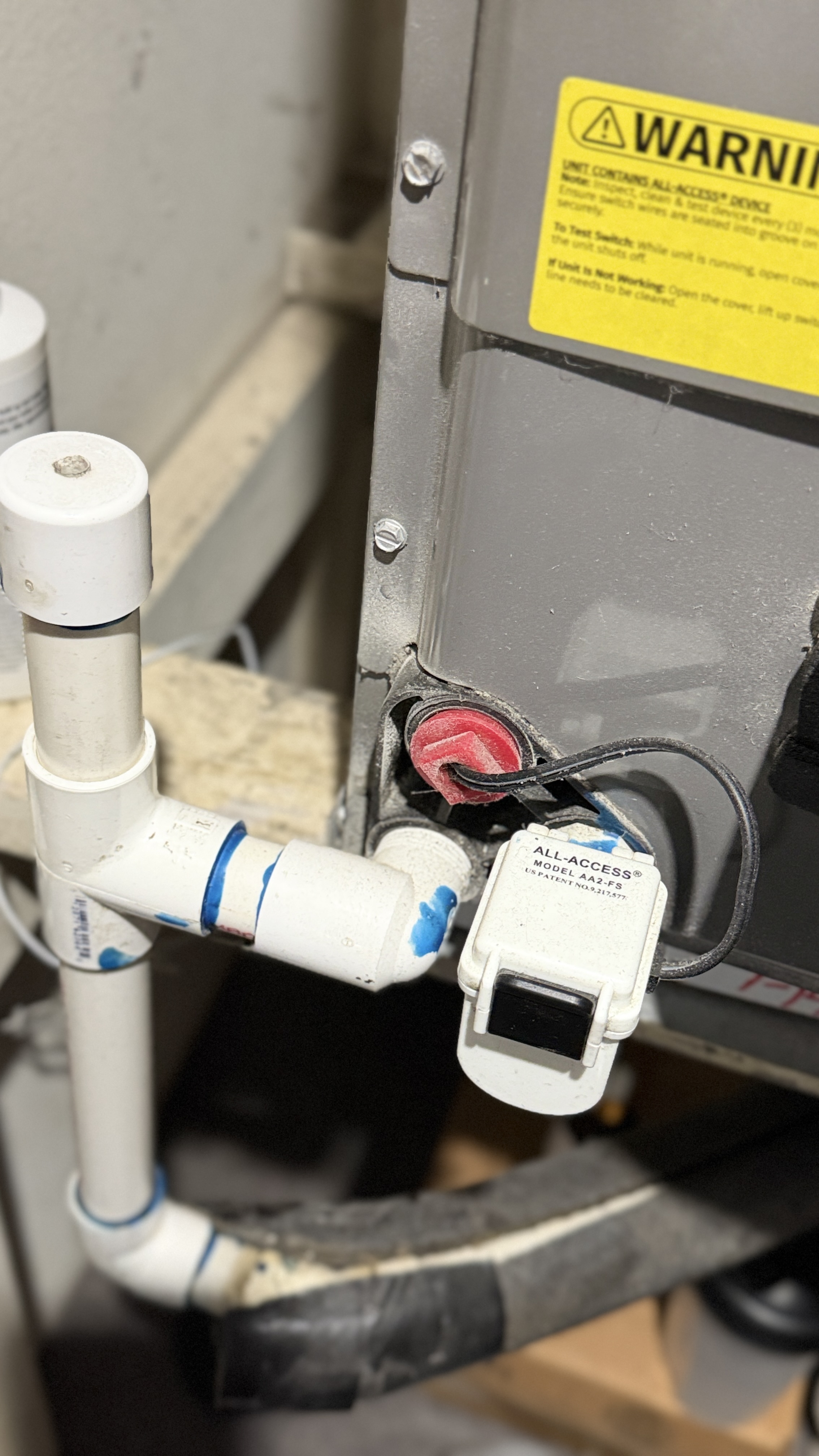

Recently, I came across an issue week or so ago. That completely baffled me because there was no direct indication to why the issue was taking place. What was happening was the thermostat was running and every so often it kept on kicking off and rebooting.
At first, I thought that’s odd. Maybe it’s a matter issue so I removed everything from Apple used only on Aqara . The issue continued thermostat. Would run five minutes maybe 10 minutes sometimes and then kick off freeze in responsive to display and then reboot few min later . This was driving me crazy.
I started to search the Internet. I started to read some things saying there’s something wrong with the wiring or short on unit.
I checked all the wiring. I checked all the connections. Everything was fine.
I restored the units back to factory settings and started all over again after about 10 minutes. The issue came back.
I contacted technical support by the way horrible worst ever only respond to you if you’re lucky once every day.
They insist that I have….” Looks like the C wire is not connected well. Could you please kindly check?“
*Nothing wrong with my C wire checked it over and over again.

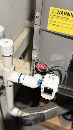

Then I started doing some more searching on the Internet and came across these AC people and they say I have electrical fluctuation and gave me some things to check one of them. I had no idea and neither did Aqara tech Suport told me nothing about it is. The overflow valve. Water wasn’t flowing backwards, but obviously there was not enough of it flowing backwards to shut off unity fully but that kept cutting off the electrical on my unit. I didn’t know they didn’t tell me and I had no idea this could happen I thought that device on unit was if the water started flowing backwards a lot , it would drip into the AC closet and completely cut off the unit it wasn’t doing that.
I flushed. The unit made sure there was no water backing up whatsoever and sure enough the problem is now fixed. I used the shop vac on the outside of the house and sucked out any water that was in the outside drain valve.
So I’m putting up this here on the site so anybody who’s struggling with the same problem hopefully we’ll see and it’ll give him an idea how to fix.
(See attached pic if you don’t know an overflow valve is. I live down south where it’s hot and it’s a must for all units)

Random W200 reboots/freezing every 5–10 minutes really does look like a “thermostat/Matter/firmware” issue at first, but your root cause makes a lot of sense: if the HVAC safety/overflow switch is intermittently cutting power (even briefly), the W200 will behave like it’s unstable when it’s actually just losing 24VAC and booting back up.
A couple notes that may help others reading:
  • The W200 is 24VAC-only, so anything that interrupts that 24VAC path (float switch, condensate overflow protection, loose C-wire, transformer issues) can show up as “reboot loops.”
  • And yeah—support defaulting to “check the C-wire” is common, because a missing/loose C is the most frequent cause of power instability on smart thermostats. (Not saying that was your case, but it’s the right first checkbox.)
