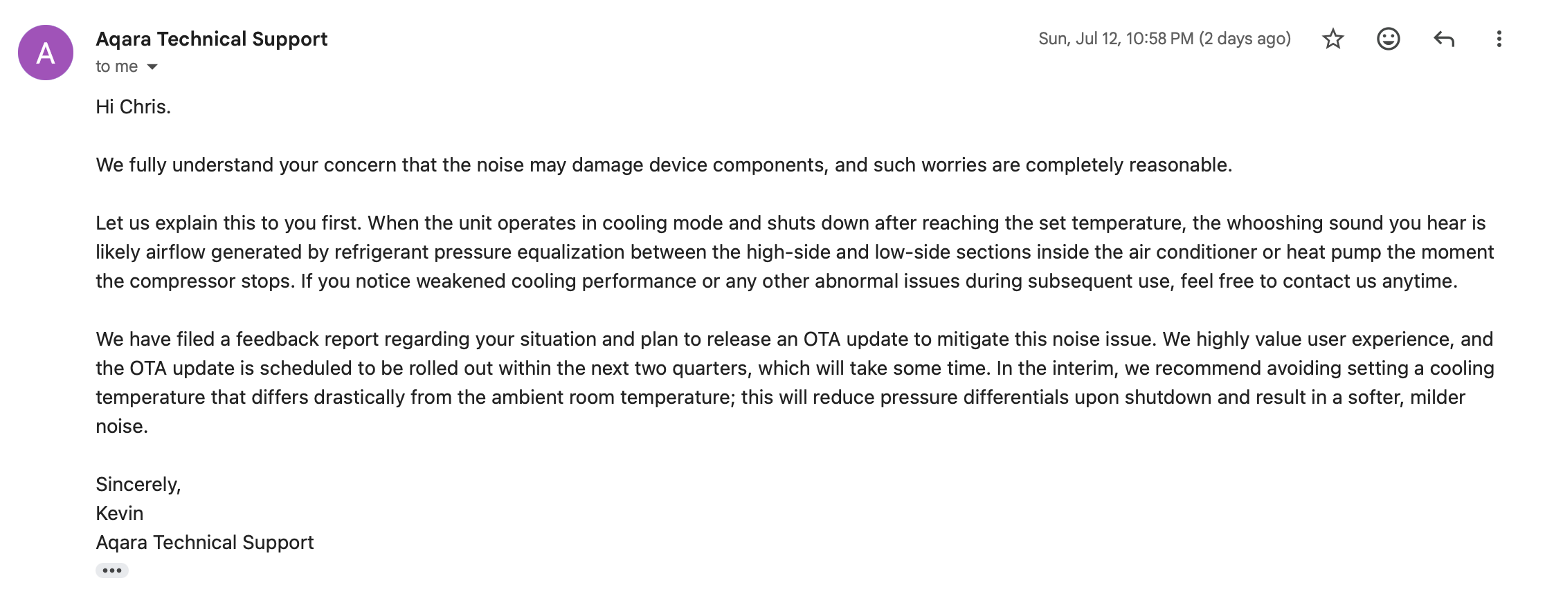

Received this response from Aqara Support. Looks like a fix is not going to be ready any time soon. Unfortunately had to return the W200 and go another route. Was looking forward to using this thermostat!
We fully understand your concern that the noise may damage device components, and such worries are completely reasonable.
Let us explain this to you first. When the unit operates in cooling mode and shuts down after reaching the set temperature, the whooshing sound you hear is likely airflow generated by refrigerant pressure equalization between the high-side and low-side sections inside the air conditioner or heat pump the moment the compressor stops. If you notice weakened cooling performance or any other abnormal issues during subsequent use, feel free to contact us anytime.
We have filed a feedback report regarding your situation and plan to release an OTA update to mitigate this noise issue. We highly value user experience, and the OTA update is scheduled to be rolled out within the next two quarters, which will take some time. In the interim, we recommend avoiding setting a cooling temperature that differs drastically from the ambient room temperature; this will reduce pressure differentials upon shutdown and result in a softer, milder noise.
Sincerely,
Kevin
Aqara Technical Support
