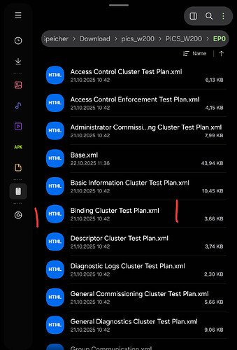

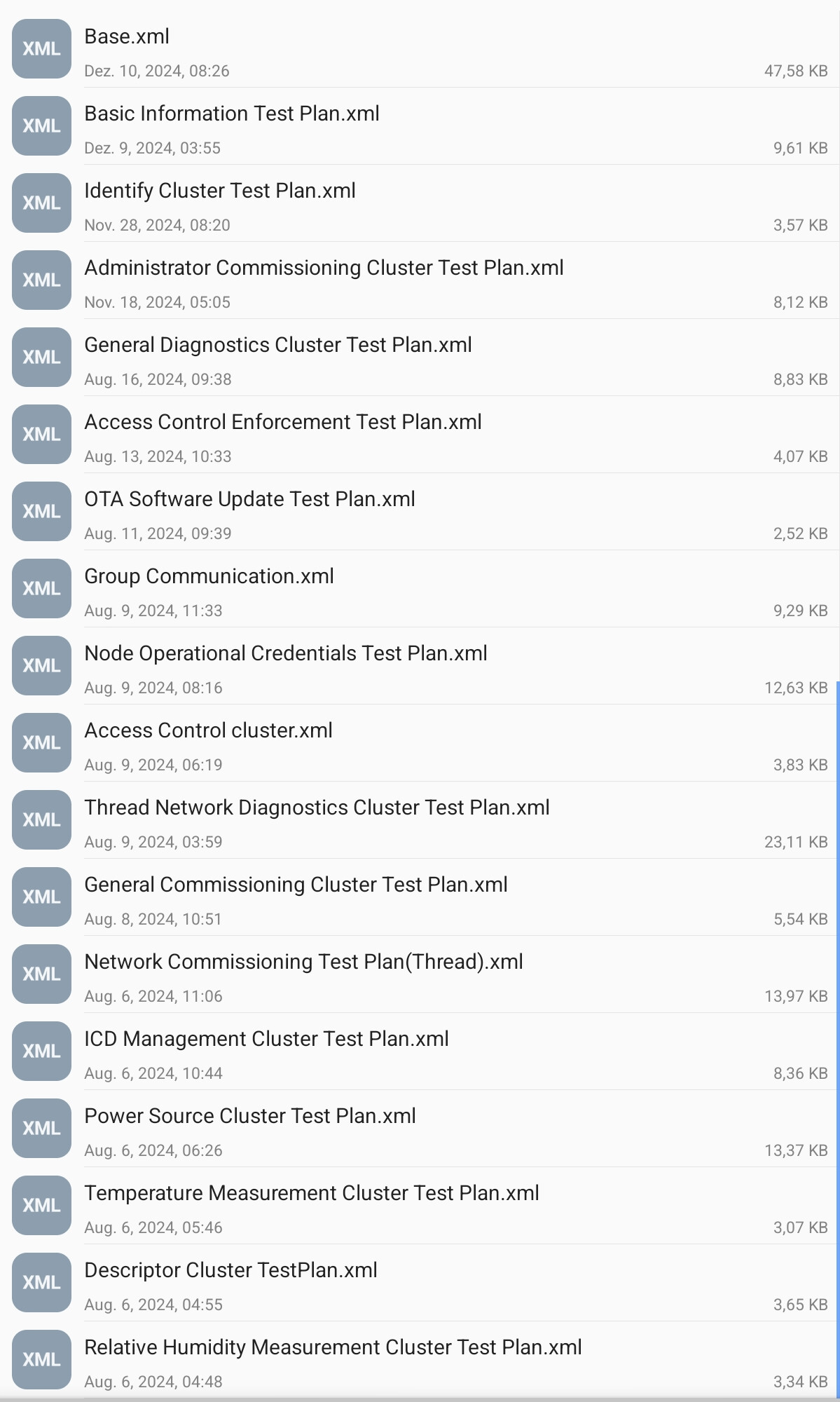

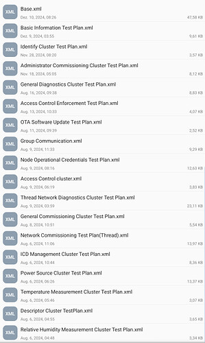

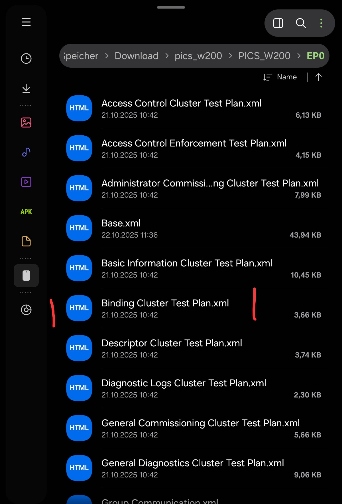

The IKEA TIMMERFLOTTE doesn’t have a Matter Binding cluster, which is required to bind it directly to the W200.
IKEA TIMMERFLOTTE:
The W200 has one, of course:
