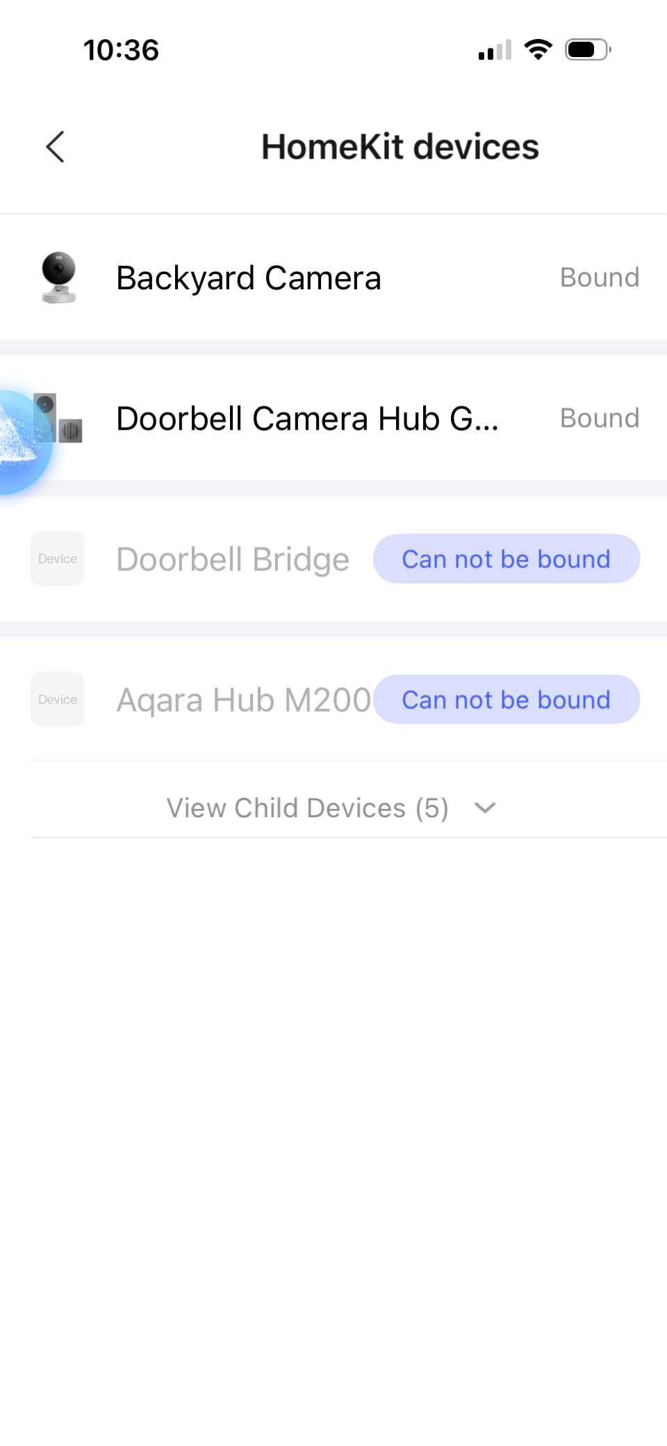

Okay gafich10, thank you for your reply. Stay with me here… I followed your advice and it led me to this:

So, in the screenshot I provided, why does it say my hub and doorbell bridge cannot be bound?
Hi @Expert. Who can help with synchronization?
Are they on the same WiFi network? Do you use any WiFi repeaters that create another network?
The hub and the camera need to be connected to the same WiFi/network - they can use Ethernet, but they still must be connected to the same subnet.
Yes, everything is on the same network. I just deleted my entire home in the Home app. Then started from scratch. Everything is fine now.
