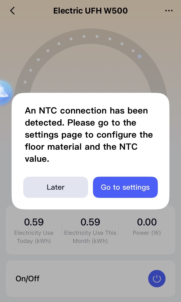

Hi Aqara,
Recently installed a W500 in Zigbee mode directly to an M3.

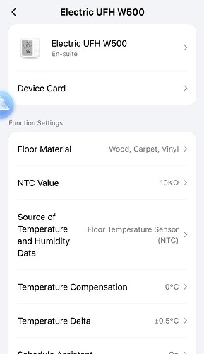

When I setup the thermostat I set the floor material to Wood, Carpet, Vinyl and NTC value to 10K.
All’s working well, except that when ever I go into the device in the Aqara app I receive the following message / alert.
Is there any reason this keep appearing and if not, please can this be disabled after the initial setup?

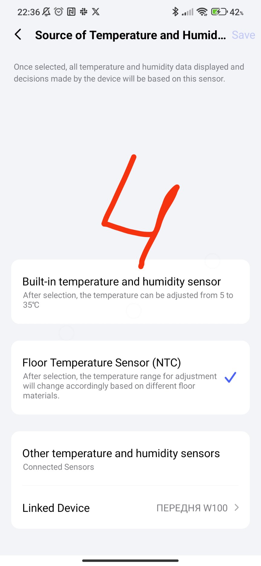

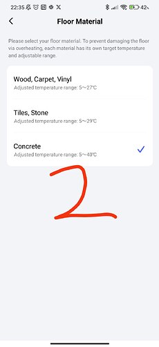

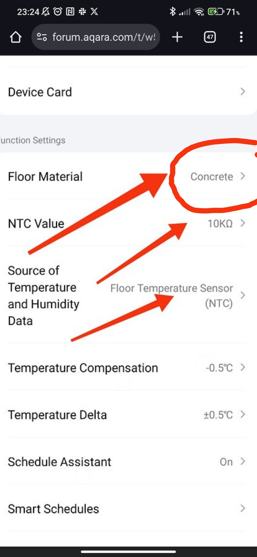

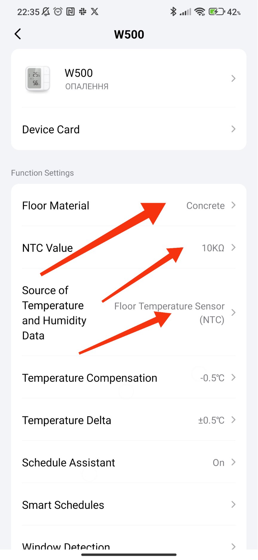

Hello, did you choose these settings?
You have 2 not selected.

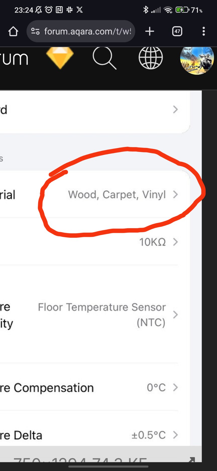

All 3 are selected. See my second image
I mean, the difference between the screens
As per your screen 2, I chose the “Wood, Carpet, Vinyl” option as I have Amtico flooring which requires a 27C max temp.

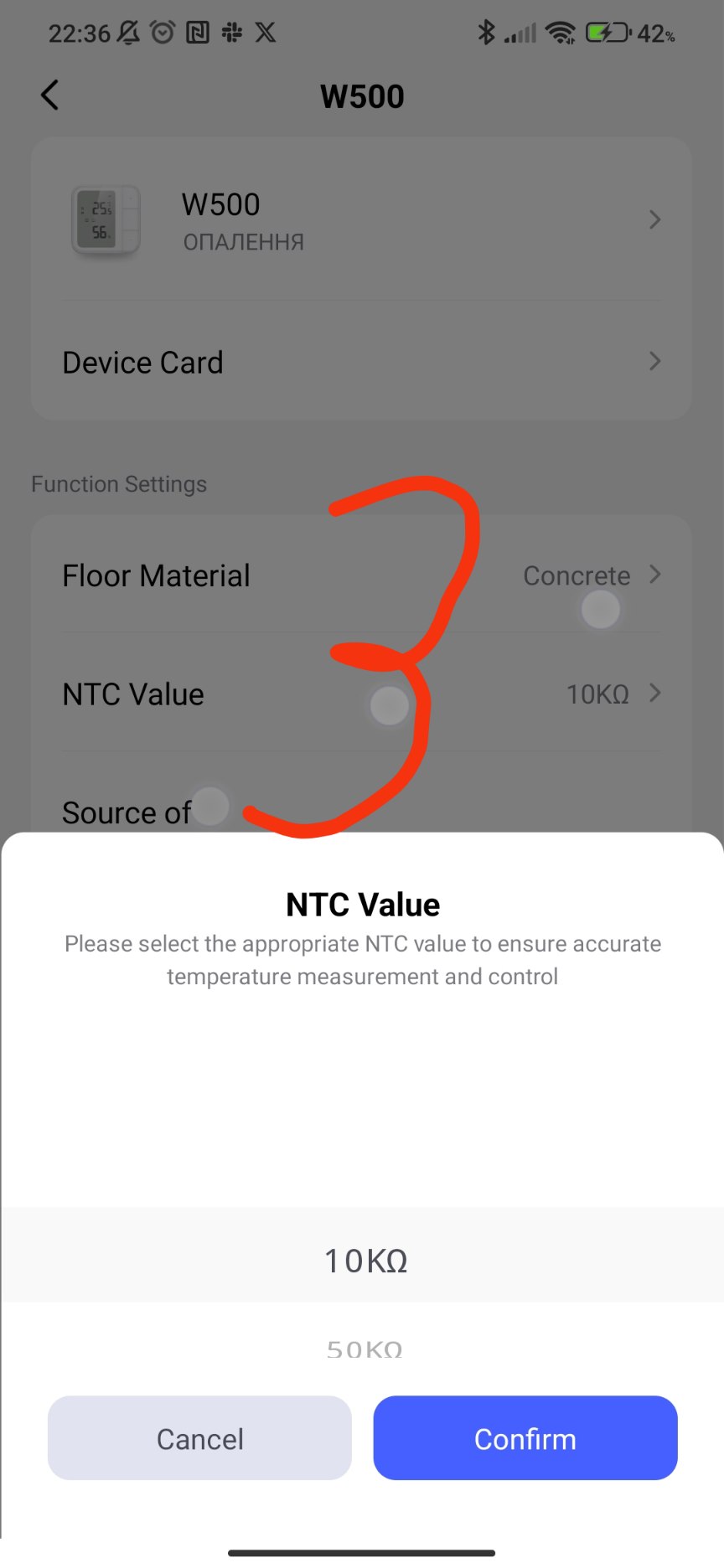

Hello, sorry, I didn’t read carefully, I thought it was about the general group. Another question, is NTC native or the old one that was in your system before?
NTC was already in my setup. Was confirmed as 10 ohme as I still have the packet.
I’ve gone back in and selected other options and then reset them to be needed options. Since then, the error message hasn’t re-appeared but I’ll keep an eye on it.
Thanks

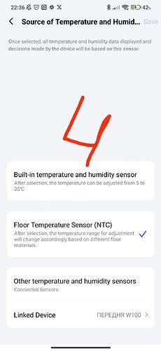

Yes, that’s right. I tested it myself and also saw it. I just didn’t have time to write it down. I’ll explain the algorithm.
When you connect the W100 thermostat control for the first time, the W500 wants to warn you that the control via NTC may be incorrect (overheating of the floor with subsequent breakdown of the heating system). Therefore, the W500 wants to see the action with the selection of the floor type so that the responsibility for the heating parameters (fireplace, wood…) is under your control.
