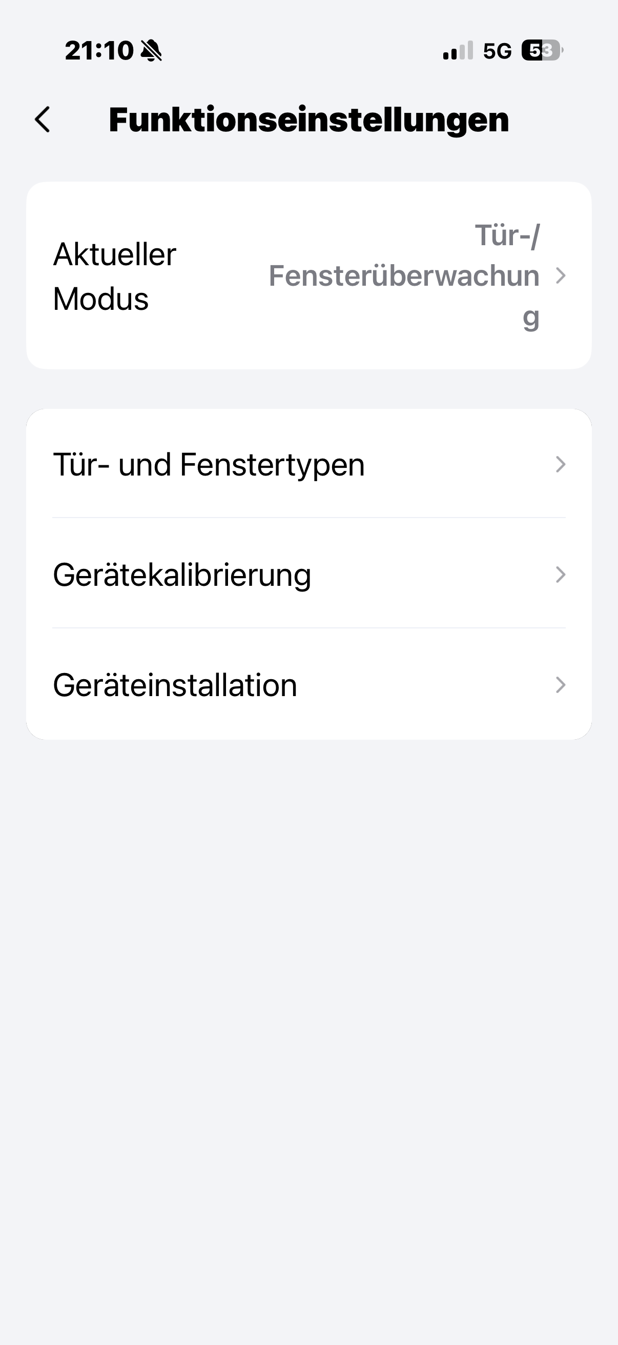

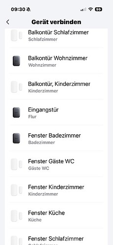

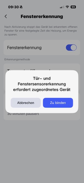

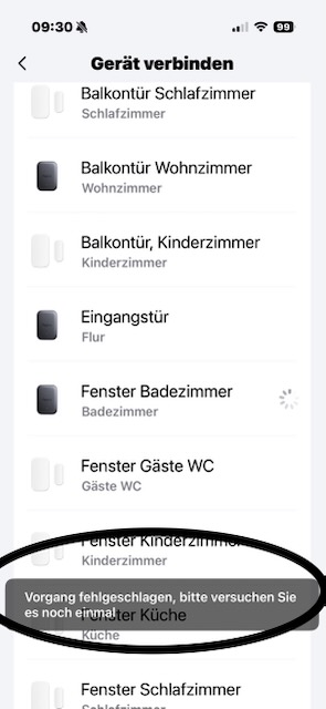

W600 and P100 do not work together

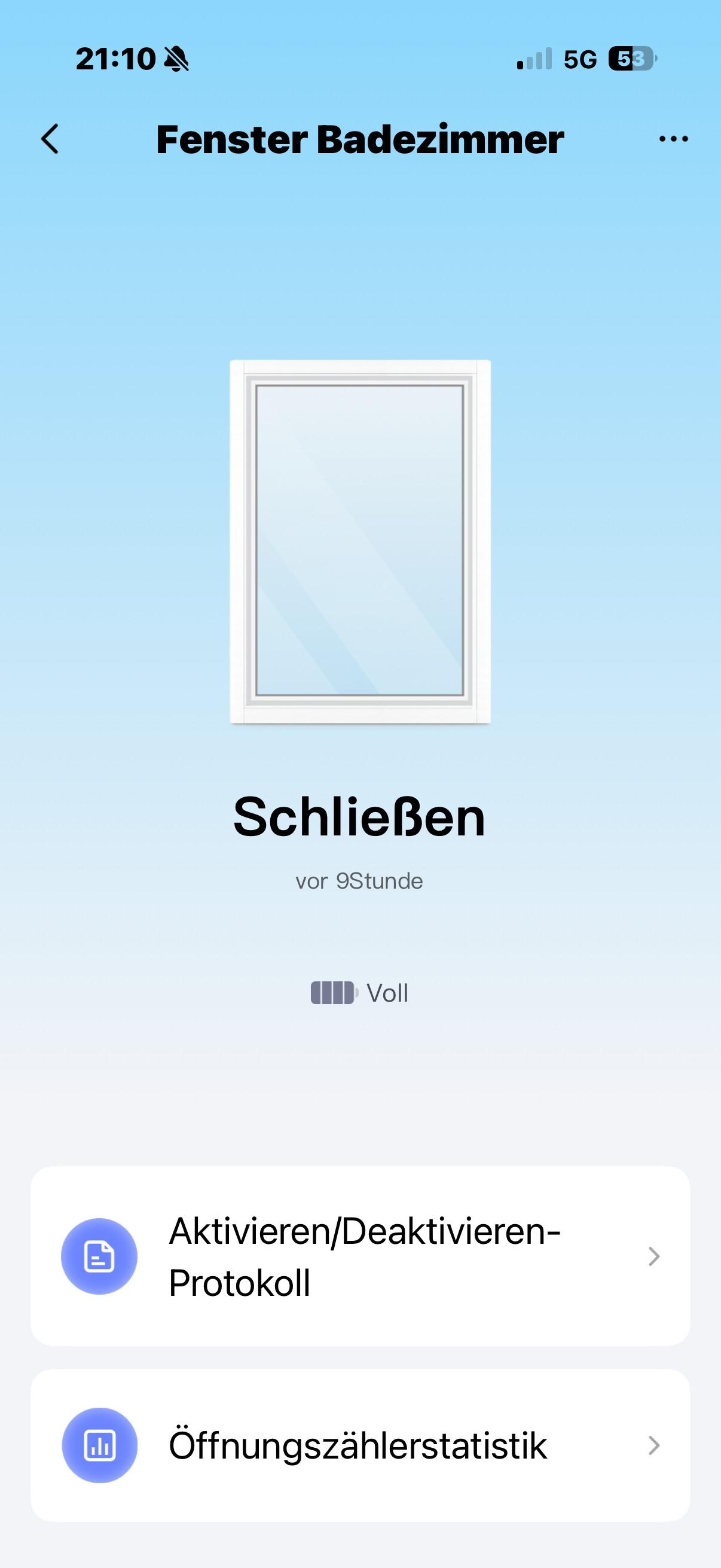

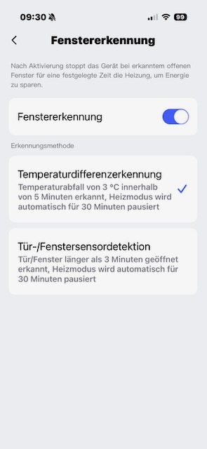

An error message appears when trying to link the P100 window sensor to the W600.
Hello, check in which mode the P100 is operating.

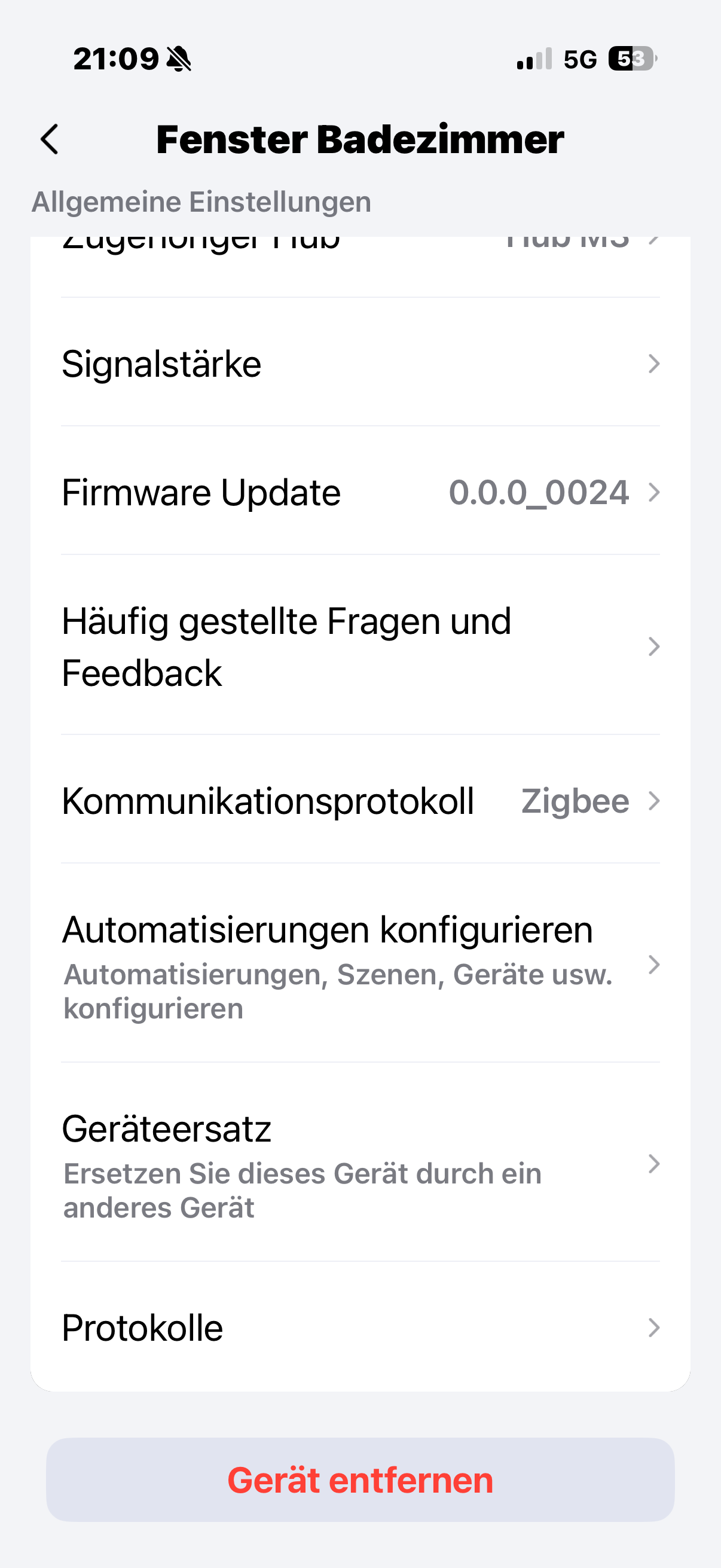

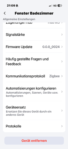

Both the W600 and the P 100 operate in Zigbee mode.
The P100 is set up as a window/door sensor and is working perfectly so far.
These two are absolutely supposed to work together — Aqara’s W600 manual specifically calls out linking to door/window sensors for automated climate control, so this isn’t a compatibility wall.
Sounds more like a setup-flow issue: is the error happening when you’re pairing the P100 to your hub, or when you’re trying to link it to the W600 afterward?
Those are two different steps — the P100 needs to be added to your Zigbee hub on its own first, then the “link” to the W600 is really just an automation/scene, not a direct pairing between the two devices. If you’re trying to add it straight from the W600’s device page, that might be the mismatch.
Hi, here are the instructions for binding the P100.
Instructions for binding the P100 sensor to the W600
