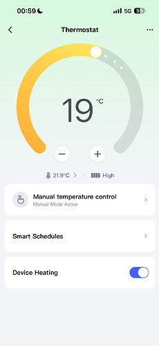

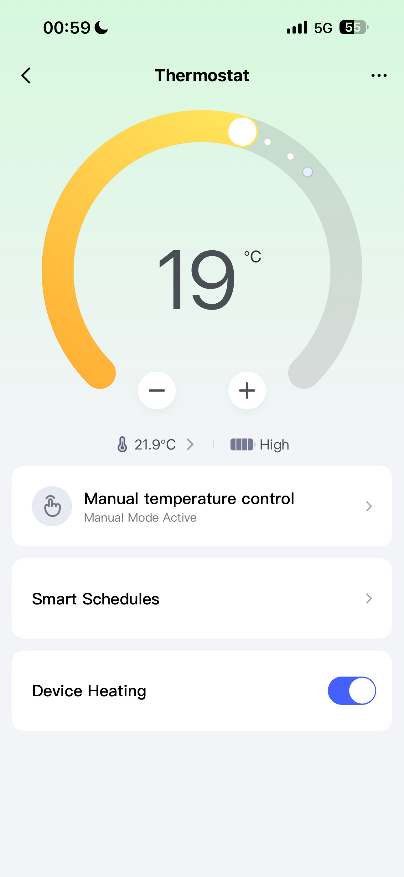

Example
External thermometer configured as temperature source. Correct temperature of external thermometer displayed (21.9 C).
Target temperature set to 19 C.
Expected behavior: The valve is closed
Actual behavior: The valve is opened. The room is heated even further passed the target.

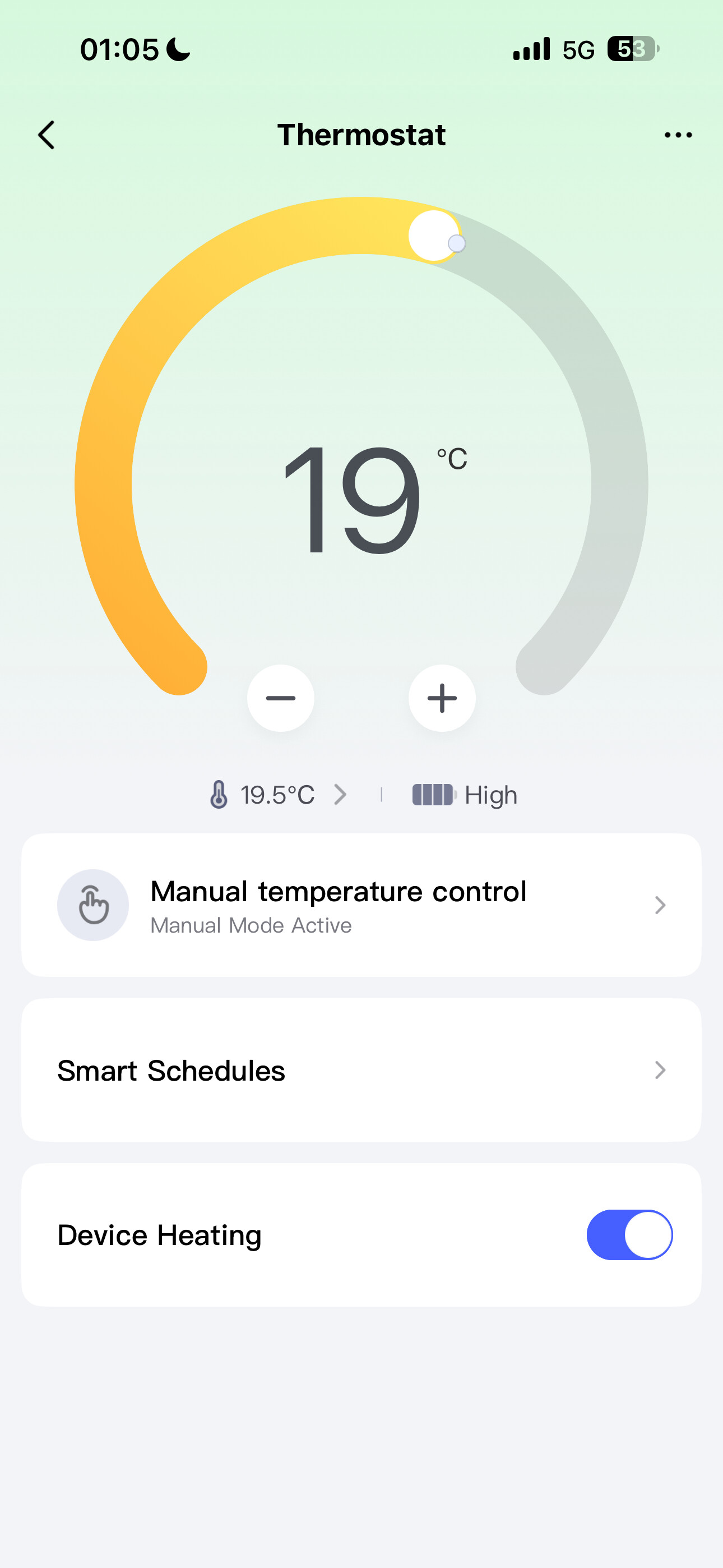

I then switched the temperature source to the internal thermometer. And it became clear that the controller was using the 19.5 C internal temperature reading as a reference for current room temperature.

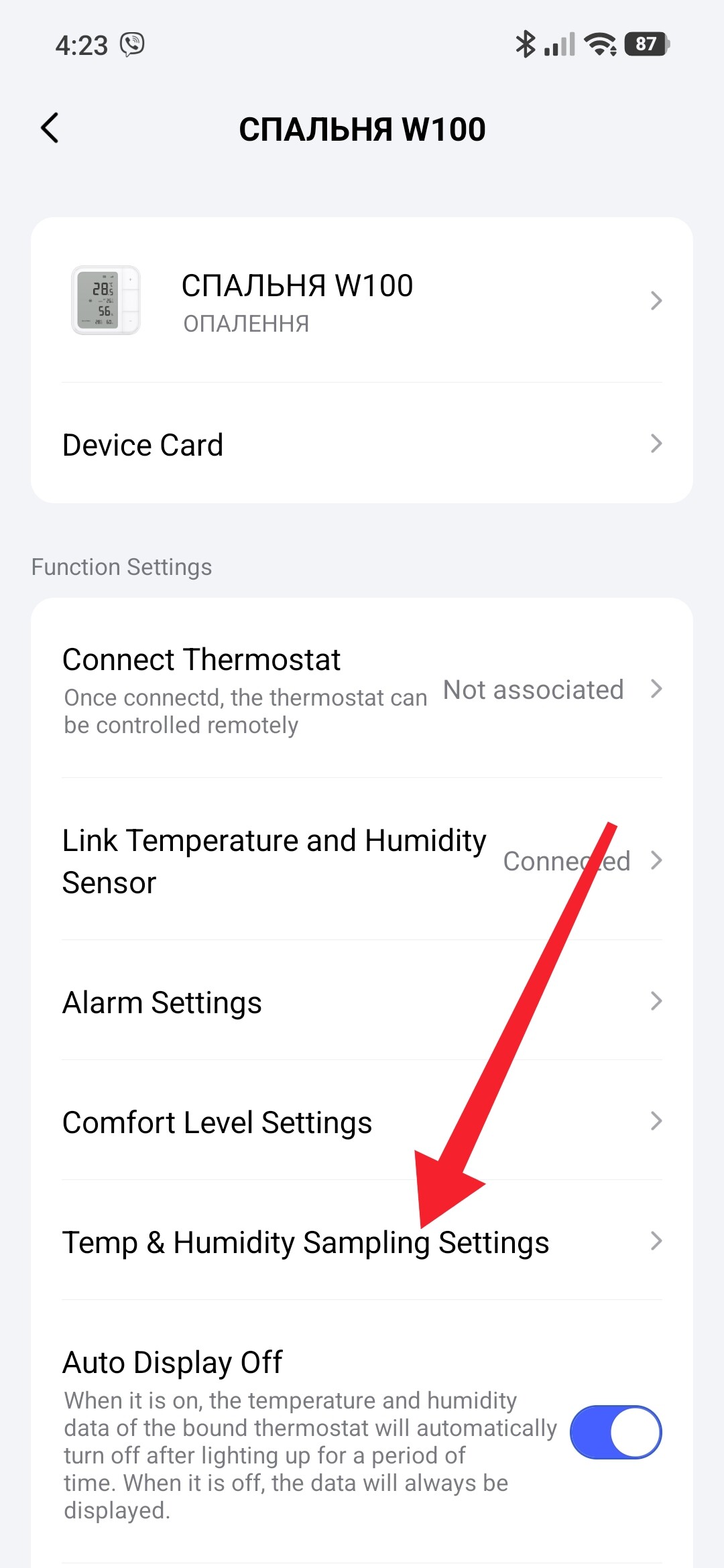

Hello, please tell me what temperature range is set on your W100 sensor? I’m asking about this W100 setting.
Standard
Select manual with a period of 10 minutes and 0.2°C.
