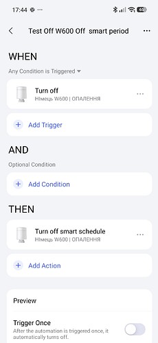

Unfortunately, it is, the system equates the switching off of the W600 valve to the category of increasing or decreasing the temperature and counts down to the next temperature period of the smart schedule. At the moment, you can make automations that will turn off the smart schedule depending on the On/Off state of the W600.
Fig.1.

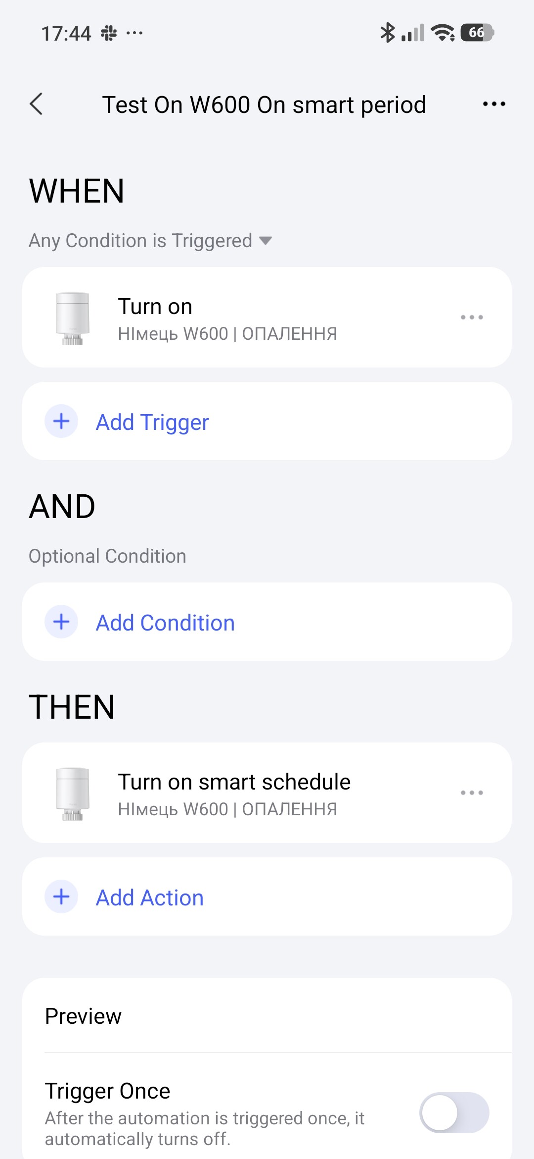

Hi, I specifically made two automations. When you turn on the W600, the smart schedule will automatically turn on.
On-On (W600+ smart schedule.)
Off-Off (W600+ smart schedule.)
